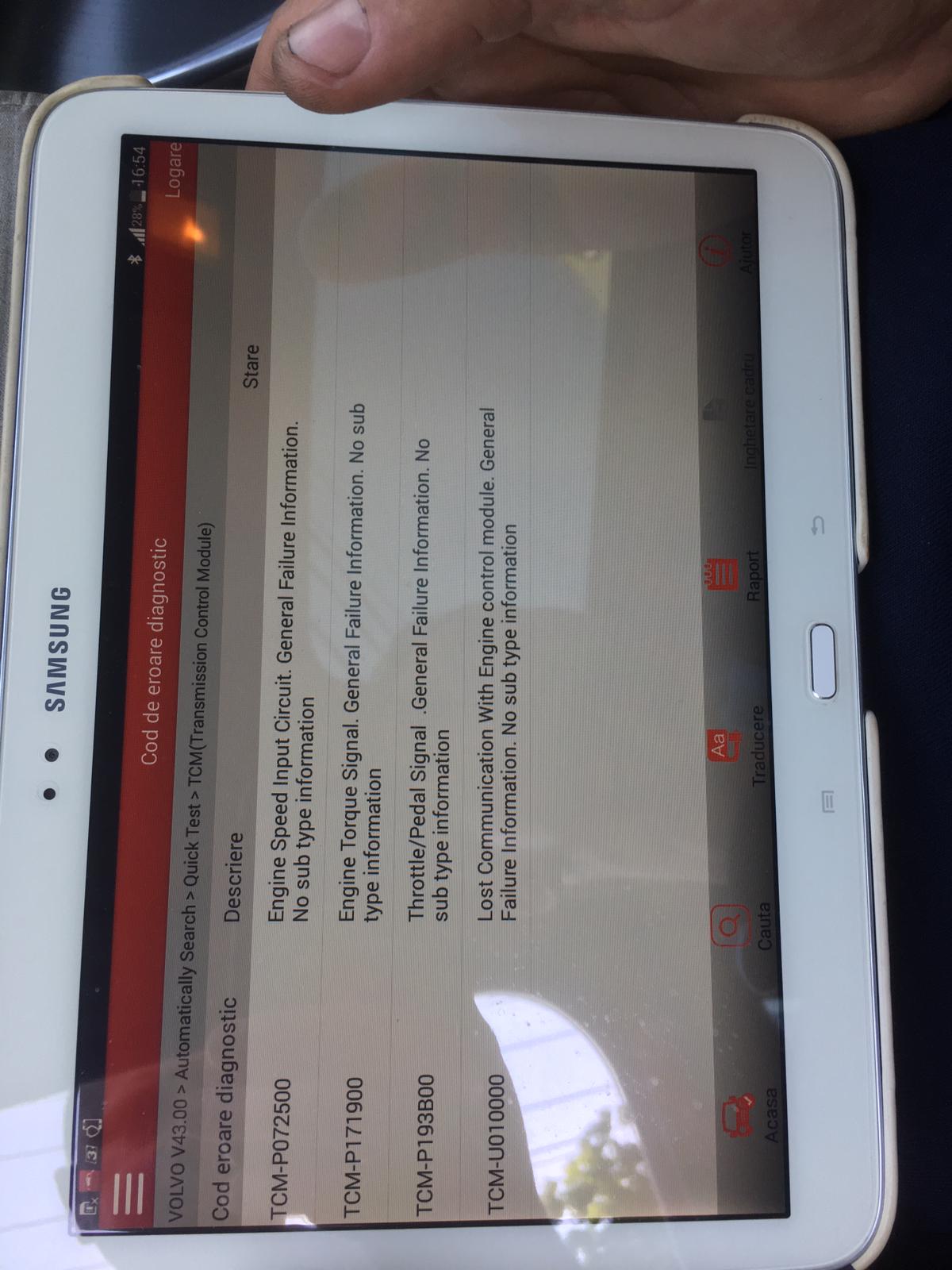

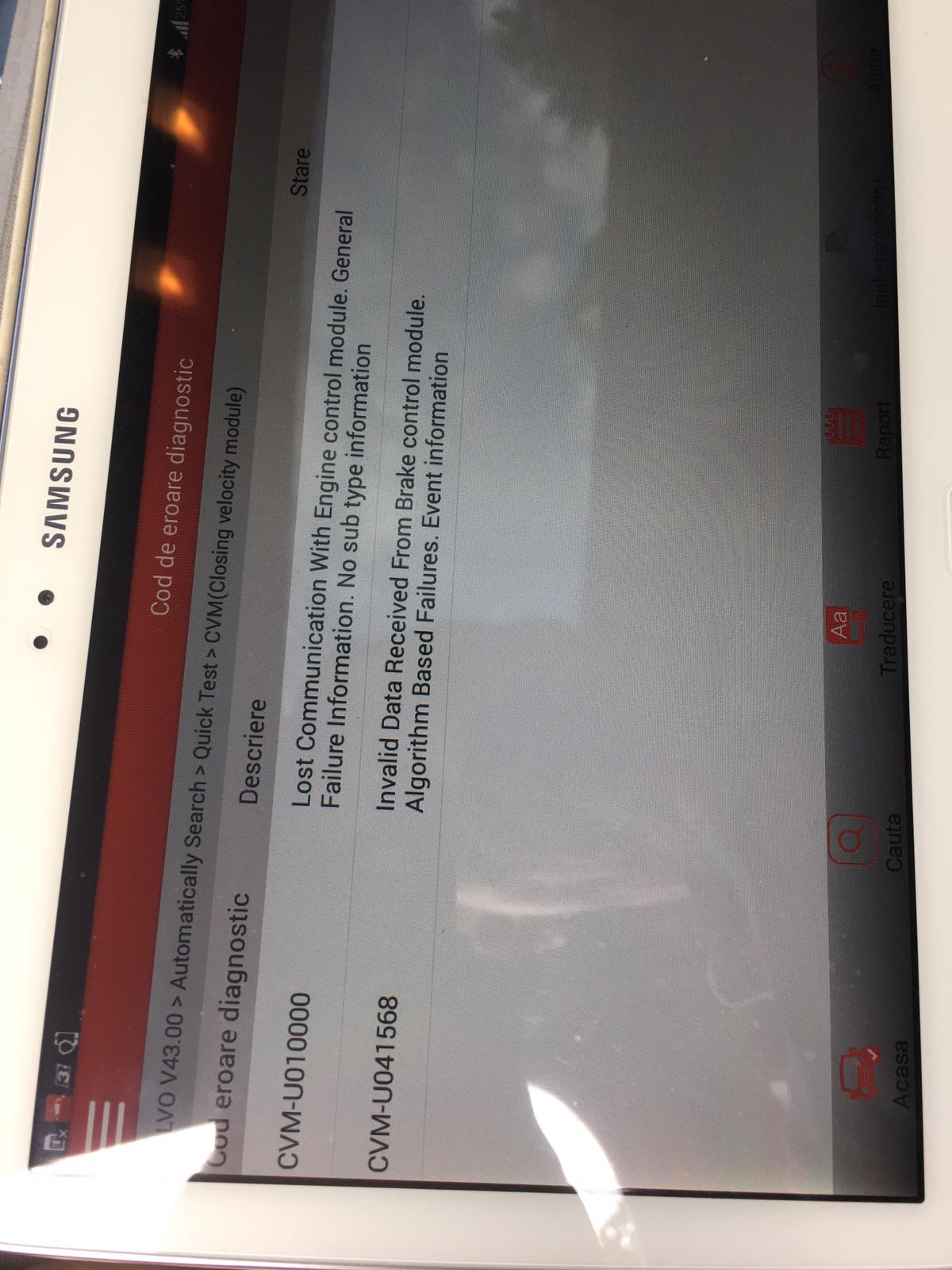

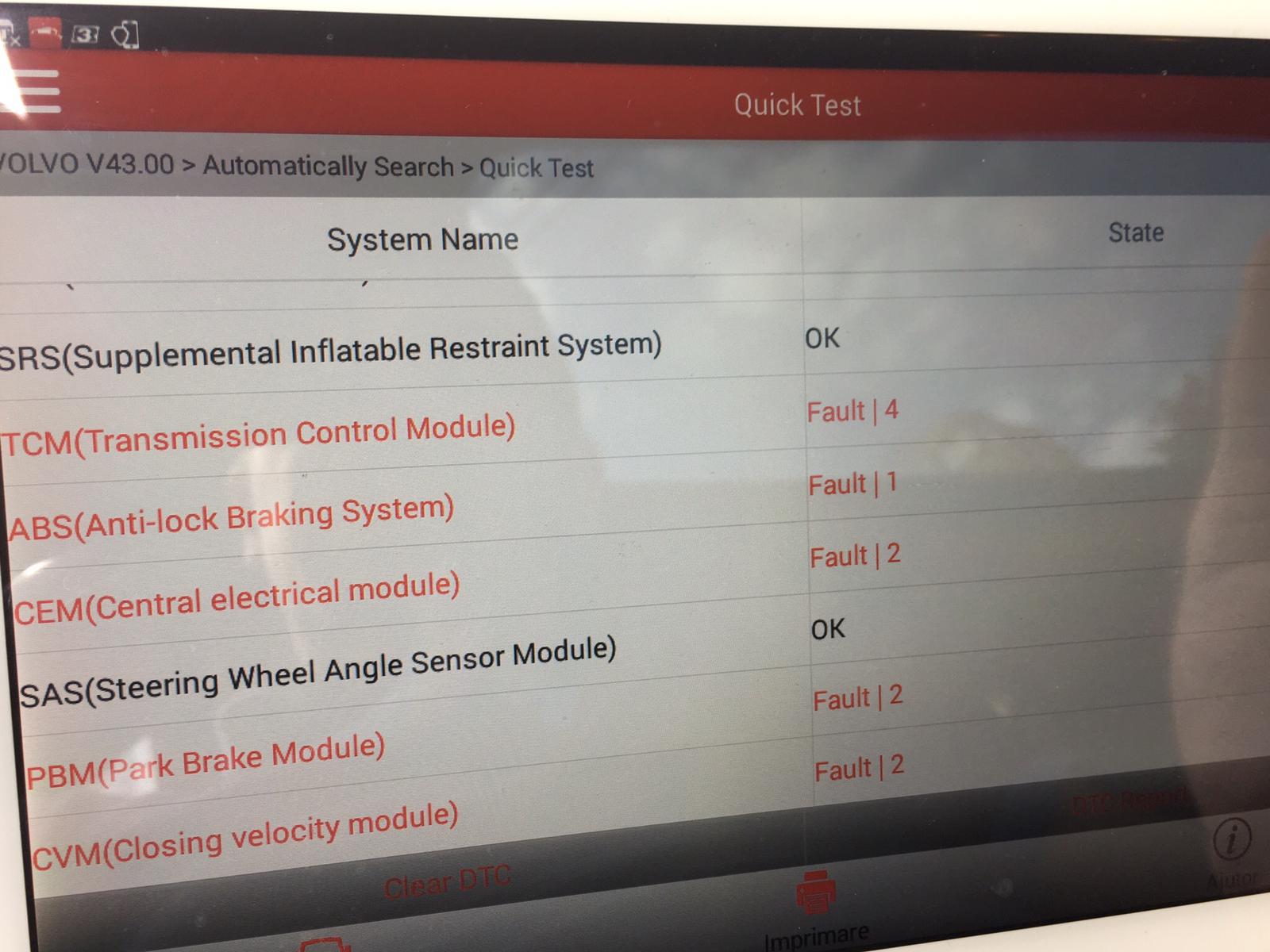

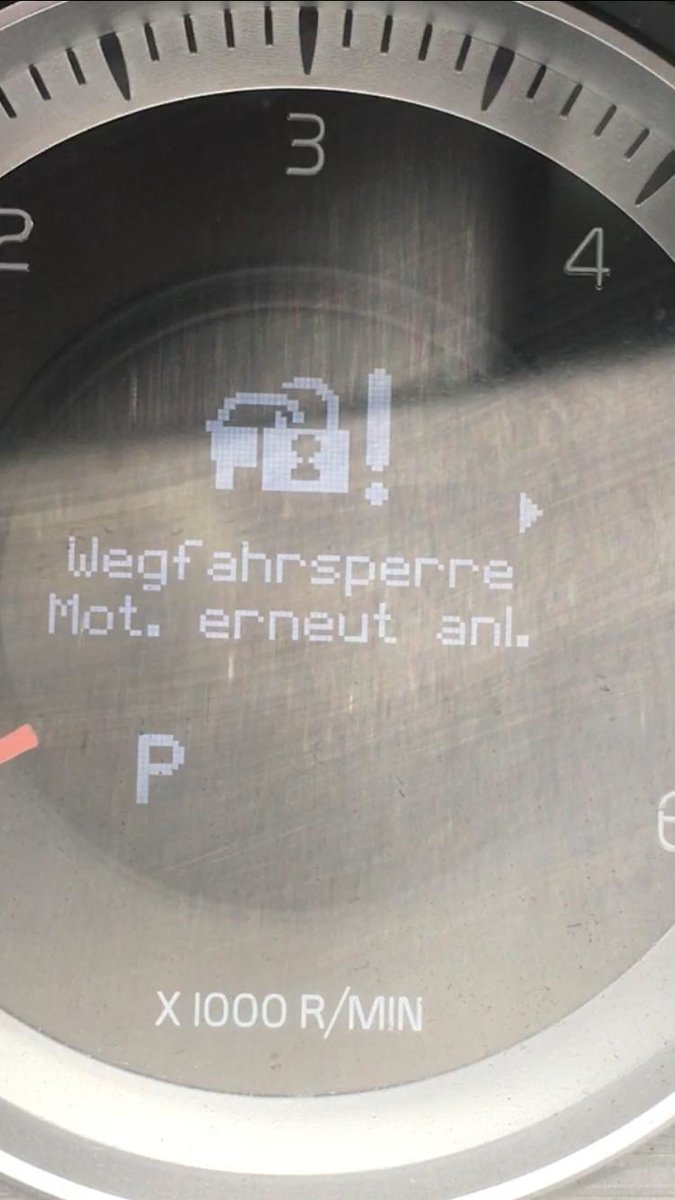

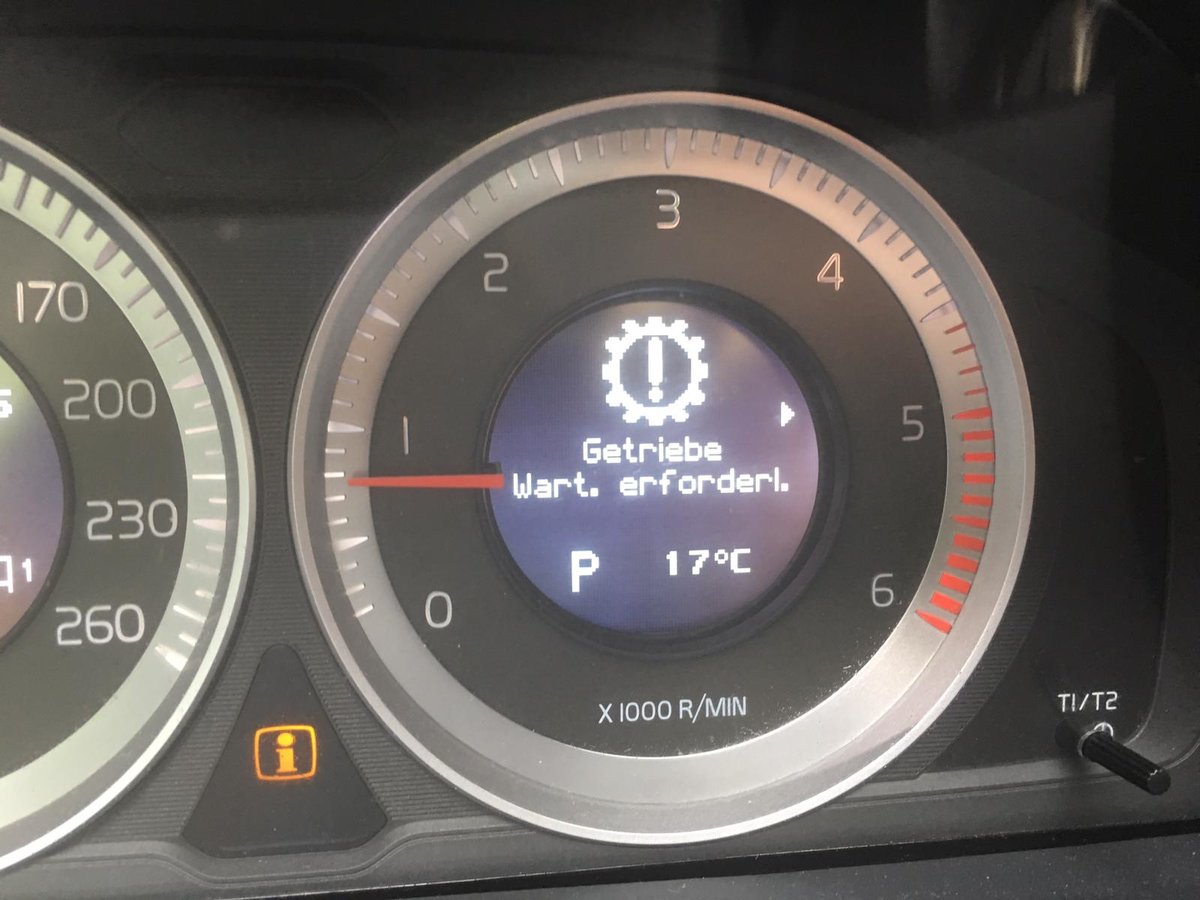

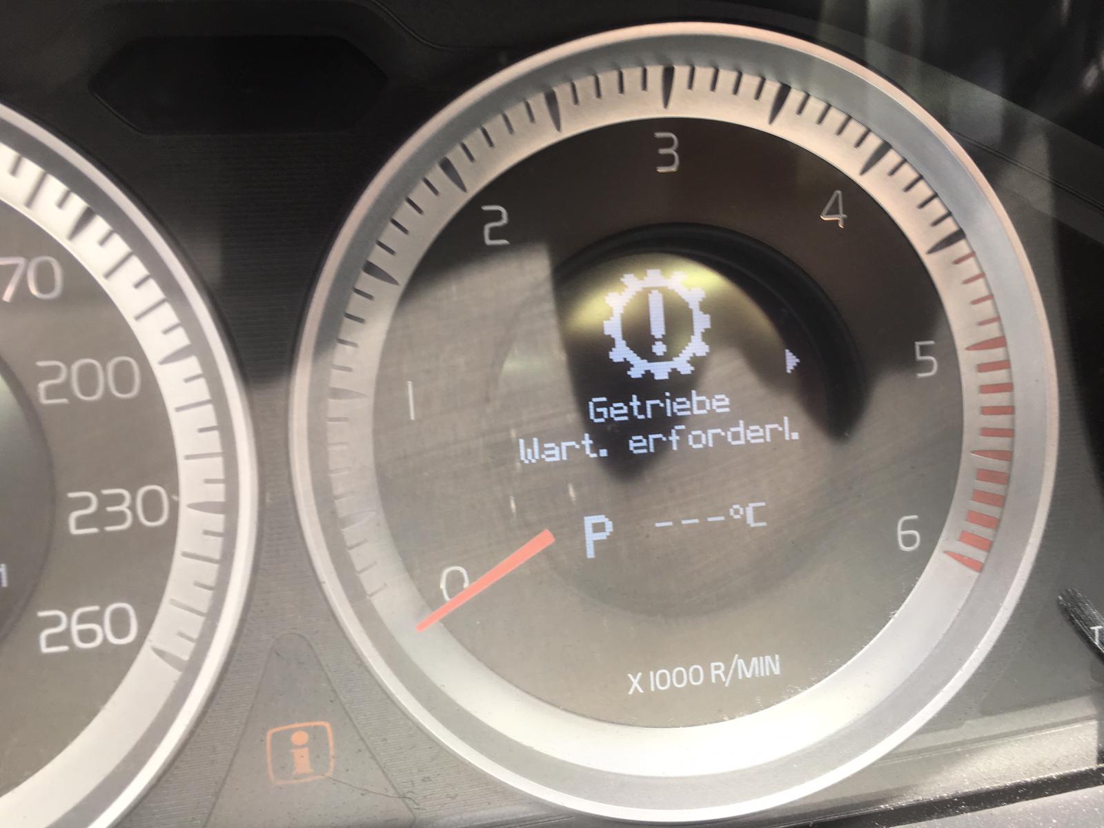

Volvo wont start

Collectively, looks like CANBUS errors. You might try cleaning the connectors and check the wiring for defects on them control modules.
The root cause might be water ingress on the CEM.
