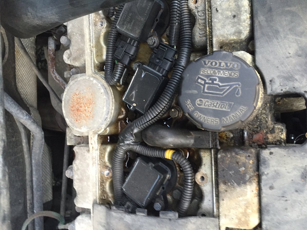

I removed the engine cover and I took a picture
Does something look abnormal out there ? I guess the oil there is because of my busted hose..
I tried to make a quick fix but its damn hard to have my hand out there and tighten a clamp. I will buy the hose wich goes there and try to install it. Removing the clamp on the oil box sounds pretty tough without removing the IM , Is it possible to do it with hands only or I need to find a way to pry it with a screwdriver ?
