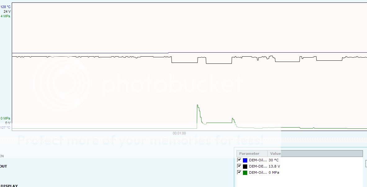

I jumped the oil pump to the battery and heard it running. With VIDA I got a pressure reading so I knew it was not the new sensor nor electrical communication with it. When I took the wire leads out of the oil pump harness connector I noticed how twisted the small harness was. After untwisting it I was able to connect it further into the DEM. I broke the tab on that connector last April.

XC70Rider wrote: 19 Jun 2019, 21:01For some reason the sensor isn't getting any pressure reading. It only reads 0Mpa. The Haldex fluid is full. I tried testing the pump with a 9V battery but got no response. Does it need 12V to turn on? The pump current is reading 2.5 to 7amps. Does that verify the pump is being activated?
Healthy motor should consume about 0.7-1.3 amps. And, yes, they all die in about 10-12 years of service. I have an old working one for free if you feel you've paid enough for Haldex diagnosis ;) Located in Ashland.

When I get home in a few hours I'll raise her up and also hook up VIDA. I can tell from driving the AWD isn't working now. If still just getting DEM-0007 then I'll check the pump wire connection and haldex level. Hopefully it's the pump connection because fixing a Haldex leak will be more of a headache.
