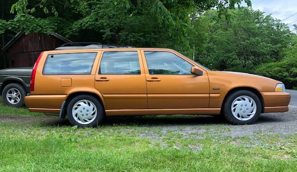

unique car. you have to move fast and throw caution to the wind when you see something like this.

That’s how they unload the trashed ones on the unsuspecting. You need a $3000-5000 budget to fix them. Or more , if you ask Neil.
Take your time,there are lots out there. It’s worth traveling out west for us anyway, if the rightcar comes up, from a corrosion perspective.

The main thing to take into account when buying these cars is that much of the rear end mechanicals are now N/A. From bushings to brakes depending on years. A 98/99 may be the slightly better options as the 00 has 1 year only rear brakes that are N/A. There was a retro fit kit Volvo had from a P2 model that could be fitted if all else failed.
Much of the rear suspension bushes are now un-available as is the lower front torque rod for all the AWD versions. IPD do a replacement rear section of the torque rod at a silly price.
Up here where there is a lot of liquid de-icer used on the roads it kills the rear sub-frame as it eats right through the aluminum where the steel mounting bolts pass through the frame. Volvo did not think to fit spacers to prevent the 2 materials reacting. Check this carefully at all the mounting bolts to the steel frame at the rear. When they get bad the frame cracks.
Buying from a dry state is good in many ways, but the downsides can be the rubber bushes are rotted out. Took me 9 months to get some from Volvo but not all were available. On Swedespeed I have seen some guys having polybushes specially made but not for general availability.
Many would say a good T-5 FWD is a better car as it is easier to maintain and without the complex AWD it is lighter and can be made to go quicker.
I wish you luck if you wish to buy one, but have the car carefully checked over if you can find someone who knows them.
