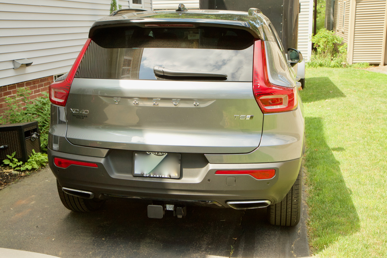

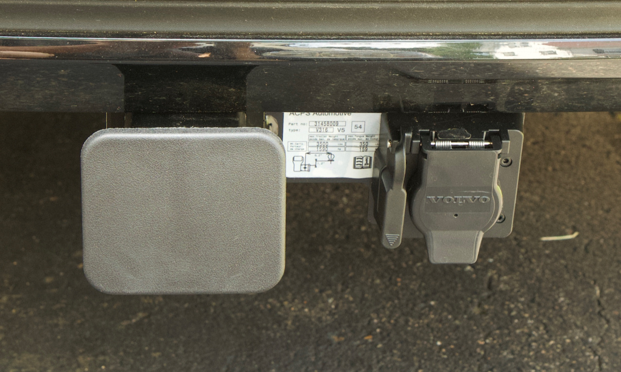

We decided the best option was to go with the Volvo hitch. Here are some pictures of the install.
Pros - High quality, fit is perfect, integrated into the Volvo computer for road control during towing.
Cons - Expensive $$$$$
