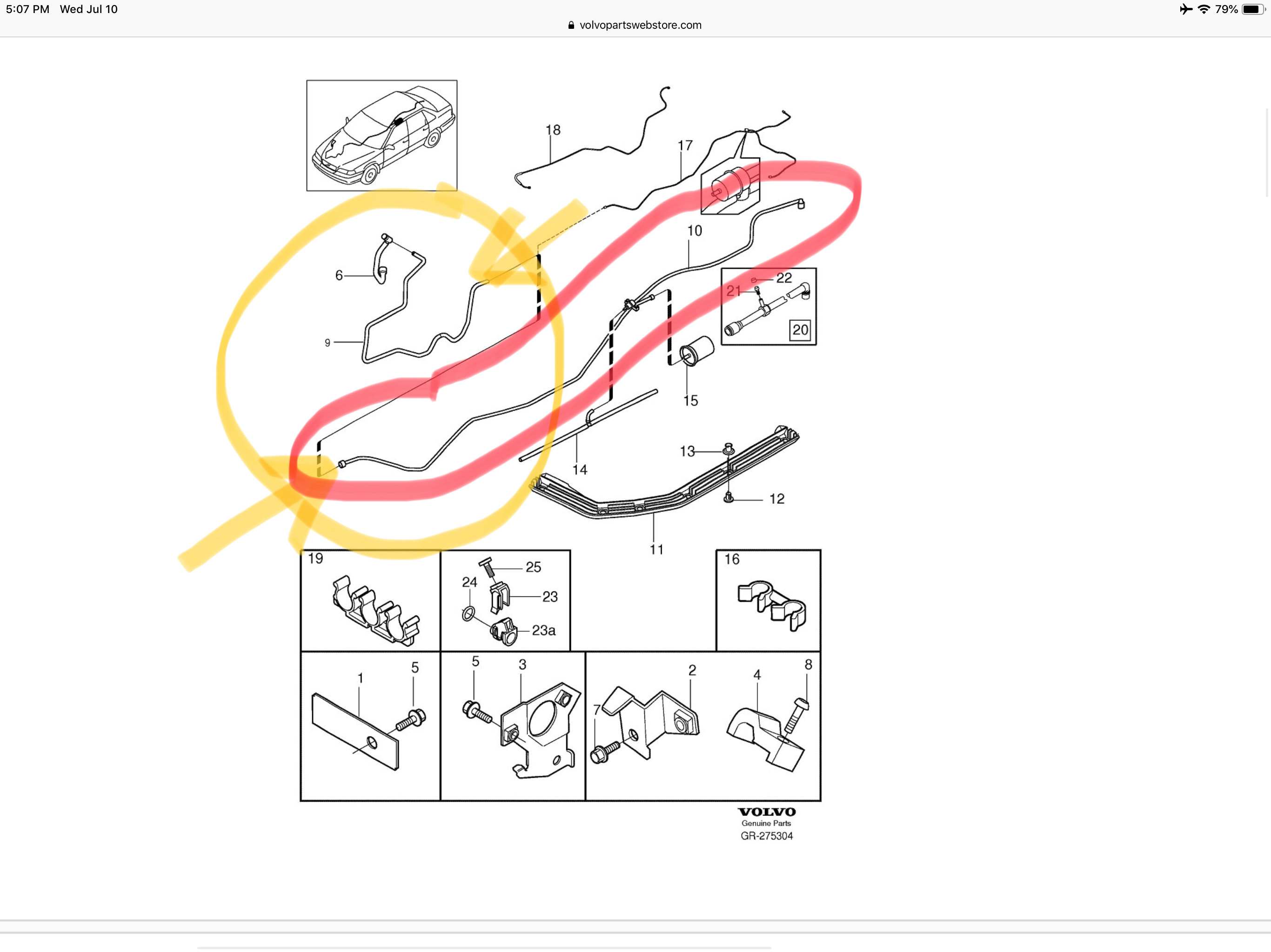

- Posts: 36142
It’s #10 in this diagram
It looks like there is a connection to the front fuel line part that might make it easier to remove and union together
