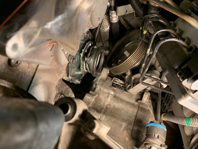

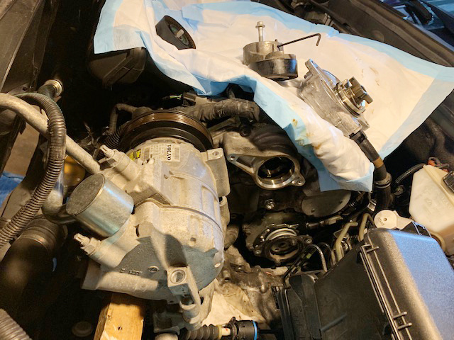

Vac pump serviced, installed and working. Now moved on to work on water pump, belt, pulley and tensioner replacement. Belt tensioner cocked, belt loosened, ps fluid line removed. Fun engine to work on relative to our V70XC.

With vac pump and tensioner removed, the ps pump takes somersault and steers out with relative ease -- imagine reversing your car from the driveway to the street, and then twisting forward toward the compressor for a lift off.
Belt shows cracks all over. Now preparing to replace and install.

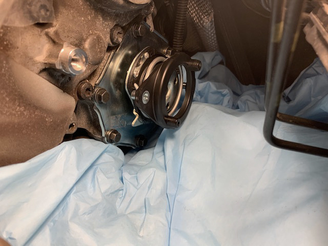

Cleared the space to install new water pump and coupling.
Now that I have done it. Rehearsing PS pump install, I say, it is possible to remove and install water pump without vacating PS pump -- just push it back as far in to the bulkhead.

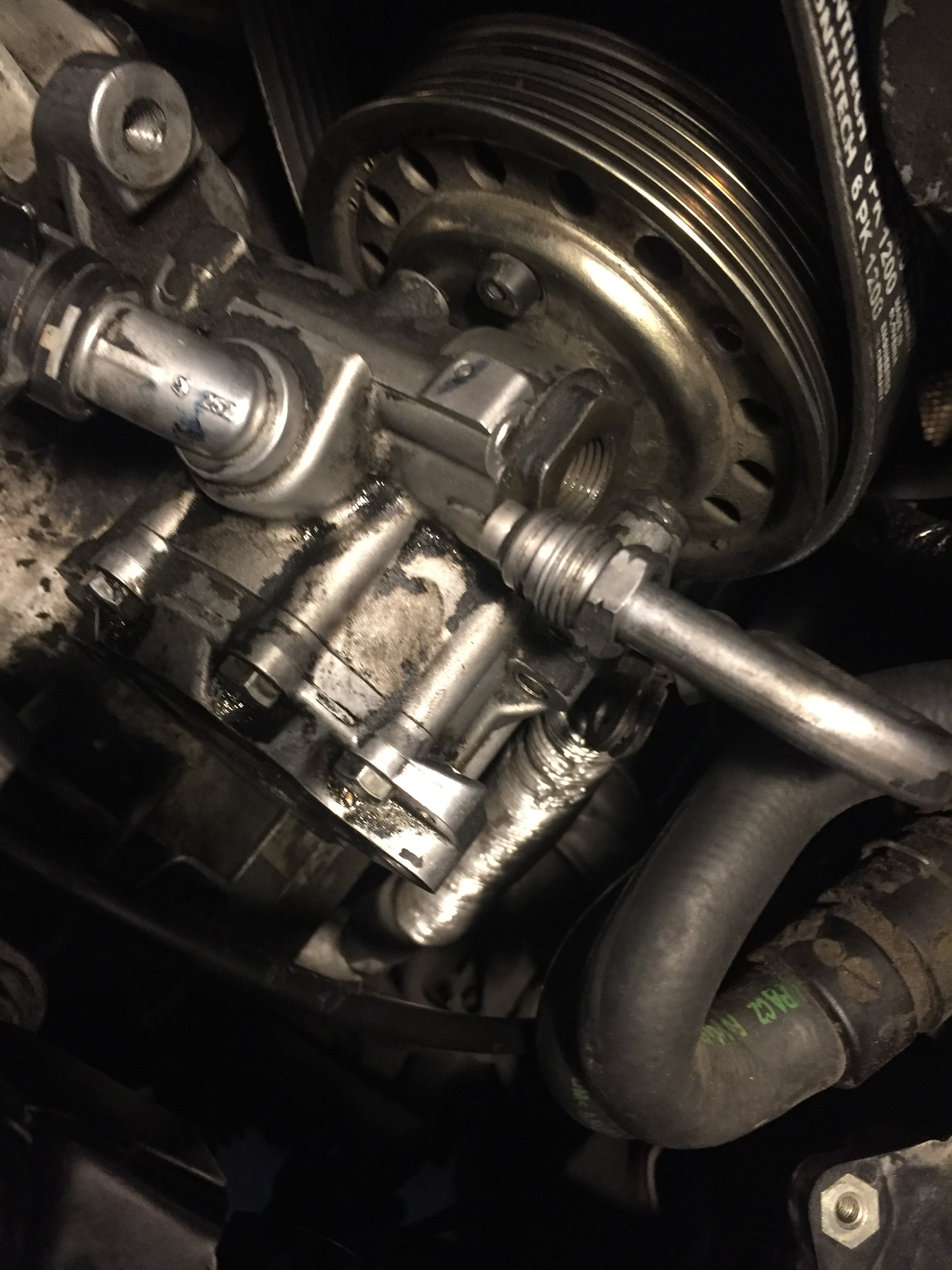

Tools from HFT for woking with two 25 torx screws at the PS pump pulley to coupler. The screw can be reached from behind the pressure hose connection -- a straight shot, pulley is rotated so screw is at 12 0'clock. It is better with black knob off the jig.
This is job takes good old dexterity working with 10mm wrenches. No space for torque tool, so go by experience.

It may just be a placebo, but the engine feels quieter. The new tensioner, belt, pulley, water pump, coupler, and rebuild BOSCH/ZF ps pump are working together with no issuse. The coolant level is now stable. Crowfoot NOT flare wrench is best for the pressure hose connection at ps pump.

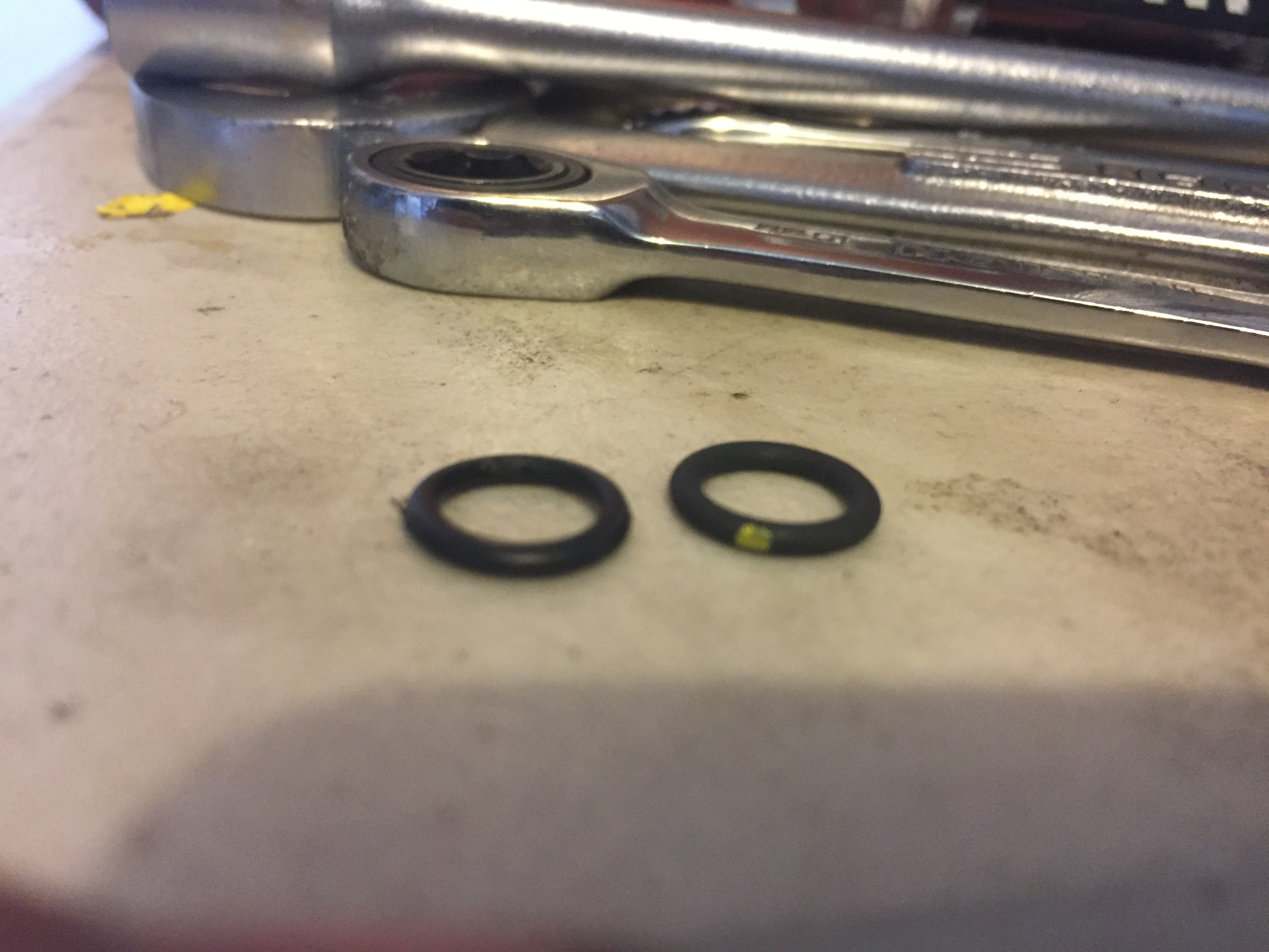

I do recommend changing the O-ring
For me I use the Land Rover part because I was already buying some Land Rover parts
LR009387 O-ring for power steering pump (Volvo Part# 31202809)
I apologize for not recommending the O-ring replacement sooner.

Pictures of the O-ring
