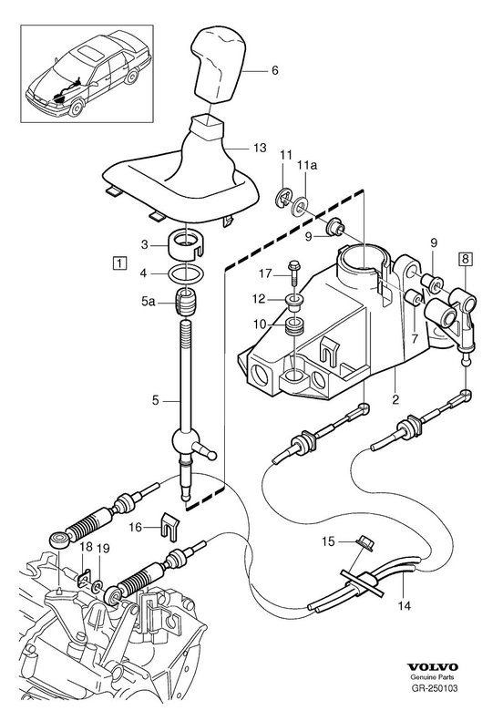

Hmm...
Looking at this diagram I don't see any retaining pins pictured. As far as I can tell the ball has to be pushed into the socket far enough for it to clip in place. No one has mentioned this being difficult in any of the M56 swap threads so I expected them to go in fairly easily.
