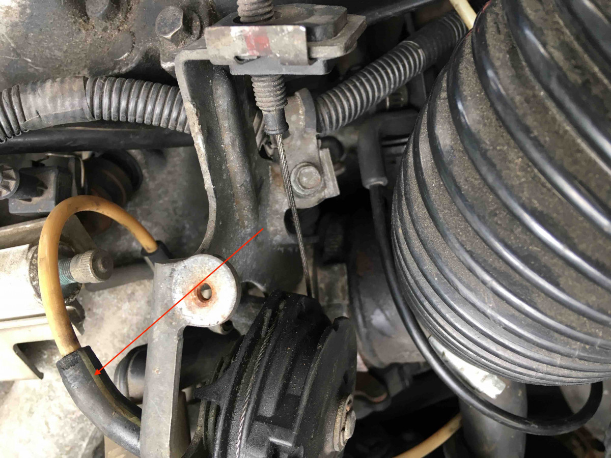

Hy buddies,
I open again the subject I've closed myself few week ago because I can't manage to rebuild my wire correctly. I mean the air wire around the fuel wire.
The engine turns correctly but I have a hose that is not plugged to anything. So I need your help.As you can see on the photo, this with -yellow small hose isn't connected. When I put my finger in it, it is aspired, the turn round looses a bit energy then re starts as normal.
May someone who may have the same engine than me (B5could post here some pictures of the differents hoses , where they are connected, where they go.. I'm the fog on this issu.

erikv11 wrote: 18 Aug 2019, 00:27 Vacuum lines: viewtopic.php?f=1&t=65002
Thanks ! Thanks ! Thanks ! Thanks ! Thanks ! Thanks ! Thanks ! Thanks ! Thanks ! Thanks ! Thanks ! Thanks ! Thanks ! Thanks ! Thanks ! Thanks ! Thanks ! Thanks ! Thanks ! Thanks ! Thanks ! Thanks ! Thanks ! Thanks ! Thanks ! Thanks ! Thanks ! Thanks !
:mrgreen:
Manov
