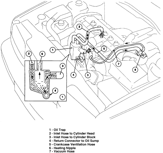

Prepping for my first real work on my 2004 XC70
Sharing and open for comments/notes and extra info.
based on FCP EURO youtube video.
Also- a possible PCV modification on one hose for high mileage engines.
(done on a 1998 Volvo S70 GL, but similar hose replacement)
viewtopic.php?f=1&t=53448
STEP BY STEP SLIDESHOW/PDF

Good luck, let me know if you have fresh notes to add after your xc90 project :)
For me visual steps slideshow works best and easier than scrolling paper notes or video while working.

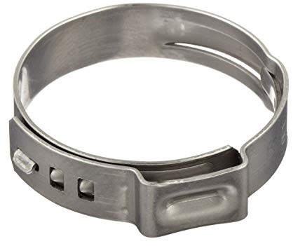

Just my 0.00002c but I really don't like those worm clamps on the PCV. When I did my PCV, I put a worm clamp - and it was actually the Volvo kind which is less prone to loosen by itself, and when I drove the car the worm clamp got slack and the PCV hose popped off. Lots of fun trying to push that hose back in place from under the intake manifold.
Really only use Oeticker clamps (the tool sells for $10 from China), and clean thoroughly the metal surface of any oils before sliding over and clamping any hose.
clamp tool.jpg (20.79 KiB) Viewed 3837 times
