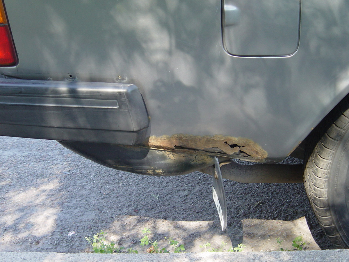

They sometimes rusted behind the rear wheels by the spare tire well, as well as the rear floors.

Ask to see the pictures before the new paint. If they don’t have any, it’s a rust bucket
New paint looks great for 6 months even with bad prep
