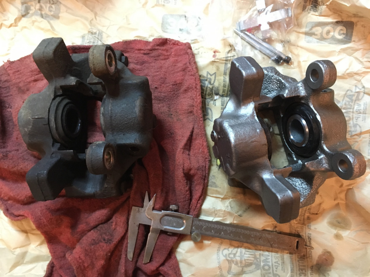

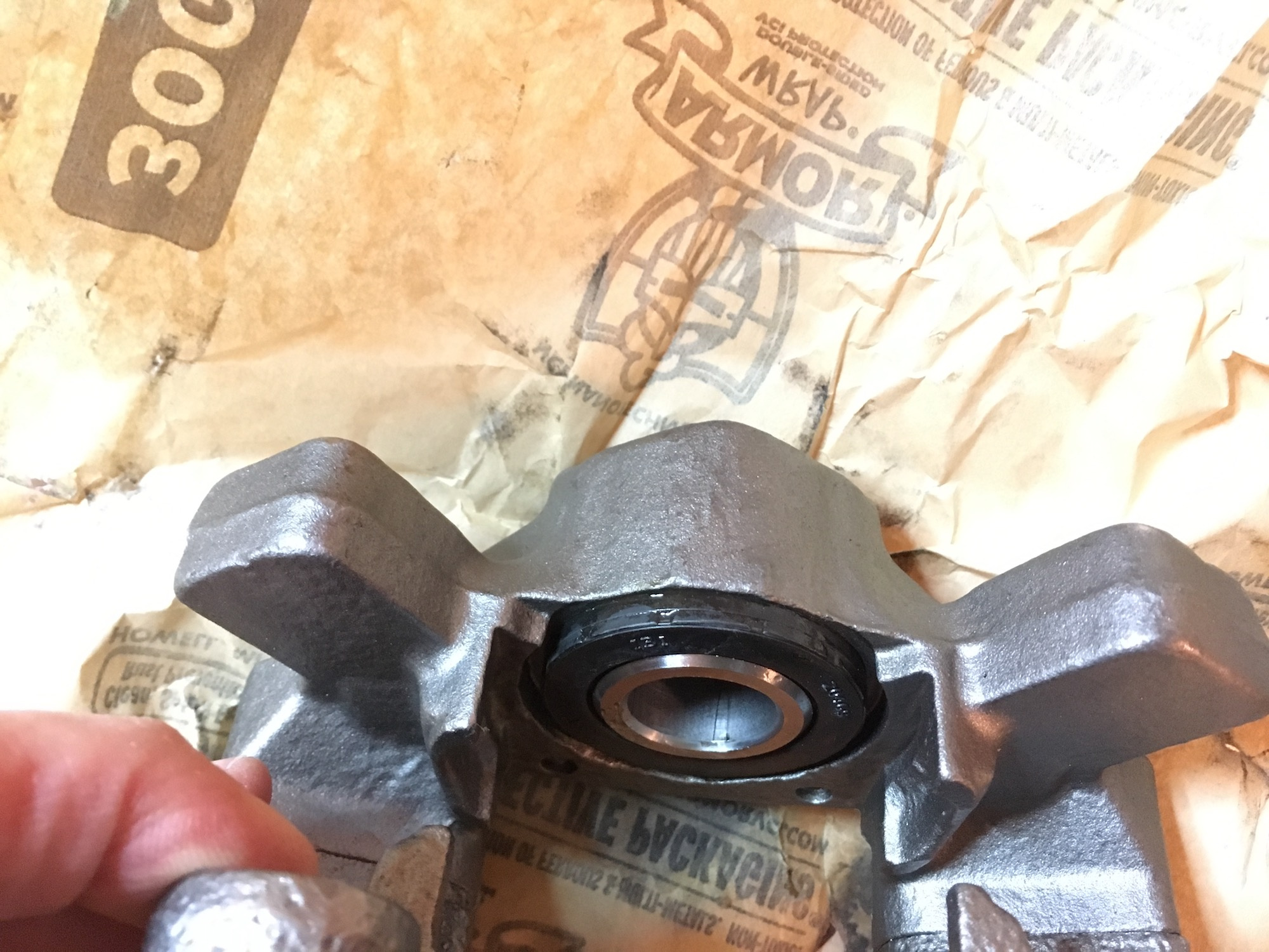

Measured my existing and the new Nugeon-built mounting holes - both measure 11mm.
Including these pics so others can see what they're getting with this choice.
Mordazas de Freno

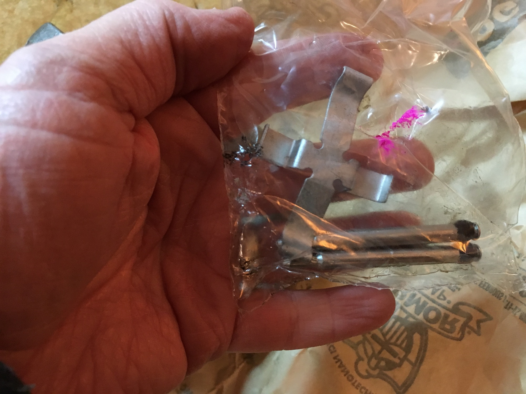

Even more hardware - I ordered too many OEM kits, and now here's another in the box - who knows what quality.

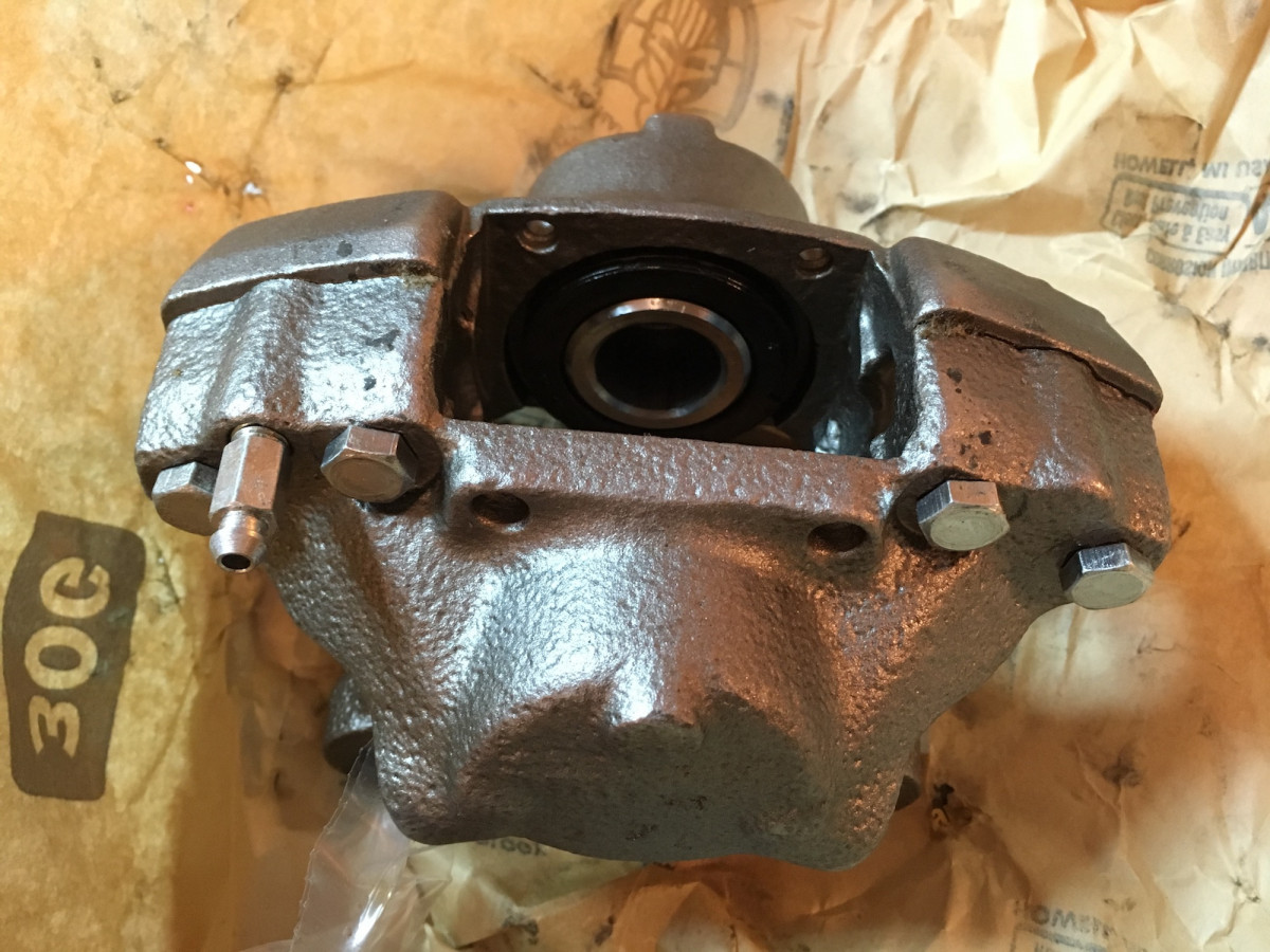

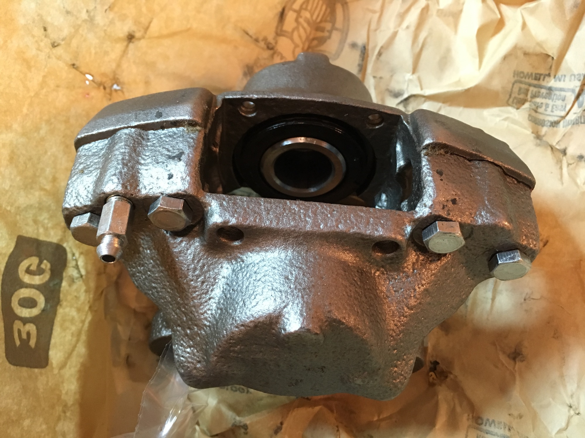

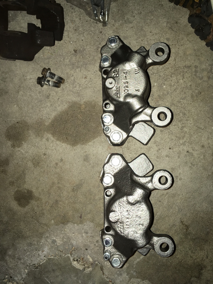

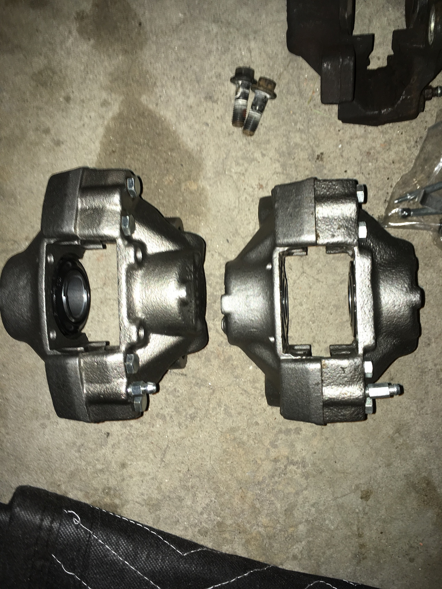

So of course they sent me two right calipers.......gawd. Another weekend gone - this should have been finished weeks ago.
Inlet port and bleeder screw should both be at the top.
Note lack of molding detail on bottom one. Makes me wonder if it was caked with rust.

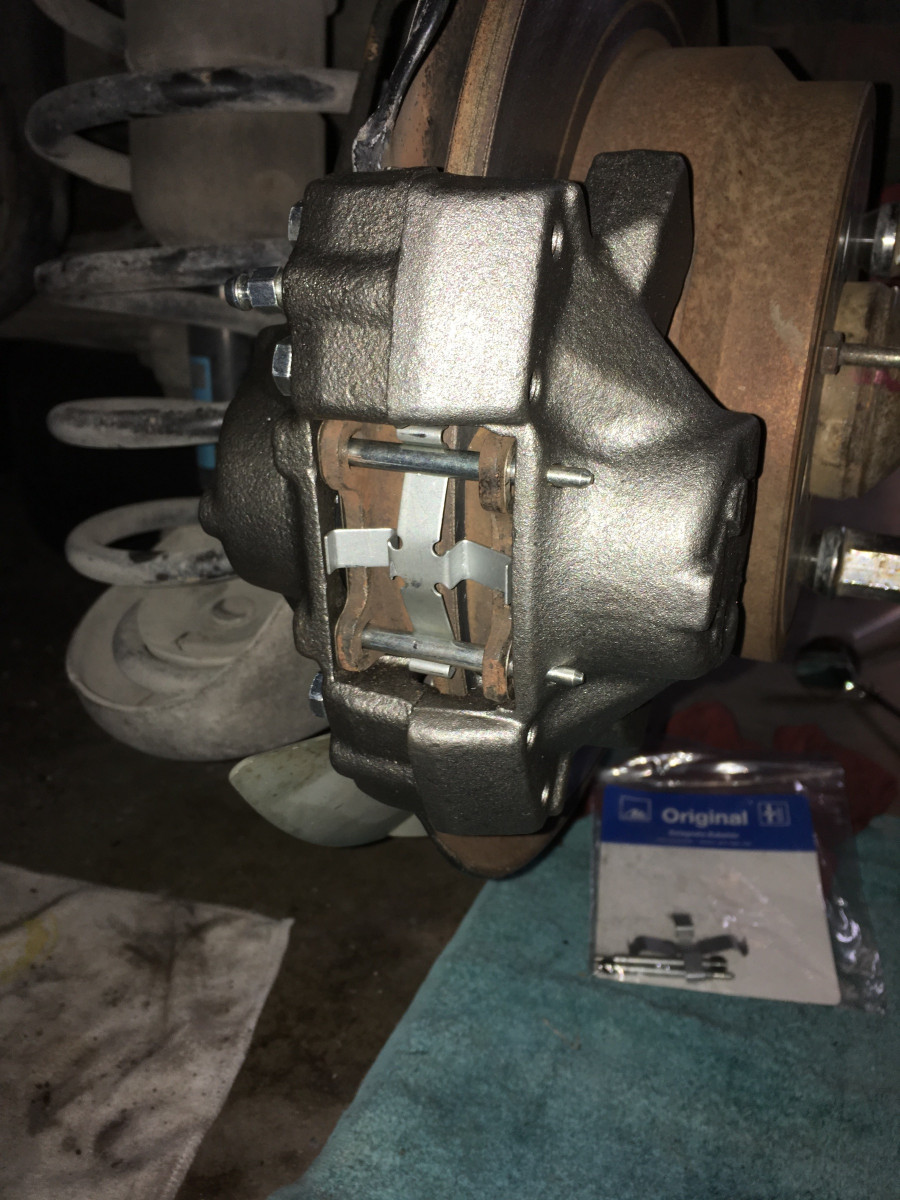

So I put the right one on, new Ate hardware.

Yep , they blast the rust off and put a nice finish on it. The important work is in the inside where the piston and seals ride, and , of course, piston and pin metal quality
