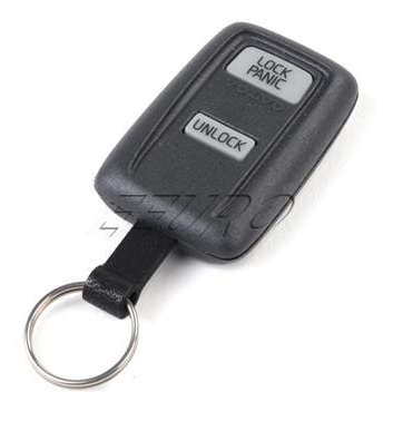

They all use the same remote which looks like this:
It is programmed to the car as follows:

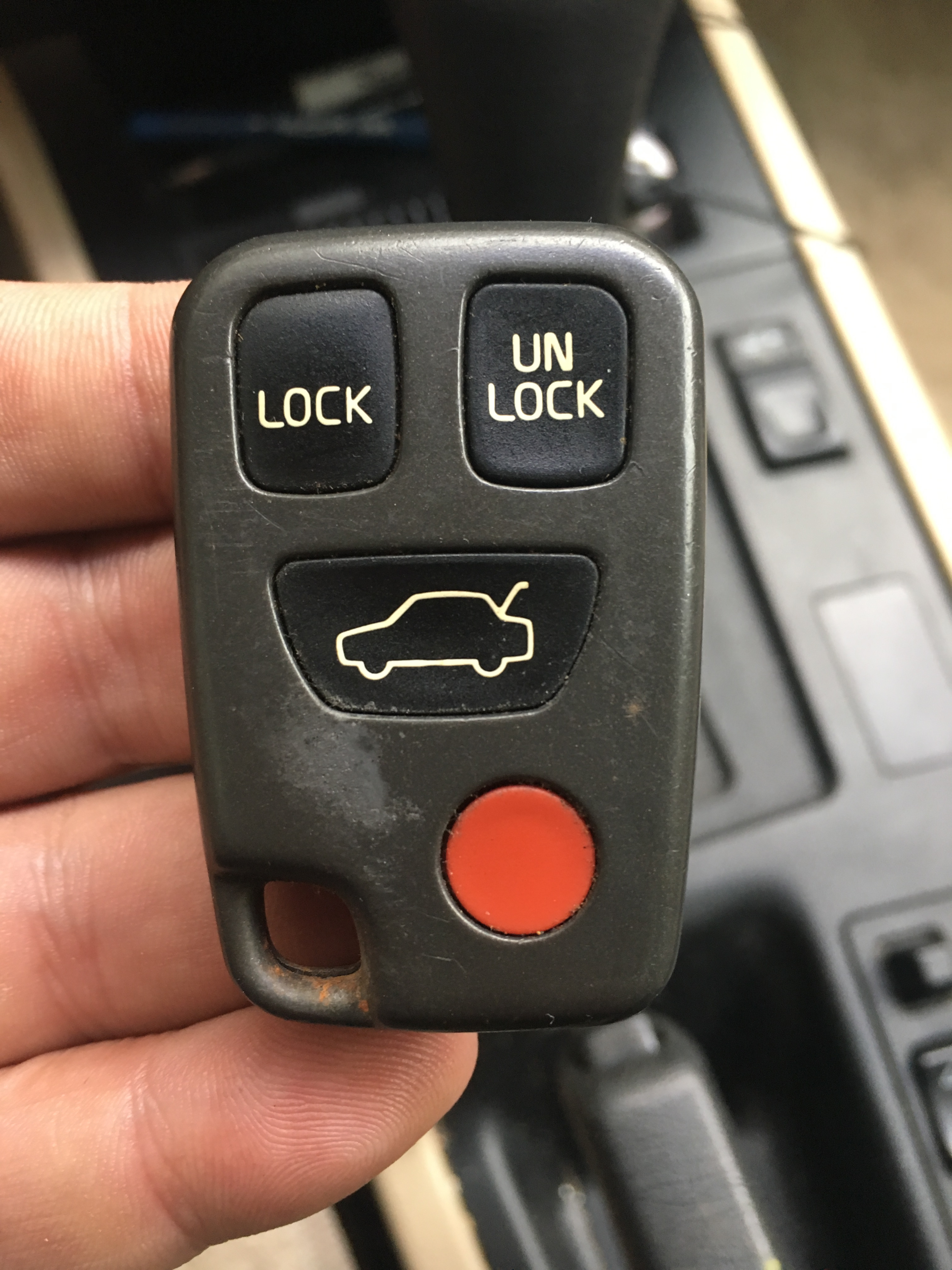

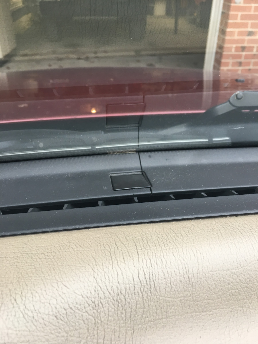

Thanks for the reply! So... I should just be able to put new batteries in this remote and program it to work with my car? If that doesn’t work, does anybody know exactly where the receiver is so I can pull it from the donor and swap it with mine? Also, neither car has the LED in center of dash and the remote is different than the one you show in the photo.
Remote looks like this and center of dash is like this in both cars.

AFAIK that remote is for 1998 and later cars only. Check the fitment tab in this IPD listing:

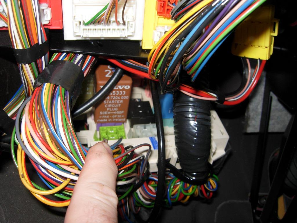

I did not have the black box receiver behind the glovebox. Removed the screws under the driver’s side dash and removed the lower dash panel. Looking up under the dash I only had the brown 210 module.
Brown 210 module
Brown 210 module

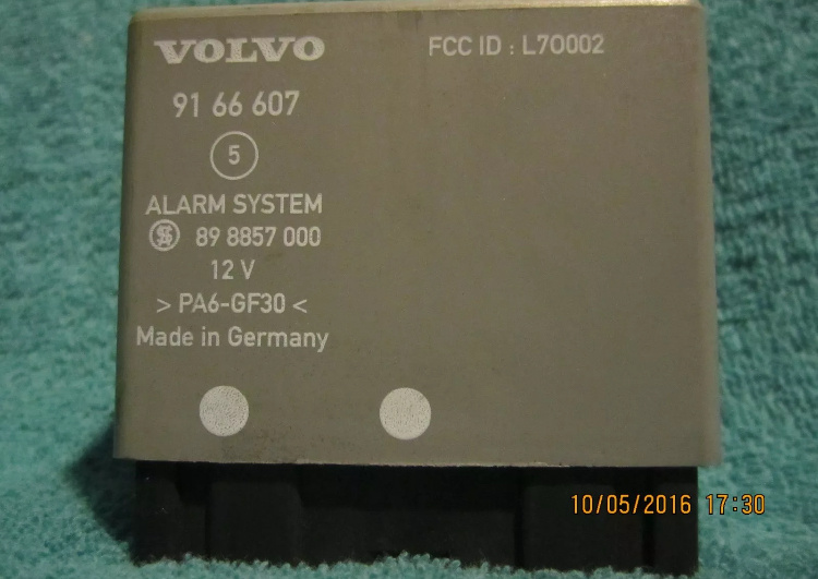

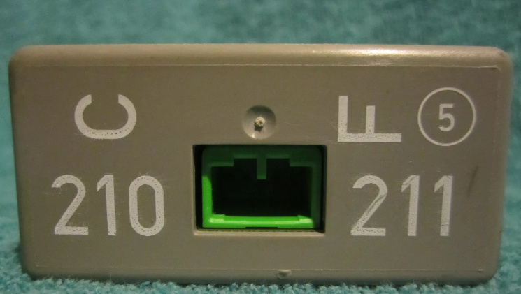

Found a gray 210/211 module 9166607 on eBay for $25.
Gray 210/211
Gray 210/211
Gray 210/211
Gray 210/211
Removed the 210 and replaced with the 210/211. Was slightly tricky because of the bundle of wires in the way but was doable if you work the module behind the wires first then line it up and push it in place. The 210/211 module uses the same space as the 210 and an additional space to the right of it.
Gray 210/211
Gray 210/211
