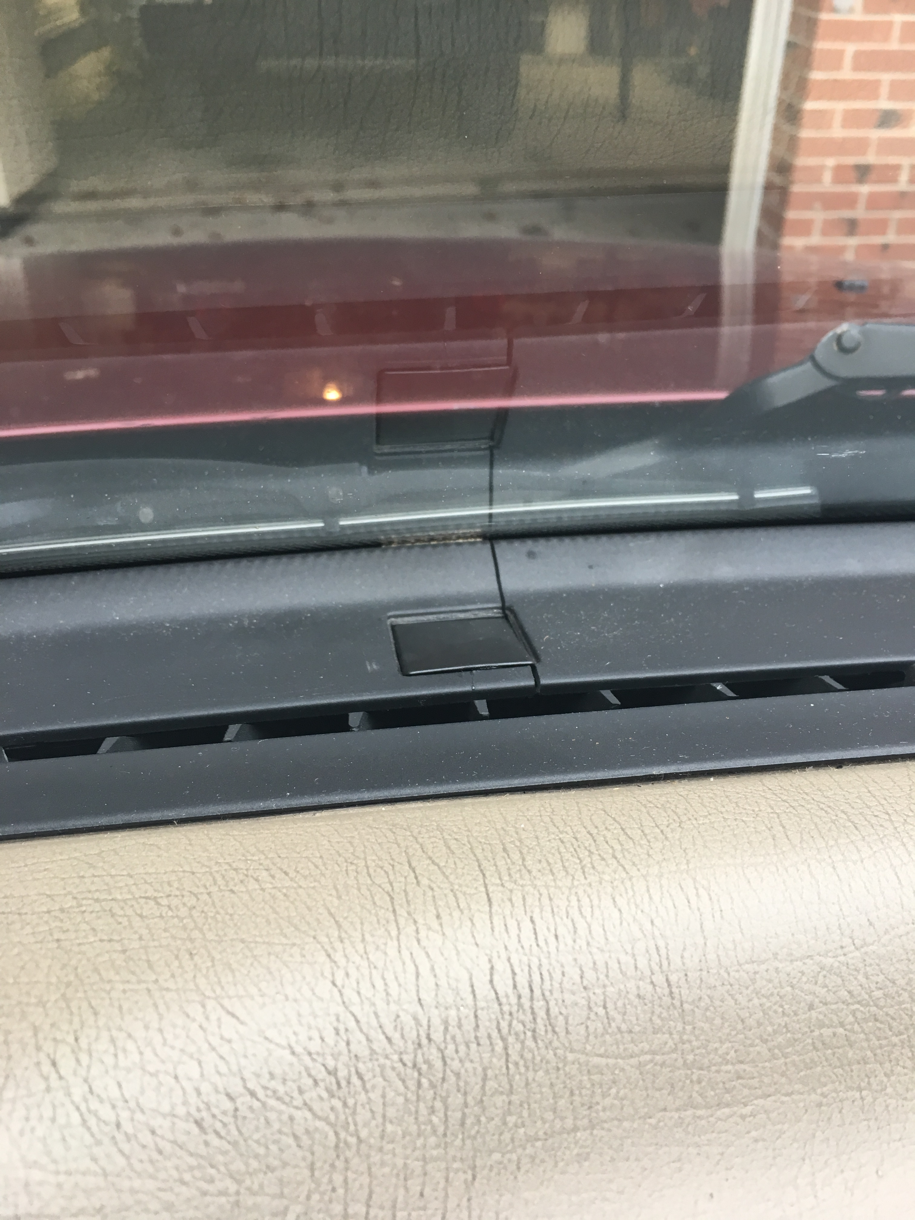

Remote looks like this and center of dash is like this in both cars.

Didn’t give up on this and got the keyless entry to work on the ‘96 850 GLT.
Found some helpful info here and used a couple of his photos for this post:
https://volvo850wagon.wordpress.com/201 ... ry-part-1/
I did not have the black box receiver behind the glovebox. Removed the screws under the driver’s side dash and removed the lower dash panel. Looking up under the dash I only had the brown 210 module. Found a gray 210/211 module 9166607 on eBay for $25. Removed the 210 and replaced with the 210/211. Was slightly tricky because of the bundle of wires in the way but was doable if you work the module behind the wires first then line it up and push it in place. The 210/211 module uses the same space as the 210 and an additional space to the right of it.
Found the FOB 9442982 also on eBay for just under $30.
Did the programming routine again by locking all doors then turning the key from I to II five times leaving it on II the fifth time. Press the lock button then turn the key back and removed it. At first it didn’t work because I found out the remote I had purchased needed new batteries. Replaced batteries and did the routine again. This time when pressing the lock button I heard the door locks click. Turned key off and removed and pressed lock and unlock buttons and everything works. No horn beep but parking lights do flash. If you hold down the lock button for three seconds the parking lights continuously flash until the unlock button is pressed or for a certain amount of time when they will turn off by themselves. Again, no horn beep alarm with this setup but that’s ok. Just happy I don’t need to use the key anymore to lock and unlock the doors.
Hope this helps someone else.
