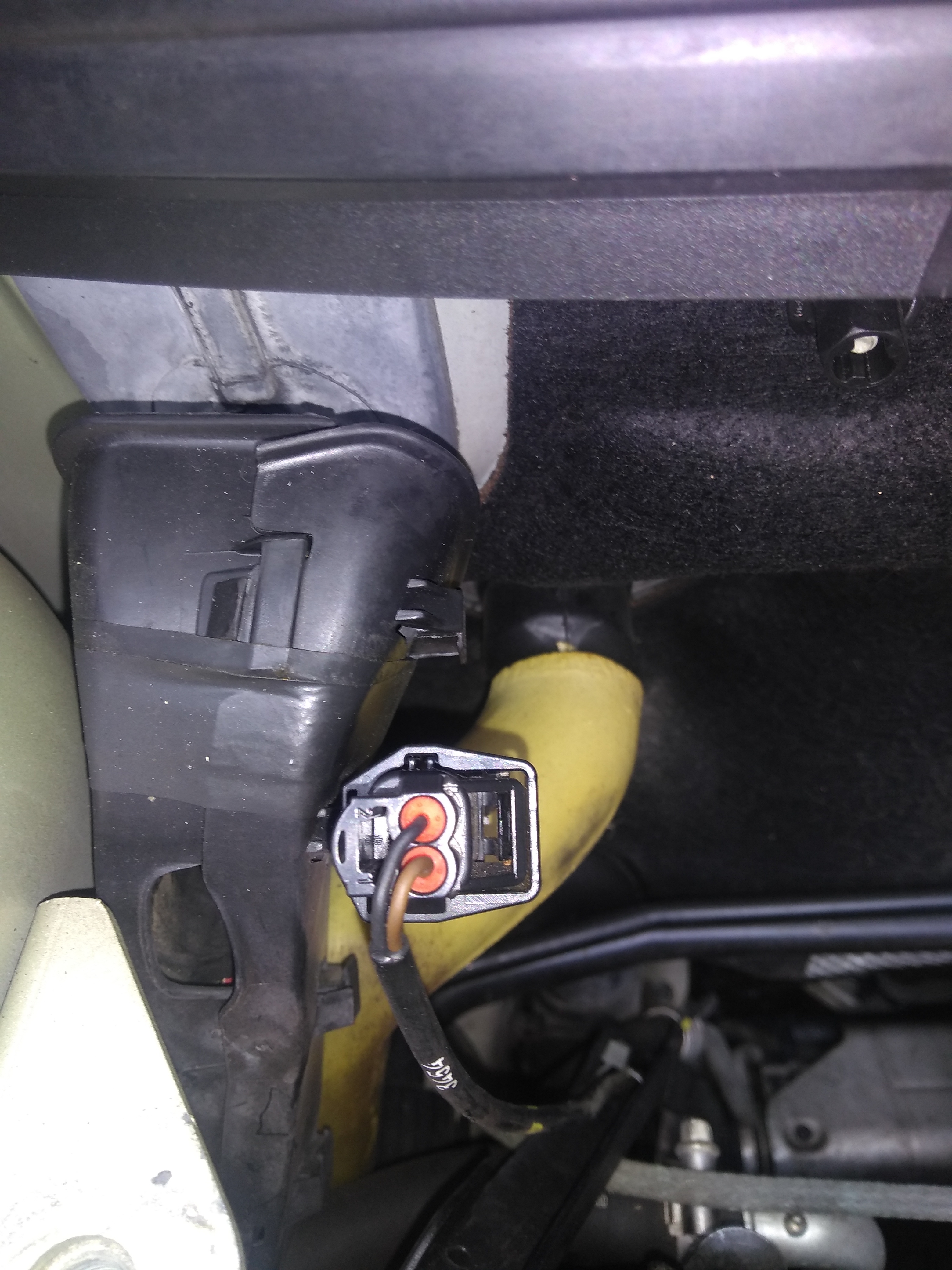

The second I found only after relocating the radiator overflow and power steering reservoir so that I could do the timing belt. It is a picture of an electrical connection on the passenger side on the firewall. There is an unattached plastic piece that didn't make it into the picture but its about a foot long and must cover the connection. What is this so I can look up the part numbers.

The connector looks like one that usually is released when taking out the engine brace, at least on my XC90 2.9T. It just clips in - to keep it out of the way. What I am seeing is electrical tape keeping the loom protector together. Going down the connector wiring is a plastic shield, at least on my XC90, that protects the wiring. That is what I am seeing in the picture. I would just look at it and figure out a way you can keep it secured from any movement, vibration rub, and heat. On the XC90 the plastic has a tab that clips in loosely to the engine brace bar area - it looks to be the same piece.
I am not sure you are missing anything as the top of the plastic is not in the picture. You need to get someone to take a photo of their plastic shield and how it is fitted. If you are missing a piece or it is broken I would source from a junked car.
