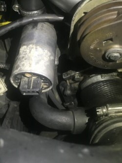

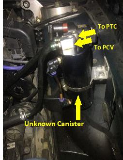

I recently purchased a Volvo 850 turbo wagon and it has been modified with some aftermarket stuff that I'm not sure about. I am going to be doing the PCV replacement and as I was familiarizing myself with the engine I noticed a few things. The PCV hose that typically goes to the PTC instead runs to some type of canister and then from the cansister another hose goes to the PTC. I've included some pictures to help with identifying this. Does anybody know what it is or why someone would've installed it? It also has the boost control, but I have a pretty good idea what that is. Another odd thing is that the idle control valve is disconnected and I can't find the wiring and connector that should be connected. The car seems to idle and runs normally. Is there any type of modification or aftermarket part that requires disconnecting the Idle control valve? I've included pictures for the items in question and I appreciate any insight you guys can give. Thanks.

A catch can to catch the blow-by that will condense and stay in that can until it overflows or you dump it- it's an old trick to keep from having to deal with the PCV- of course in many states with inspections, the emissions standards are such that a can like that would be illegal. The IAC is strange. I don't know a way to eliminate that and it's important to keep you idling correctly when the car isn't moving, so that's a huge mystery. Hopefully others can chime in who might know about these things.

Thanks for the help, I really appreciate the response. Since I am doing the PCV replacement, would you recommend routing the hoses back to original or leaving it connected to the can? I'm more concerned with reliability than I am about meeting emission/inspection standards, although that's good to know.

Based on how the hoses are hooked up to the PTC, it seems like the PCV system is probably in need of replacement, and the previous owner considered adding in a catch can an easier replacement than just fixing it properly. If you're planning to replace the PCV system, you're probably good to remove the catch can.
Check the cable end on the throttle to see if it's been shimmed or adjusted to set the idle.

That catch can is totally fine the way it is hooked up. Its main purpose is to catch moisture. If you use this car for short drives in the winter then I would leave it on, and just remember to empty it out, it will fill with a mostly-water mixture. It is not a PCV replacement, it is an extra. The PCV still needs to be free flowing, the PTC needs to be open, etc. You will find that water accumulates quickly in the winter but slowly in the summer.
The catch can is a fairly common add-on, but bypassing the IAC is not. That's a puzzler, makes me want to see what other surprises are in your engine bay! (is there an ETM?
I'm going to guess that the IAC is broken and somehow the previous owner figured out how to keep it running without an IAC. I like the idea to see of the throttle cable is shimmed. How many RPM does it show at idle? Perhaps when you find the connector and plug it in, the car will stumble or something. Be prepared to grab another IAC from the junkyard; if you don't have a cheap pick-n-pull nearby let us know I'm sure we can find you an IAC.
