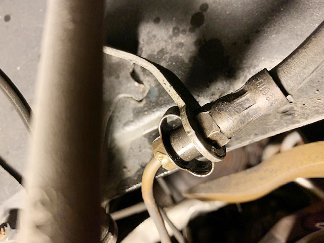

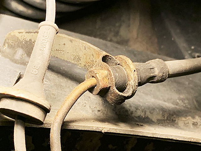

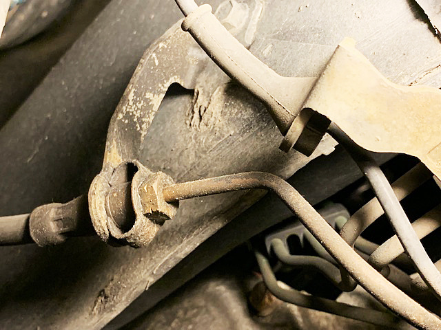

The rebuilt calipers arrived. A first look at the two front wheel connections to scope out the challenge:

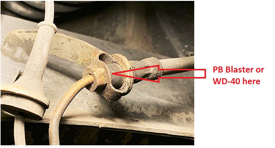

Study the anatomy of brake line.
The bolt pulls the flared end down into the fitting (the fitting is part of the hose).
So when you spray PB Blaster or WD-40, spray it exactly at the junction of the bolt and the fitting.
This way the fluid gets down to the fitting threads.
I have repaired many brake lines over the years.
As long as you spray PB Blaster etc. one week ahead of time, the bolt should come out easily.

I have a pair of ATE hose with matching part number.
Brush cleaned the connection and treated with PB blaster - day 1, here is a pix:

One tip I can give is that hose nut does not turn when loosening the connection. Hold it with 14mm and turn the brake tube nut with 13mm.
Somehow the 14mm hose nut is indexed into the bracket so it will not turn until the connection is fully loosened.
Looks like your car have had brake hose replaced some time ago based on the rounded fasteners shown in the photo.

Good catch!Tonyx wrote: 23 Oct 2019, 06:56 One tip I can give is that hose nut does not turn when loosening the connection. Hold it with 14mm and turn the brake tube nut with 13mm.
It was me, tried to do this service few years ago, but failed. Feeling better prepared now to try it again.
