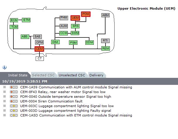

Post by Oka »
Ooopsy! Guess I spoke too soon.
This morning neither the remote starter nor the key would start the car.
Here are some faults and an audio of the starting sound.
https://drive.google.com/open?id=1Gqvzo ... DuGjaSfOJi
Just curious, both the OEM security system and the Viper Remote Starter security systems all are functional at the moment.
I have been enjoying the nice and very responsive ride since replacing the throttle device, need to get back to it as soon as possible.
Thanks in advance.

Post by Oka »
https://drive.google.com/file/d/1Gqvzor ... sp=sharing
Thanks in advance.

Post by Oka »
While waiting to get the Ambient and Coolant Temperature sensors to arrive, I just tried to start the car and on the dash, it shows:
IMMOBILIZER
SEE MANUAL
Oka
