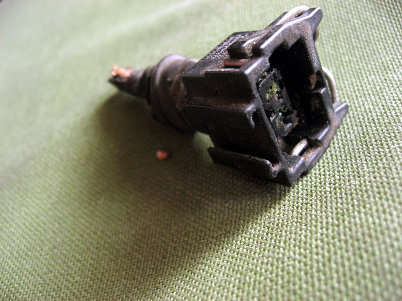

I was expecting to find a bunch of corrosion, but I found that both wires to the knock sensor had been severed. I could cobble something together with butt splices, but the wire stubs are pretty short to work with. Does anybody know where I could buy a new connector or a pigtail? I know it's a "junior power timer" connector. It's Volvo branded and the numbers don't turn up anything.

Rodent Attack!
The wiring harness is Volvo Part number 9442158. They can still be found.
There is a "upgrade" with the knock sensors integrated with the harness as one unit. It will cost you at least three times as much, Volvo part number 1270492.

Thanks, Rick! I've got one of those harnesses on the way. It was probably a squirrel. They're bad around here. I hope I can get it installed without lifting the intake manifold.
Your VIN decoding matches what I found. Hopefully one of the mods will take pity on me and update this thread title so I look less dumb... at least *slightly* less dumb!
Also, if somebody has a source or a part number for that connector by itself I'd love to have a few spares on hand. There are quite a few on this car.
