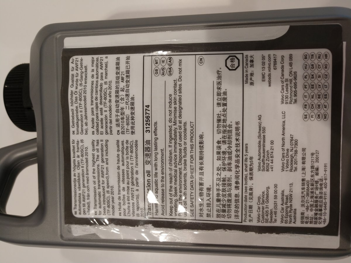

So, update, I went to the dealership as I was nearby and he said to stick to the VIDA reference versus the chassis reference as the VIDA is most updated data.
He pulled out a bottle of transmission oil reference 31256774, which is AW-01. The bottle says "The oil has been introduced for AWF21 generation II (TF-80SC), (6 speed), from and including model year 2010.
Interesting, no?
