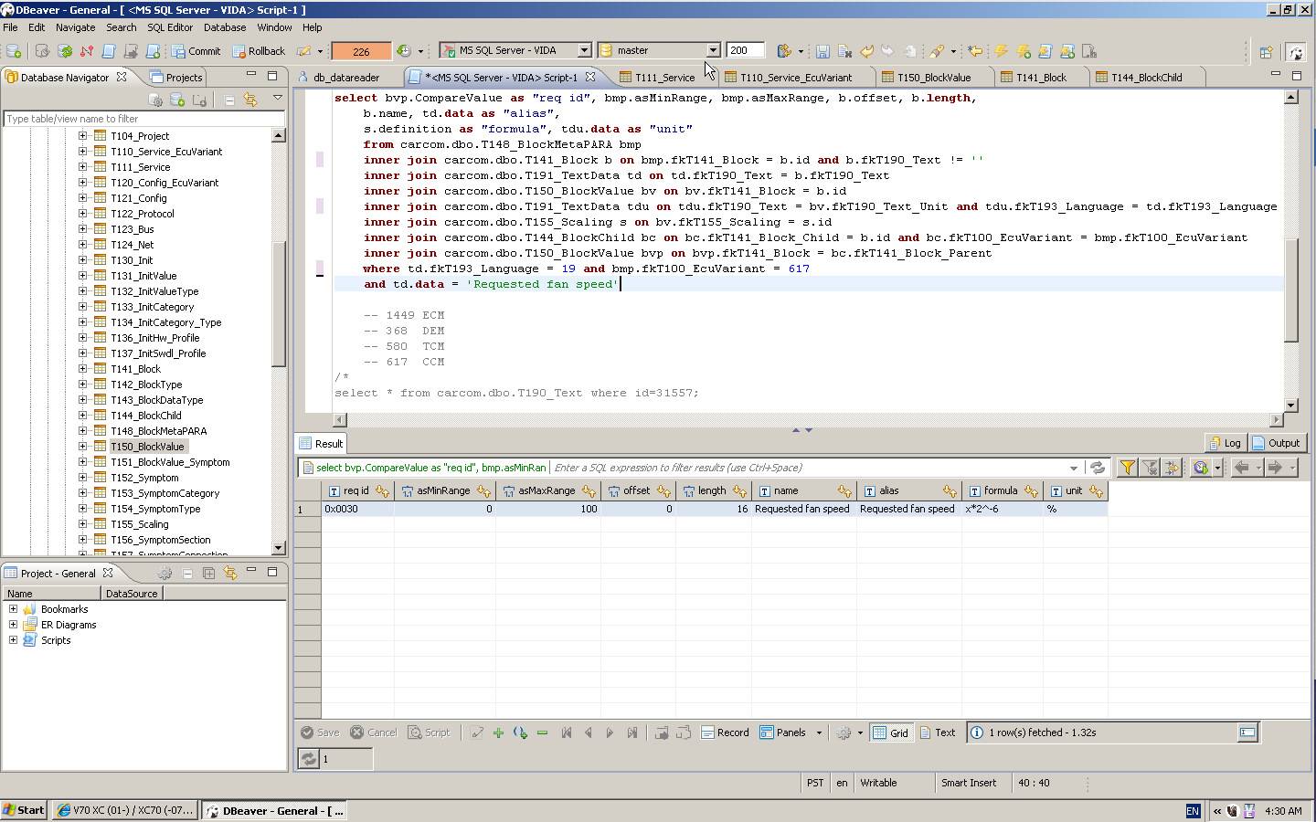

Hello, I know this is a very old thread, but can someone explain me how to find the required bits in the vida sql database? In my case it is an S60 built in 2003 and model year 2004.
Many many thanks
Andreas

Generally speaking, I was reading sensors in VIDA to have modules IDs logged in C:\VIDA\System\Logs\Diagnostics.
You can run this SQL query to figure out what module is this or that ID:
Then I came up with this query that fetches bit offset in CAN message and its conversion formula:
