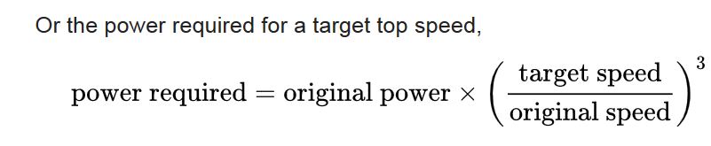

I do think you are on the correct path. Another equation states: The power needed to push an object through a fluid increases as the cube of the velocity. Image

Per the equation directly above, almost 75% more power to go from 100 MPH to 120 MPH
(120/100)³ = 1.728
