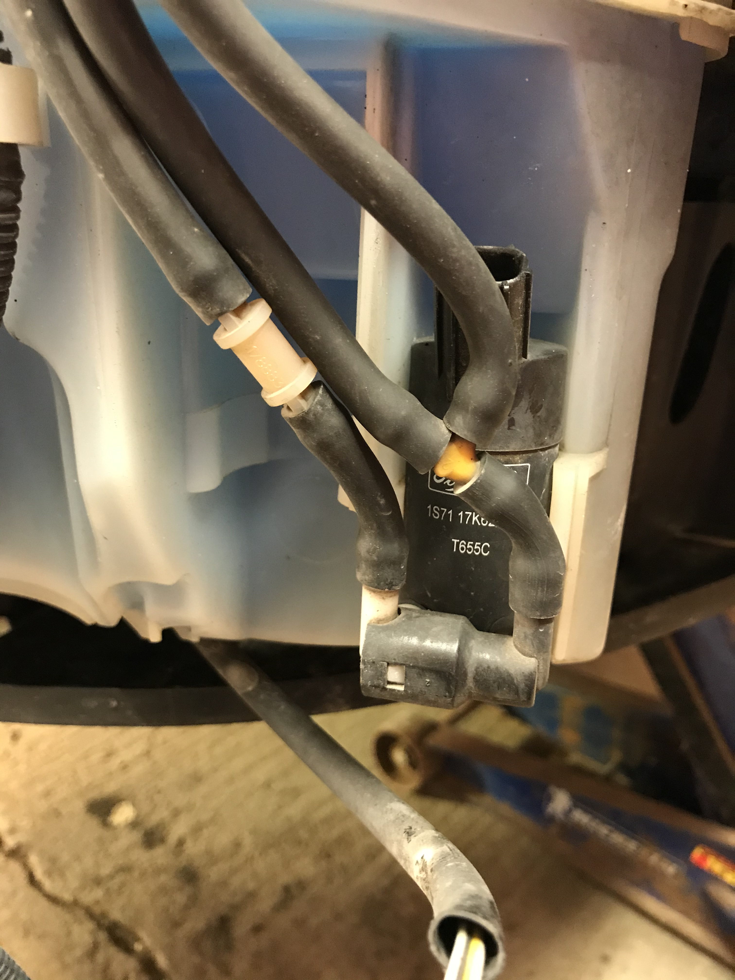

My wife complained that her windshield washers didn't work on her 2005 V70. Upon filling the reservoir with fluid, most (all) just ran away.
I crawled under the car and saw three hoses running down the backside of the reservoir, neatly held in place by "clips" on the reservoir. Two went to a little pump. One went .. nowhere!
The nowhere hose came down from the top SOMEWHERE to a coupling. The bottom of the coupling had about 2" of rubber tubing on it and that's it!
I temporarily plugged it with a bolt and hose clamp, only to discover that the pump had failed as well.
So the wheel and plastic inner fender cover came off and I had a closer look.
The tubing is pretty darn square at the end, as if it were cut by a knife, not YANKED off or pinched off by .. I don't know what could pinch it in there.
A new pump is on its way, but I have no idea where this hose goes. There is nothing else dangling that I can see .. no spare end looking for a coupling.
Any thoughts appreciated.
Alan

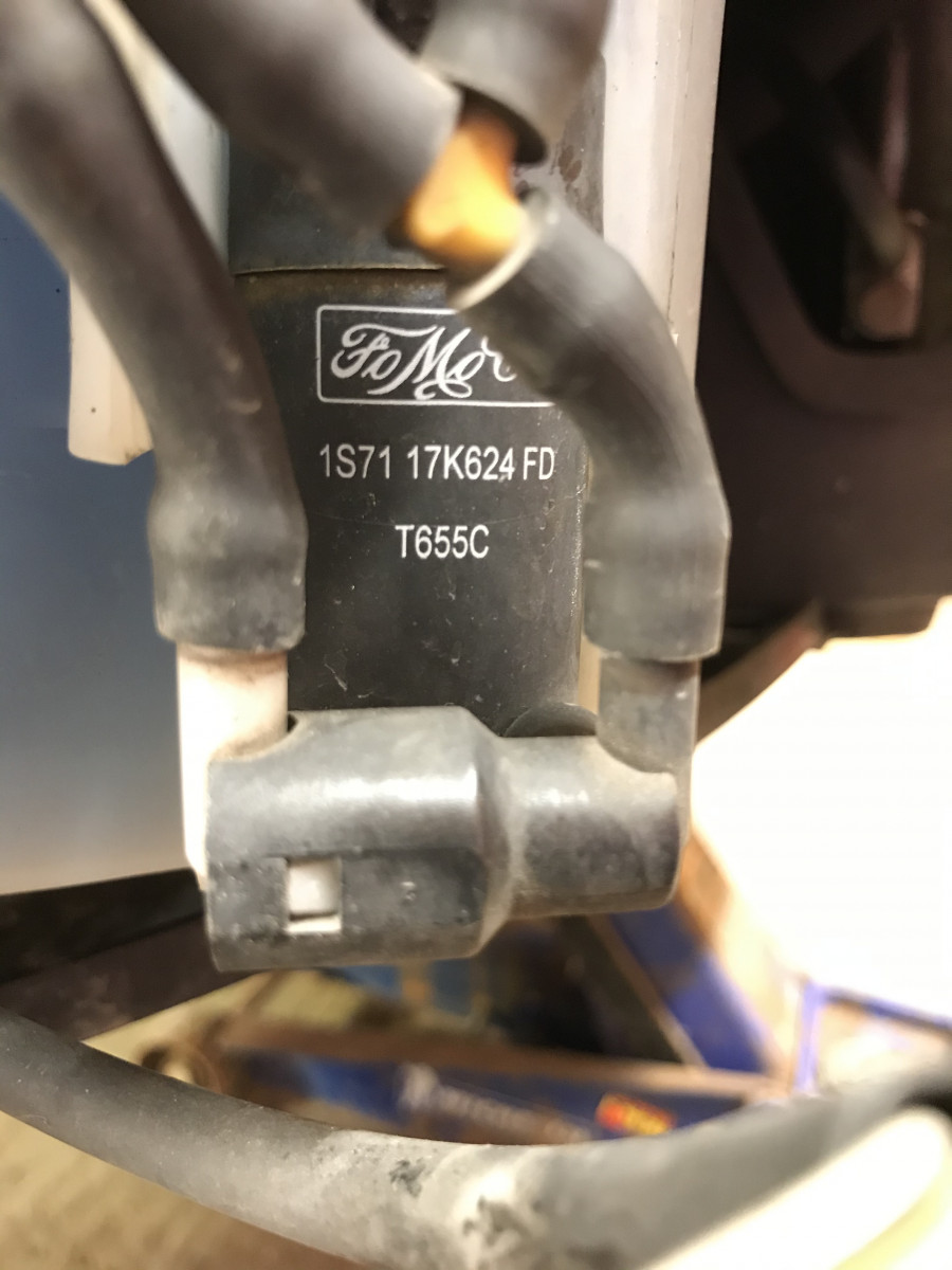

The single pump feeds both the front windscreen/headlights as well as the rear windscreen. Just get a used FoMoCo Spain pump off ebay. Don't get a chinky cheapy. The pump spins in "reverse" when you apply your rear squirters. There is a check valve down near the pump to prevent fluid from being forced down one avenue. I don't recall which artery the check valve is on, but it's there. I think it's on the line feeding the rear windscreen. Should be pretty easy to figure out. Taking the front bumper skin off is the easiest to work on this. Takes all of 5 minutes (removal).

Thanks for the time to reply! And for the pics!
Sadly, your pics do not match mine .. exactly .. but they're close enough to be confusing.
First, there is no T connector going to the right side of the pump, just a single hose. This supplies water to the windshield washers. The car does have headlight squirters, but I have no idea where the water would comes from .. perhaps from a T hidden inside somewhere that I can't see.
There is another single hose going to the left side of the pump, which sends water to the rear windscreen (it's a wagon). This is confirmed by compressed air.
There is a third hose that looks EXACTLY like the hose (in your pic) going to the left side of the pump, but on my car, that third hose is just dangling there! Unplug that hose from your pump, let it flop about and you have my car.
And the plastic fitting is not a check valve (on my car anyway), as I would have expected, it's a coupling. But why would Volvo have put a coupling in to extend a hose 2 inches to go .. nowhere?
Weirder still, if I put compressed air to this dangling hose, air comes out the reservoir! It acts like an overflow for the reservoir.
And indeed, it I COMPLETELY fill the tank, right to top of the filler, the water drains away out this third hose, down to the top of the actual tank.
Anyway, I've rammed a long bolt in and added a tiny hose clamp and I can now fill the tank to the top.

I've never checked to see if it is a "check valve", that's just what made sense to me as the pump obviously spins on opposing directions depending on which windscreen is needing washing. Glad you got it sorted.
