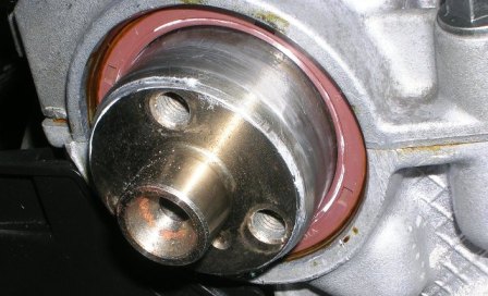

Fordman,
I really like your method of driving in the seal. I tried to use a seal set from Harbor Freight but there simply isn't enough room behind the strut tower on the exhaust side camshaft to make it work and I drove it in with a punch by tapping around the perimeter. Your method looks much preferred.
...Lee
...Lee

re: the seal, just get a pvc fitting from the local big box that has a slightly lesser outside diameter than the seal. If you spray silicone around the outside rubber perimeter and smear some grease on the inside camshaft surface of the seal, then get it started. SImply press on it with your pvc sleeve, cap, section of pipe, etc. and it slides home.
You could also use the rim of an energy drink bottle that has about an inch and a quarter diameter. Just cut the top off and use it with the cap off of course, toss the rest.
