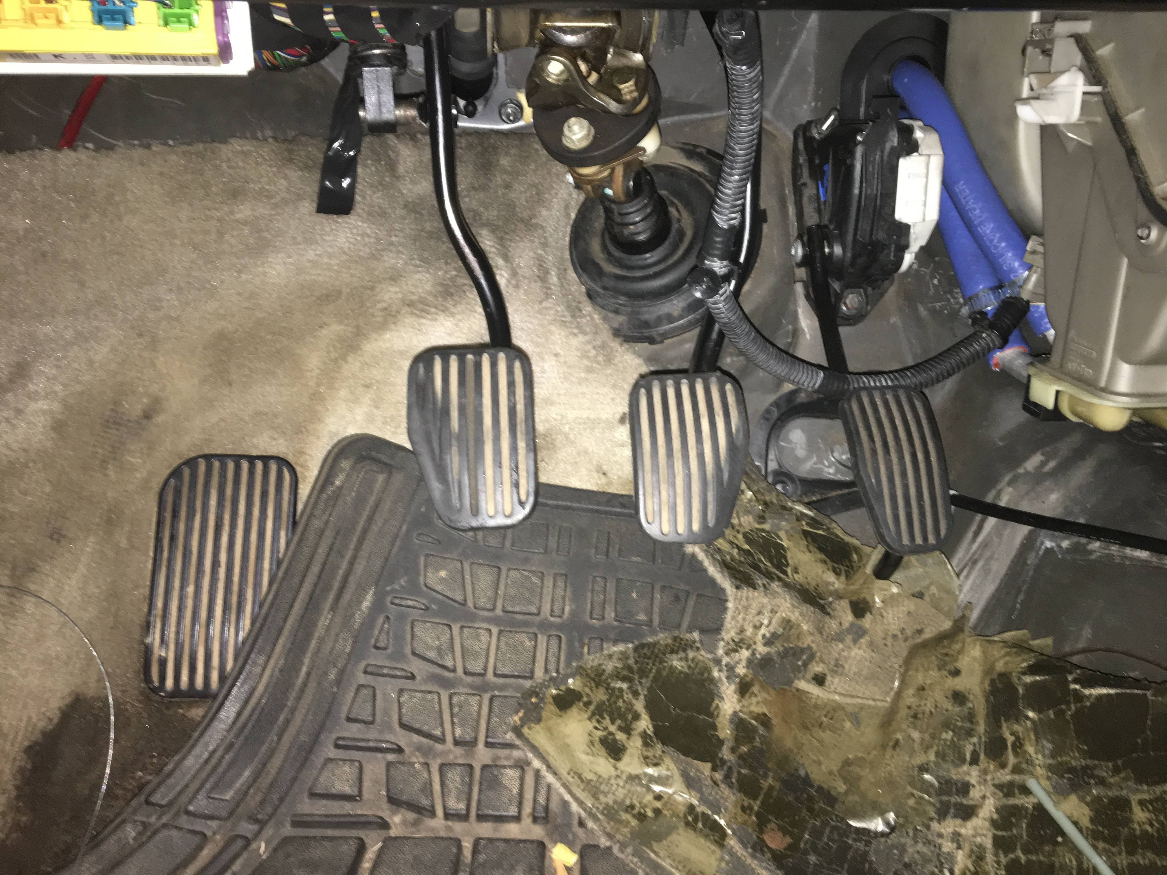

Little more progress on the manual swap today... pedals and master went in last night and the shifter and cables went in today.
Had some "scheduling issues" and nasty rainy weather yesterday that put a damper on things, but tomorrow will be nice again and hopefully we can finally wrap this up! It's already taken WAY too long.

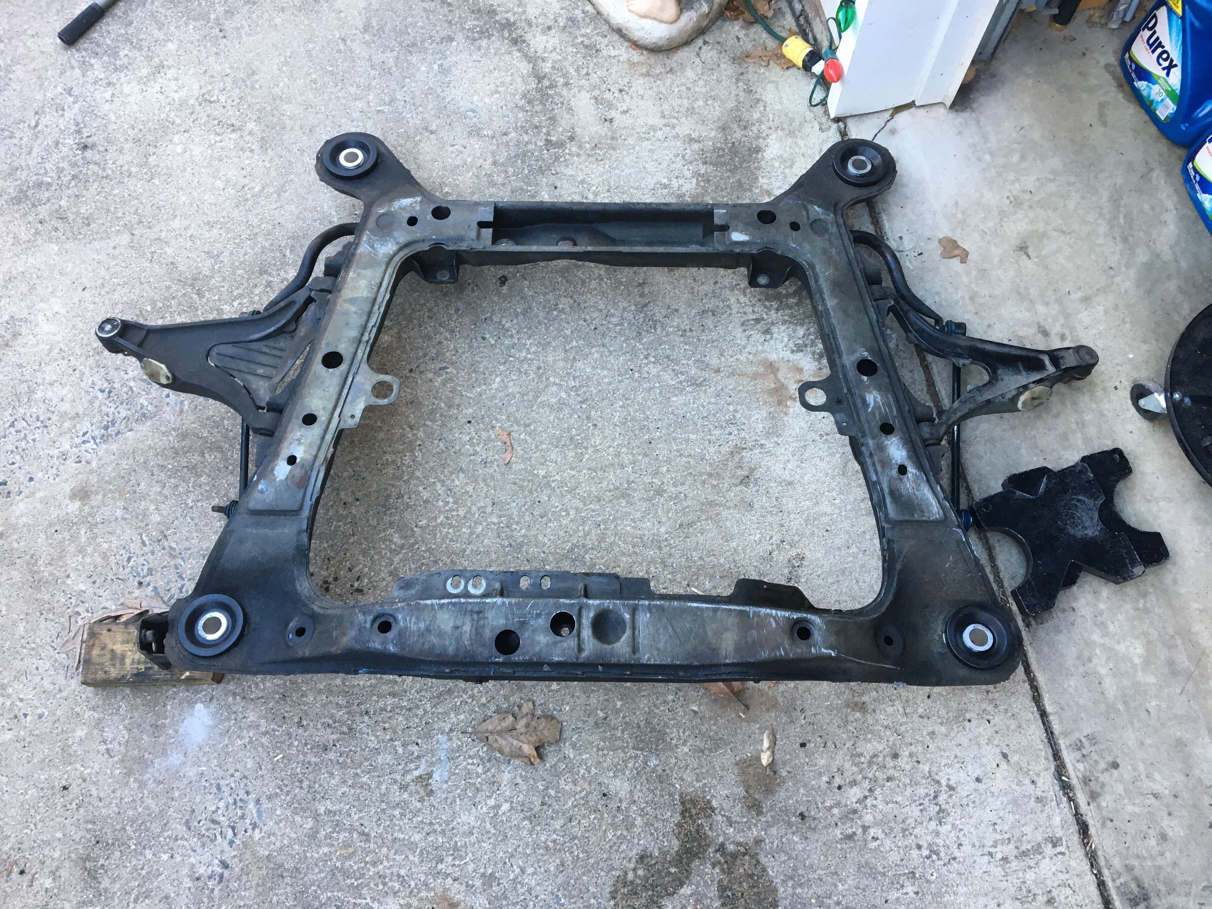

We also pressed in some delrin subframe bushings... really easy to knock right in with a dead blow! The old bushings came out surprisingly easily too... just cut through the outer shell with a sawzall and knocked them right out with a screwdriver and hammer. I tried to use the press, but the subframe is pretty heavy and I couldn't get to a saw horse to hold it up, and the angle on the front part of the SF wouldn't allow it to sit evenly to make the press effective.
