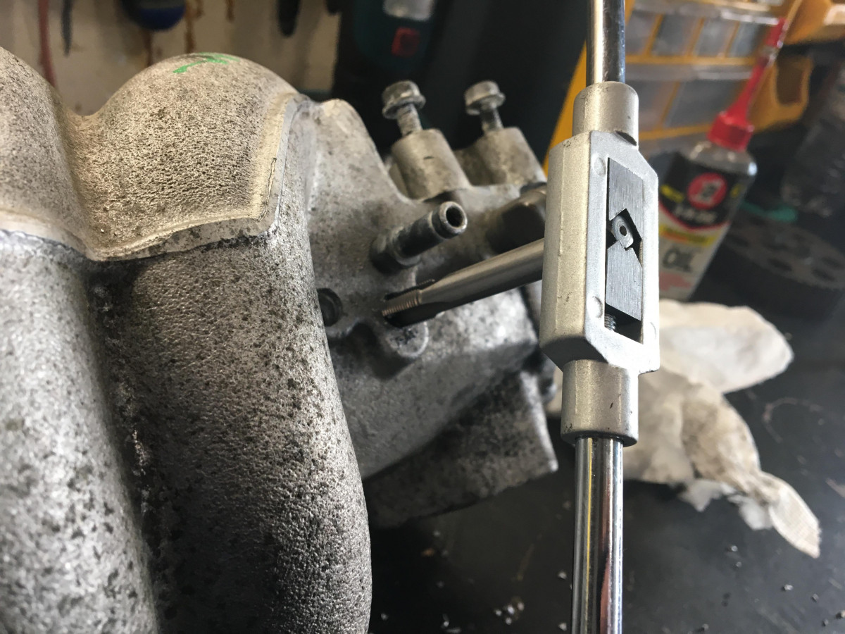

The tap arrived yesterday for the barbs for the NA intake manifold. Really easy to modify it for the turbo... all you need to do is add two barbs. You may only need to add one depending on the year, but for this '98 it requires three total (excluding the brake booster)... one for the purge valve, one for the CBV, and one for the fuel line. The NA '98 manifold only has one.
Simple process... I used an automatic center punch to start, then used a 13/64" drill bit for pilot holes. Then moved up to an 11/32". Technically for an M10x1.0 tap, you're supposed to use a 9.1mm bit. 8.9mm or 11/32" are acceptable for M10x1.25", and the 11/32" worked perfectly for the 1.0 being that it was just 0.2mm smaller.
Be sure to use cutting oil, and clean the intake manifold thoroughly before installing! This will all go back together after I replace the leaking thermostat housing gasket, which of course is not available locally. That's on the way from eEuro now.

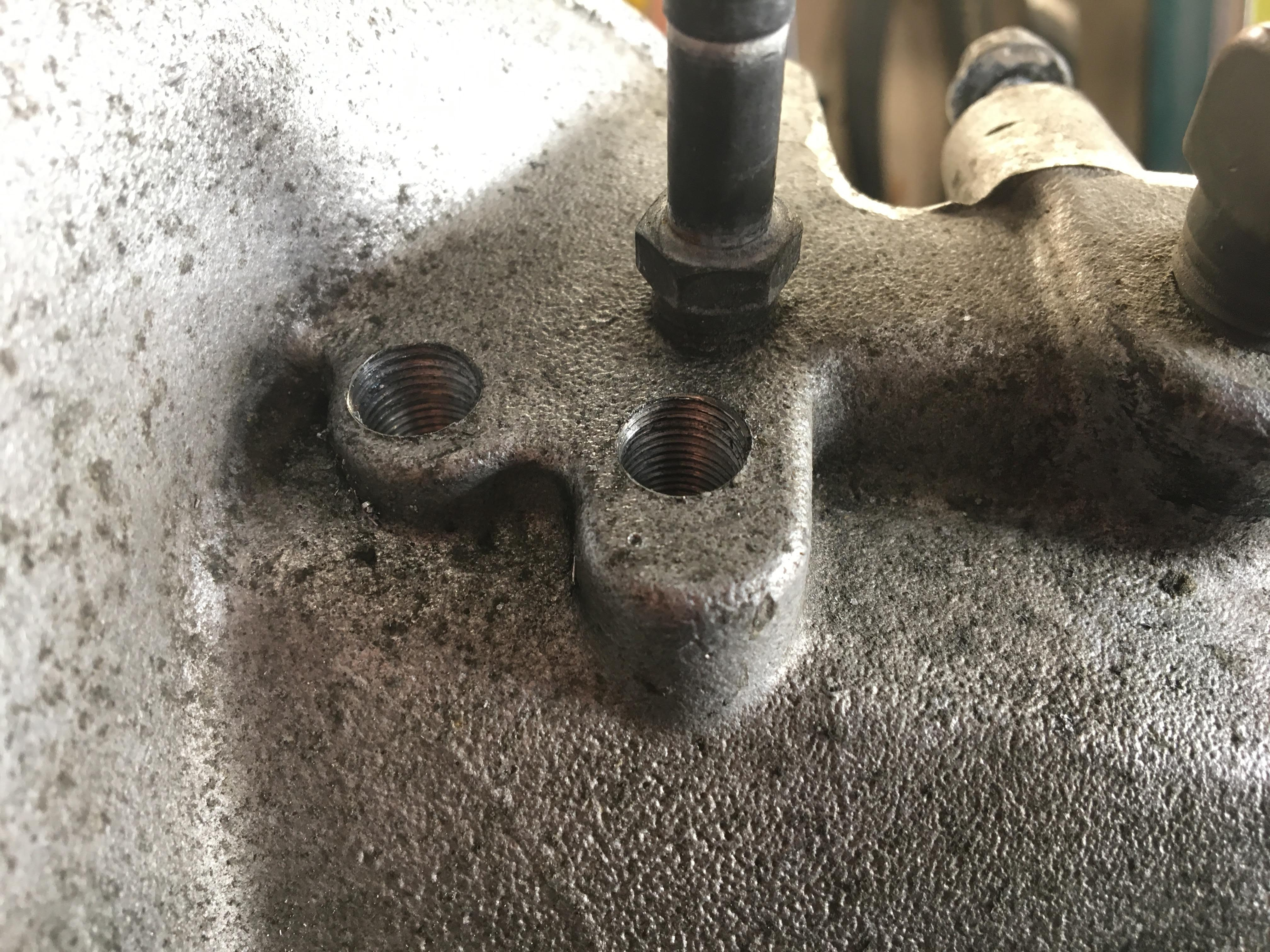

Fresh threads ready for the barbs! Just like the turbo intake manifold! The other option is to port/gasket match the throttle body on the turbo intake manifold (like I mentioned before), but this is easier. I don't have any good carbide bits for my die grinders, so it was going to take WAY too long to get through it.
