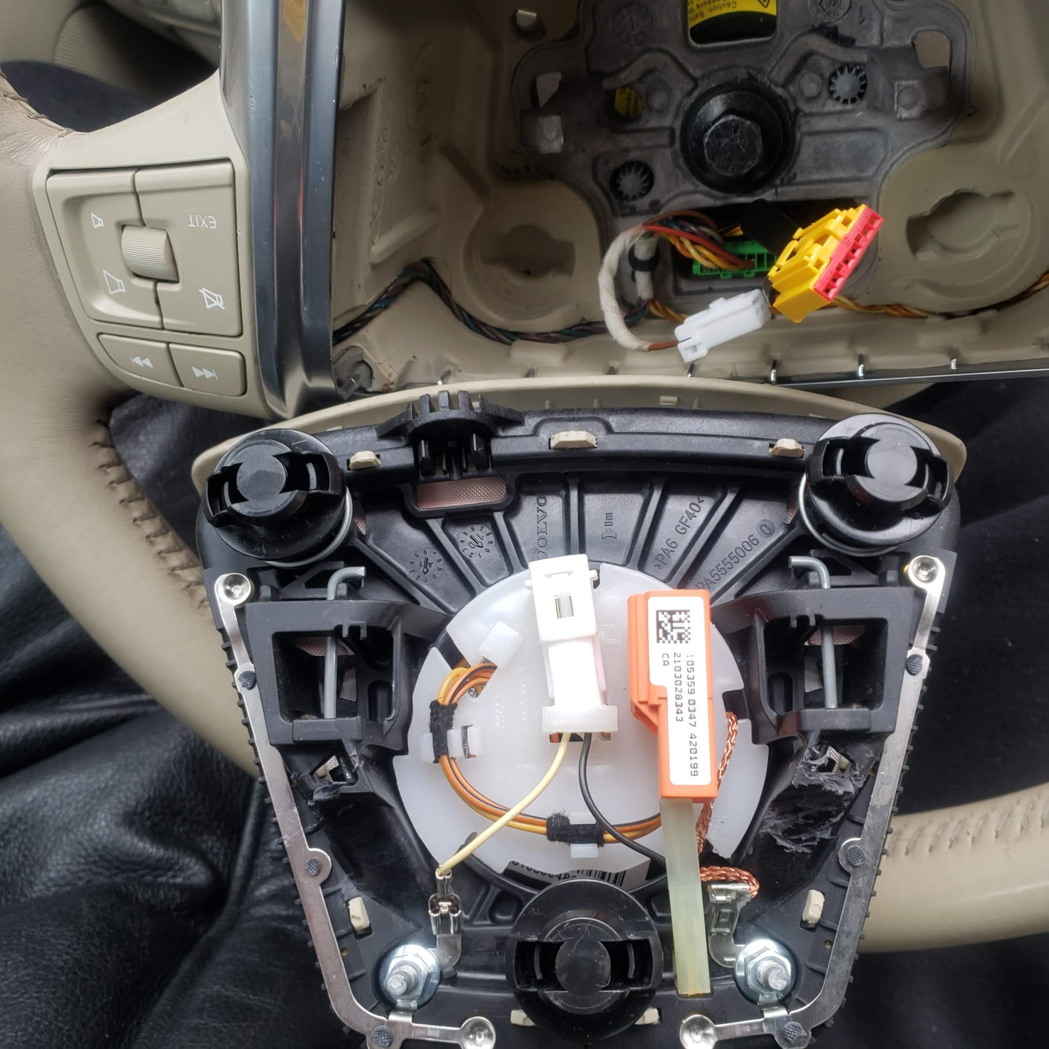

I looked for videos to see what the latch looked like, I needed to replace the metal ring in my 2011 xc60.
1 Tool needed, smallish screwdriver to allow levering the spring steel wire off the hook.
See attached picture.
