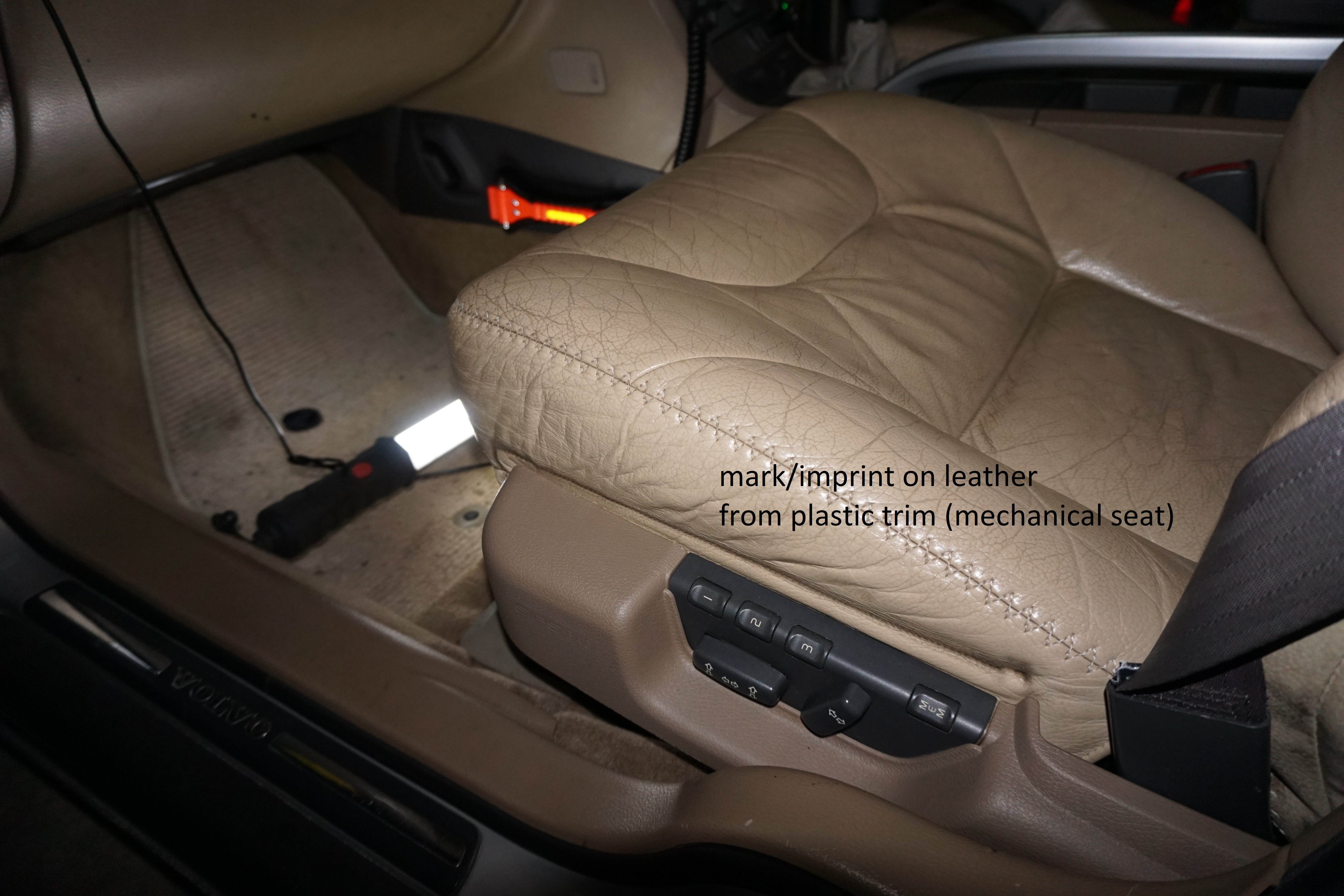

Ok great thanks, I looked at your pictures on how to remove the seats once they're unbolted, thanks. That should make my job easier! I'm not changing the whole seat, just the lower seat skins but I will do it with the seat removed and on the bench.

I did a manual seat to power seat swap on my xc70, i actually used the drivers side power rail on the passenger side.
the air bag connector is yellow, its pretty hard to mix up one plug, plus they only connect to each other.
You may decide to swap the entire seat instead, any reason why not?
removing the skins is harder than it looks. You may want to use zip ties to connect the skin to the cushion instead of the metal clips. I detached the base from the rails on my passenger side
