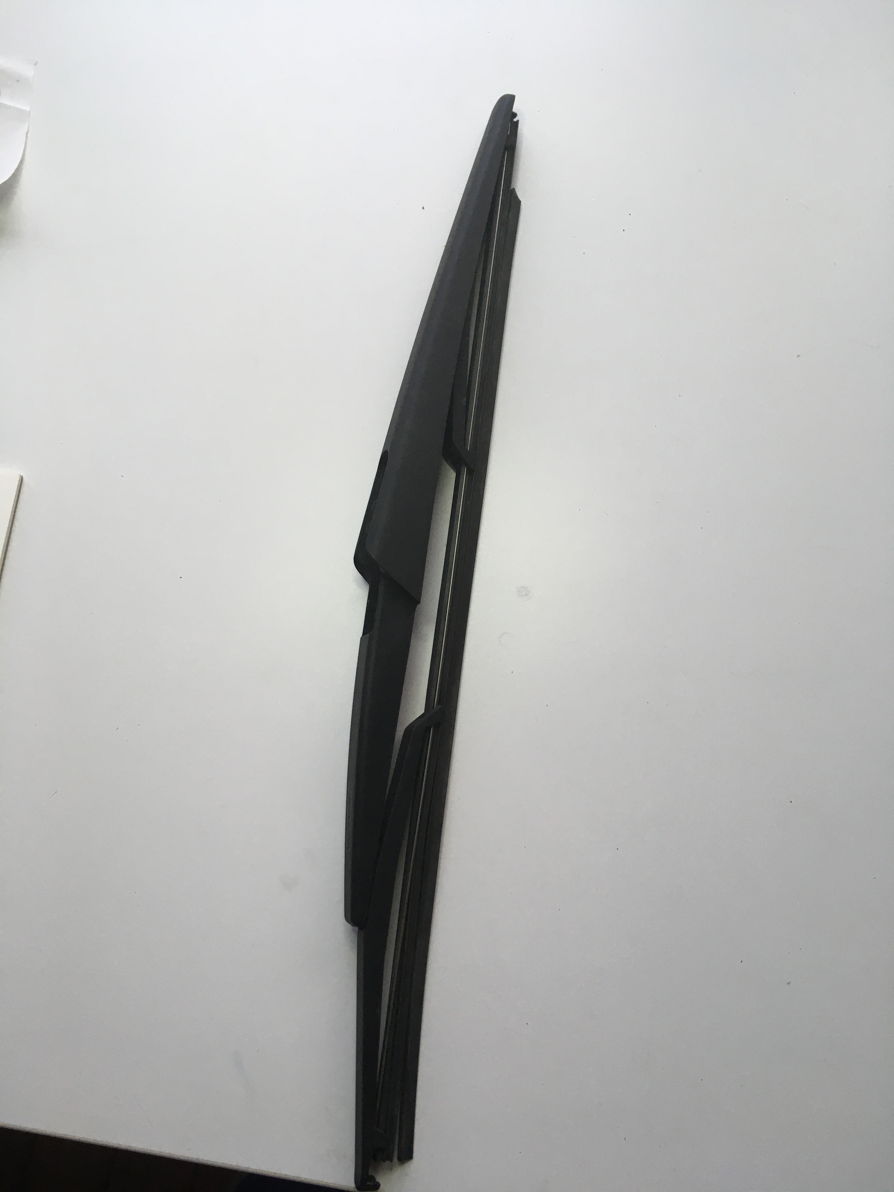

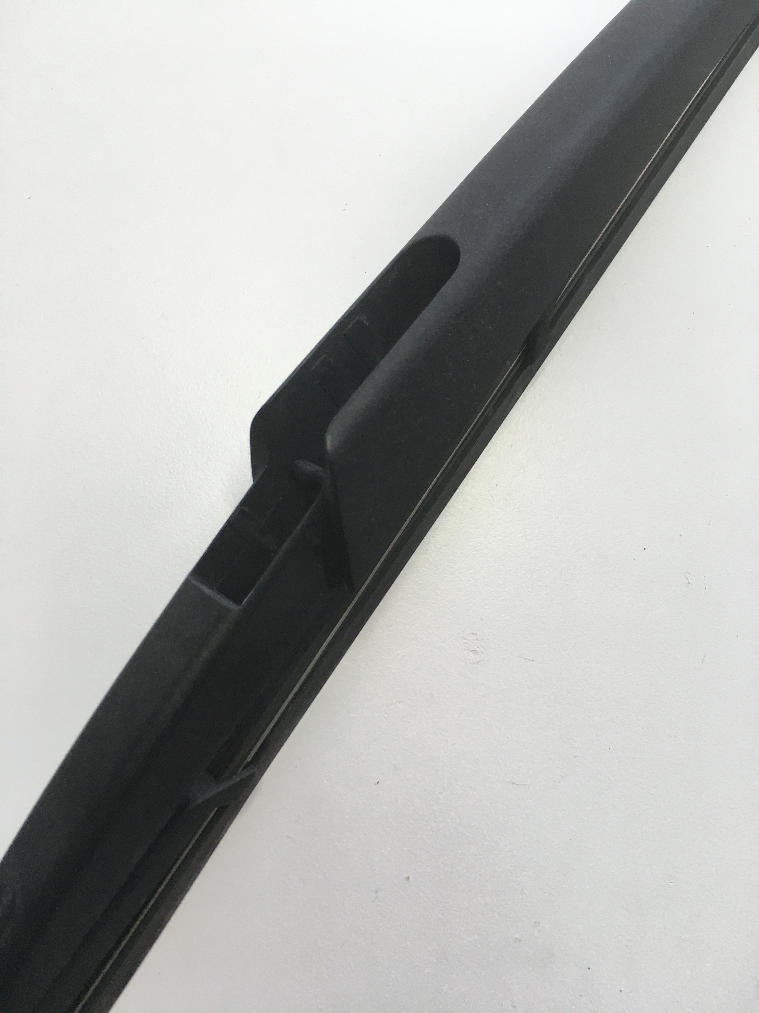

How have you wagon people handled rear wiper replacement? It's such a simple thing - buy a replacement and pop it on. I found a set of Michelin blades, put on the fronts, and the rear is a special, plastic, volvo-shaped arm which will look goofy with your normal replacement wiper arm.
I tried to buy the rubber blade refill and no auto parts places carry them anymore.
I searched around and sure enough, it's a Volvo part supplied by Bosch. FCP has them for $15-ish so I ordered one.

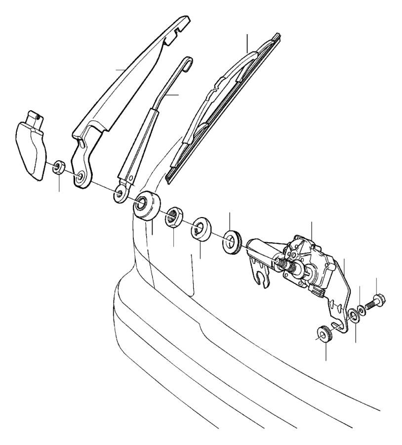

This is the parts diagram for an '04 wagon. Mine does not have this standard issue metal arm with the hooked end which connects to a basic replacement blade.

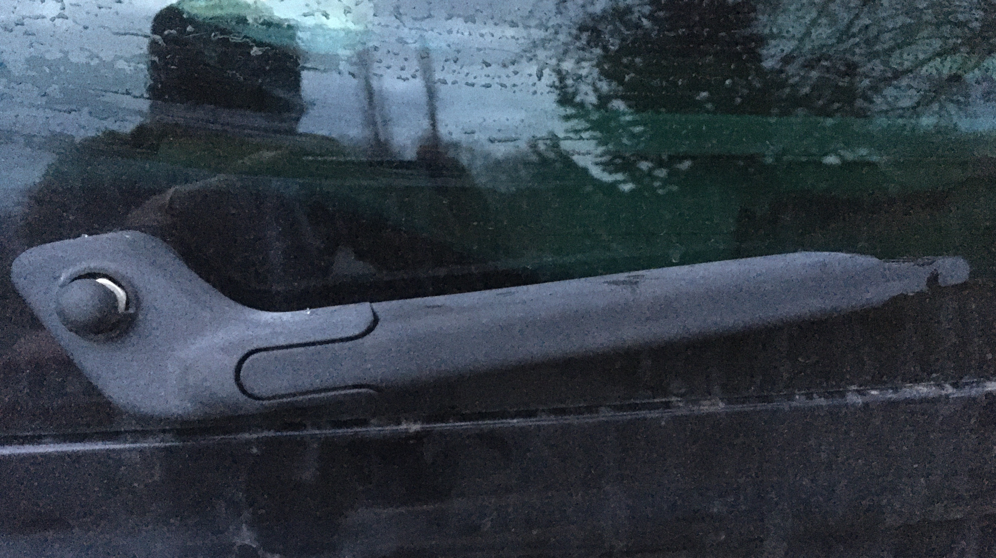

It looks like this and is a form-fitted piece with the main arm.

I bought the Bosch blade. It's not the actual OE though they look slightly different.

I bought this one......
https://www.fcpeuro.com/products/volvo- ... 3397011022
..and I see this one as well, which looks identical...
https://www.fcpeuro.com/products/volvo- ... 0-30753767

I buy a cheap 12 inch generic blade and take the rubber insert out , then mount it in the Volvo arm
I learned to do this thanks to BMW where the formed arm rear blade is about $50
