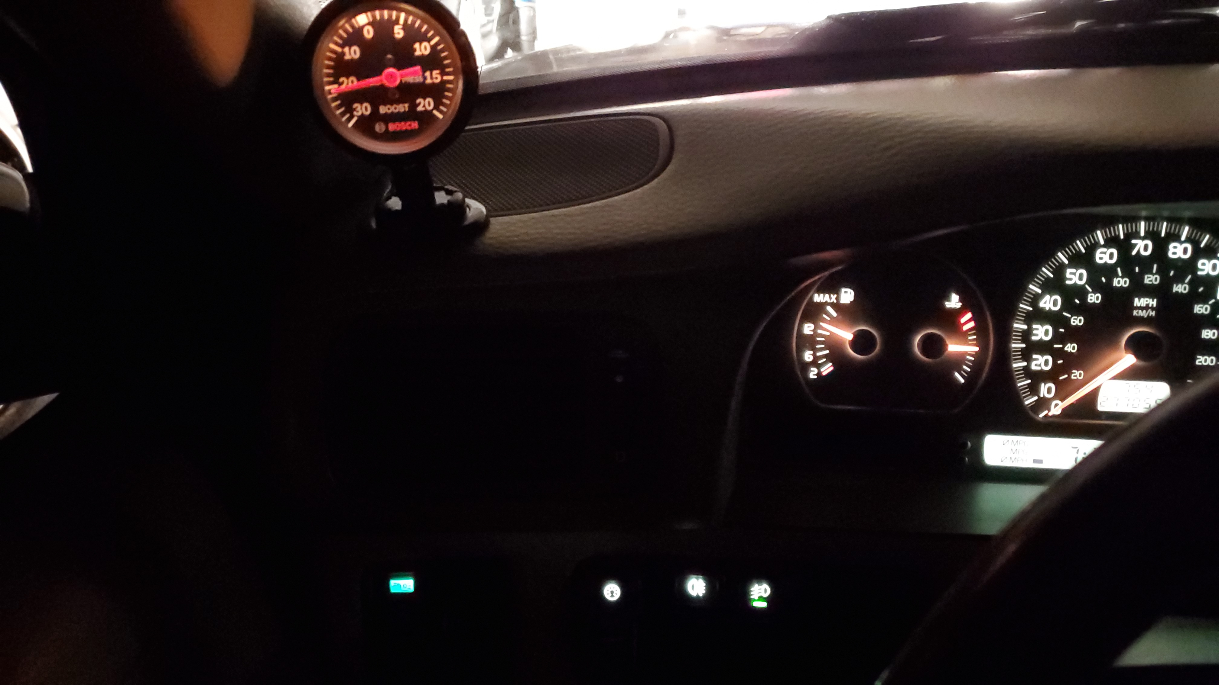

Installed a Boost gauge on my 99 GLT. The main reason why I installed it was to diagnose an issue that I was having. I learned a few things... I am over boosting on initial acceleration, then boost cut kicks in at around 10 or 11 psi (depending on how accurate the gauge is). If I feather the throttle and keep it below 7 psi, The performance is perfect. Now I just need to chase what is causing the boost spikes. Boost Sensor is brand new as well as the TCV solenoid. I tested the wastegate actuator with a mightyvac and it moves. I need to take the shield off tomorrow and see if the the wastegate itself is binding.
well here is a pic and some videos

You checked the wastegate with the pressure setting, correct? Most Mityvac models only do vacuum.
I believe the GLT should be set to 2 PSI, but I'd have to confirm that.
