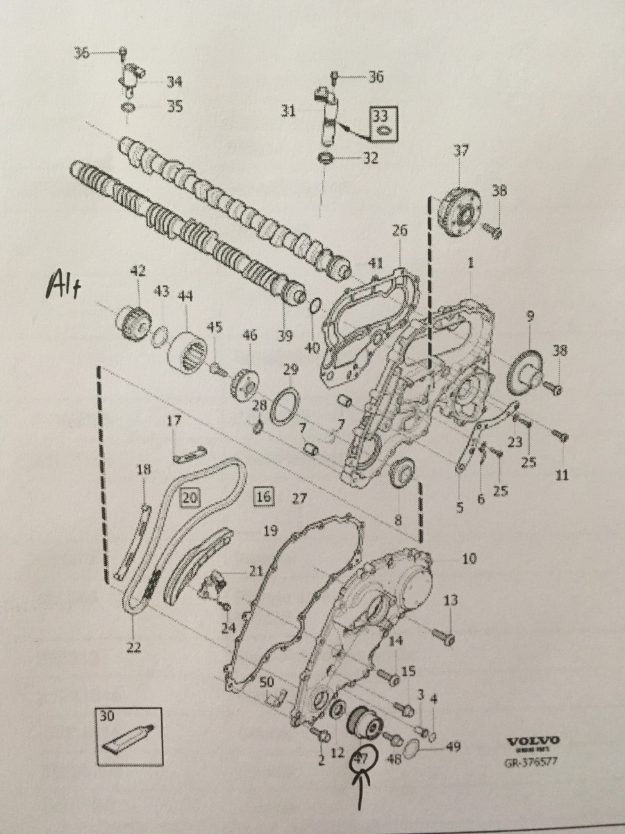

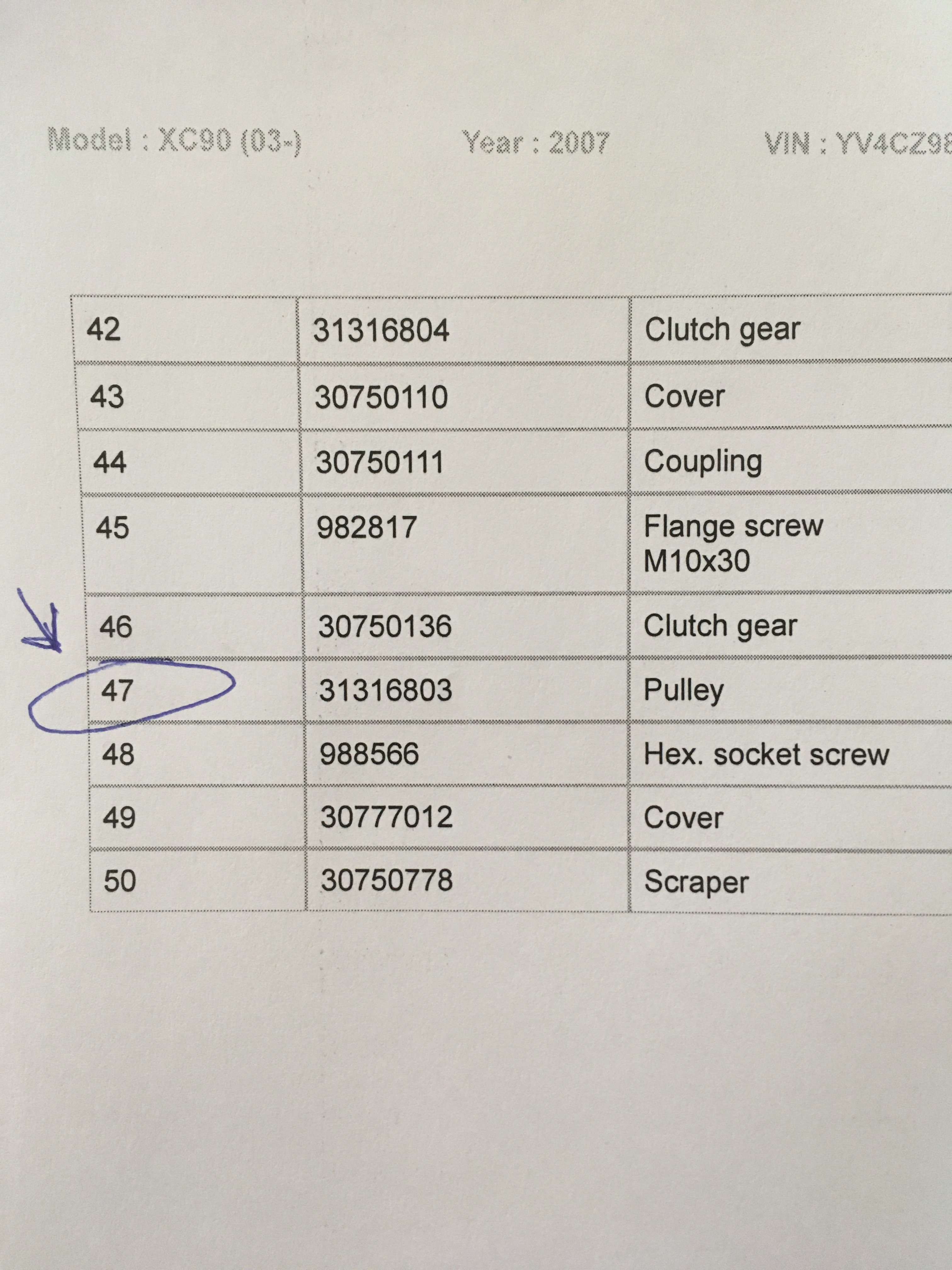

They changed the design slightly over the years
But I believe they are all interchangeable
https://www.freel2.com/forum/topic33867.html
The part numbers for this overdrive pulley are
INA 535 0195 10
FORD 6G9N-6A312-AE
FORD 6G9N-6A312-AF
LAND ROVER LR004305
LAND ROVER LR005993
VOLVO 30750929
VOLVO 30777744
VOLVO 31316803
INA 535 0195 10
FORD 6G9N-6A312-AE
FORD 6G9N-6A312-AF
LAND ROVER LR004305
LAND ROVER LR005993
VOLVO 30750929
VOLVO 30777744
VOLVO 31316803
