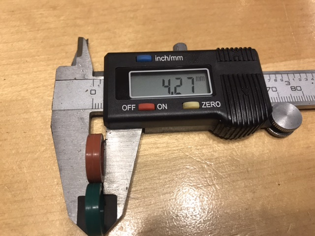

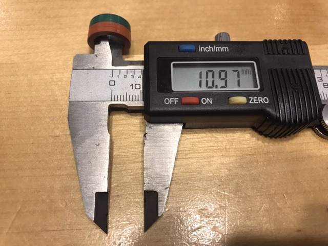

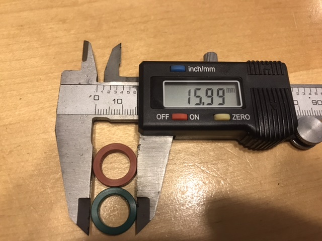

The cross-section of the o-ring is rectangular. I think you could probably get round (cross-sectional) o-rings to seal (doubled or tripled up), but I think they will tend to "roll up" the dipstick tube as you insert it. Maybe if you can get the right size use 3 or even 4 just in case the top one rolls up too far.
This is OEM Volvo - https://www.fcpeuro.com/products/volvo- ... 30637865oe
This is aftermarket - https://www.fcpeuro.com/products/volvo- ... al-1397983
I've used both several times with success, so I'd say go with the cheaper.
O-ring dimensions are ID - 10.97mm (safe to say 11mm ID would work), 15.99mm OD, and a cross sectional width of 4.27mm.
