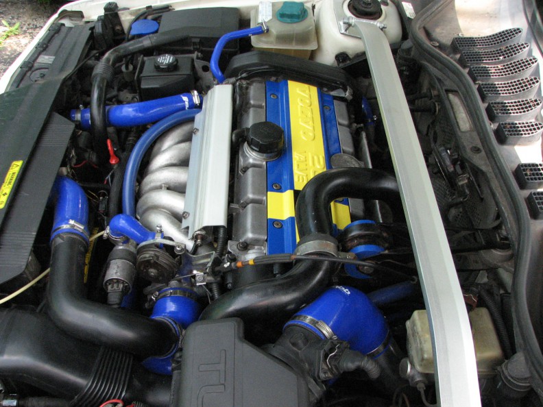

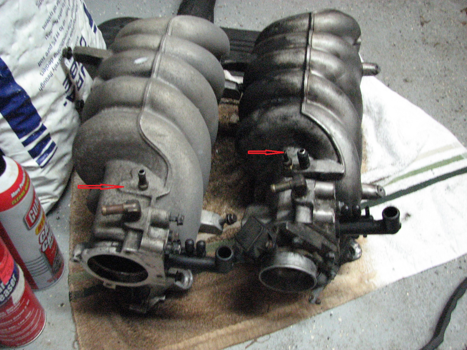

The non aspirated intake manifolds from years 1995 to 1998 had the same intake port to the head design as the turbo, but the throttle body size was 3" as opposed to 2-1/2" on the turbo manifold.
These are the characters in question. Throttle body still attached to turbo manifold.

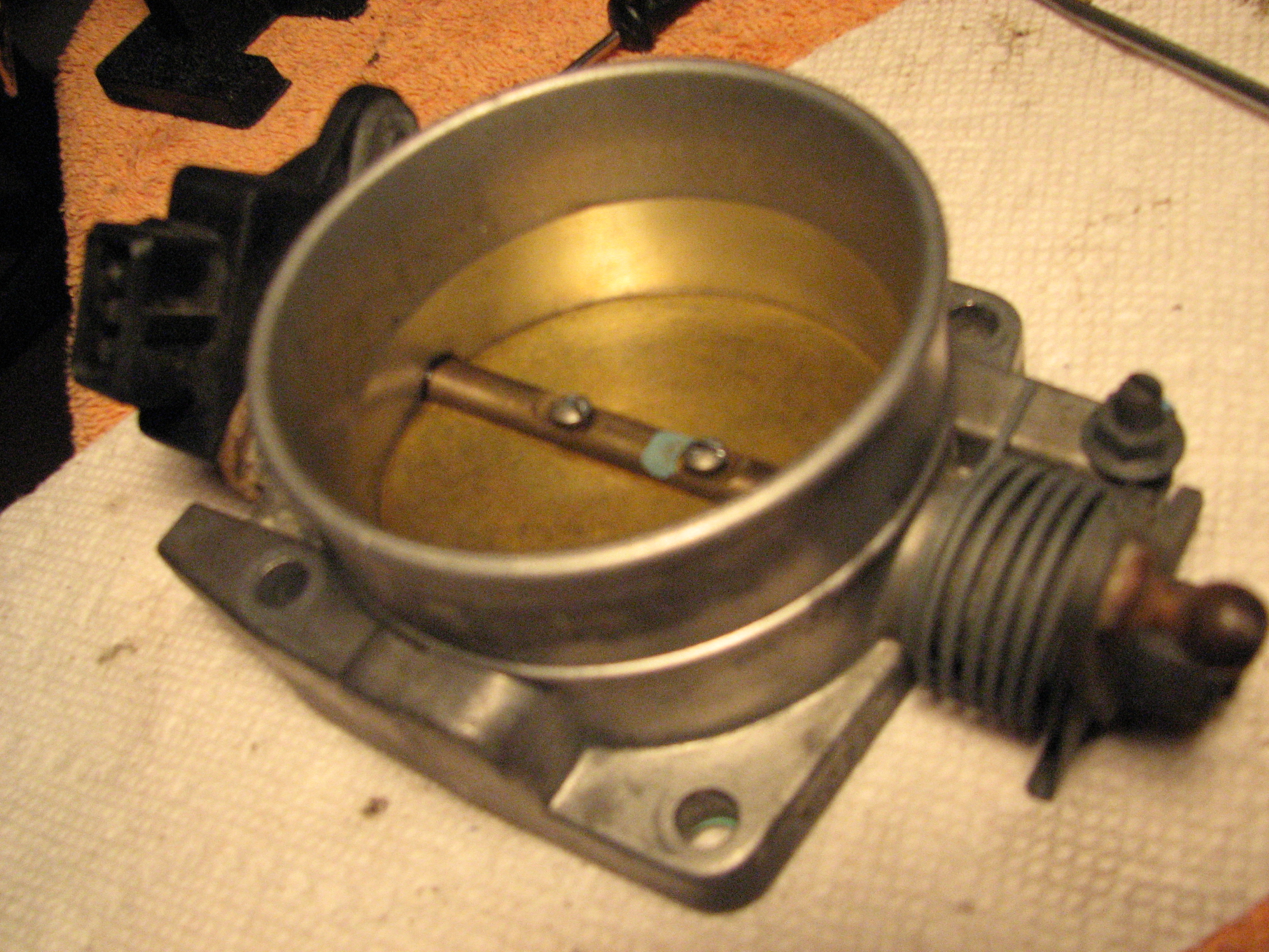

Also, while utilizing the 3" n/a throttle body, it will be necessary to change the throttle plate to an unobstructed type as used in a 960 n/a throttle body.
That would take care of the intake .

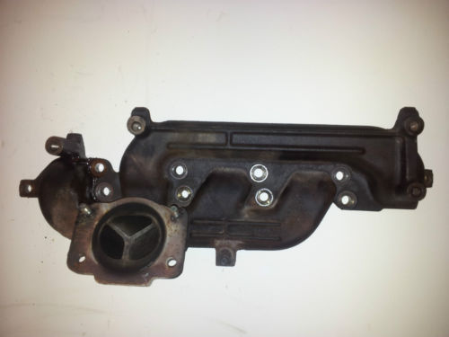

So the original title of the thread must refer to the R exhaust manifold. I believe the new fad is the'04 year, but it is close to the original R design.
The benefits of free flowing exhaust are heat reduction, boost response, and plain and simple functionality of an internal combustion engine by design. Horsepower?
The direct path of exhaust ports to drive the turbo is much more efficient than the LPT or even older T-5 type.
The R manifold.jpg (5.34 KiB) Viewed 9523 times
Effective, but designed for a flat torque curve in mid RPM.
Stock Turbo manifold.jpg (18.34 KiB) Viewed 9514 times
