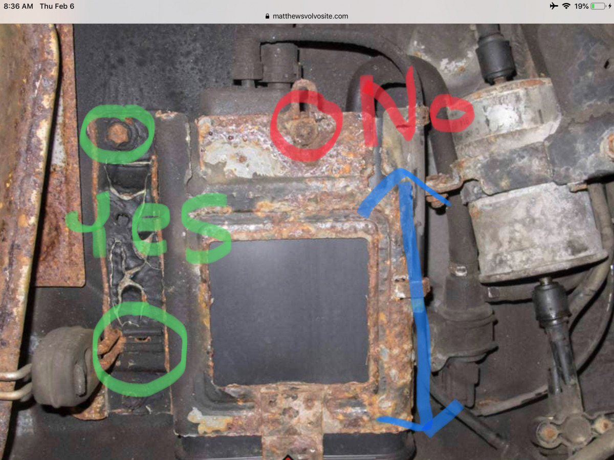

MrAl wrote: 03 Feb 2020, 16:42 find the parts like the 'canister' so i can find the hose to the tank i guess.
On a '98 V70:
1. Lift rear of car.
2. Install Jack Stands.
3. Crawl under right ( passenger ) side.
4. look up.
The EVAP canister is shaped like a brick.

Hint on this one
Your chances of releasing the Evap container with the red circle are nil, like a MAN CITY comeback
But, you can release the two green bolts ( support muffler) and then bend the canister frame down on the blue axis very easily.

I am not exactly sure how to troubleshoot the EVAP system. Hoses all over the place?
