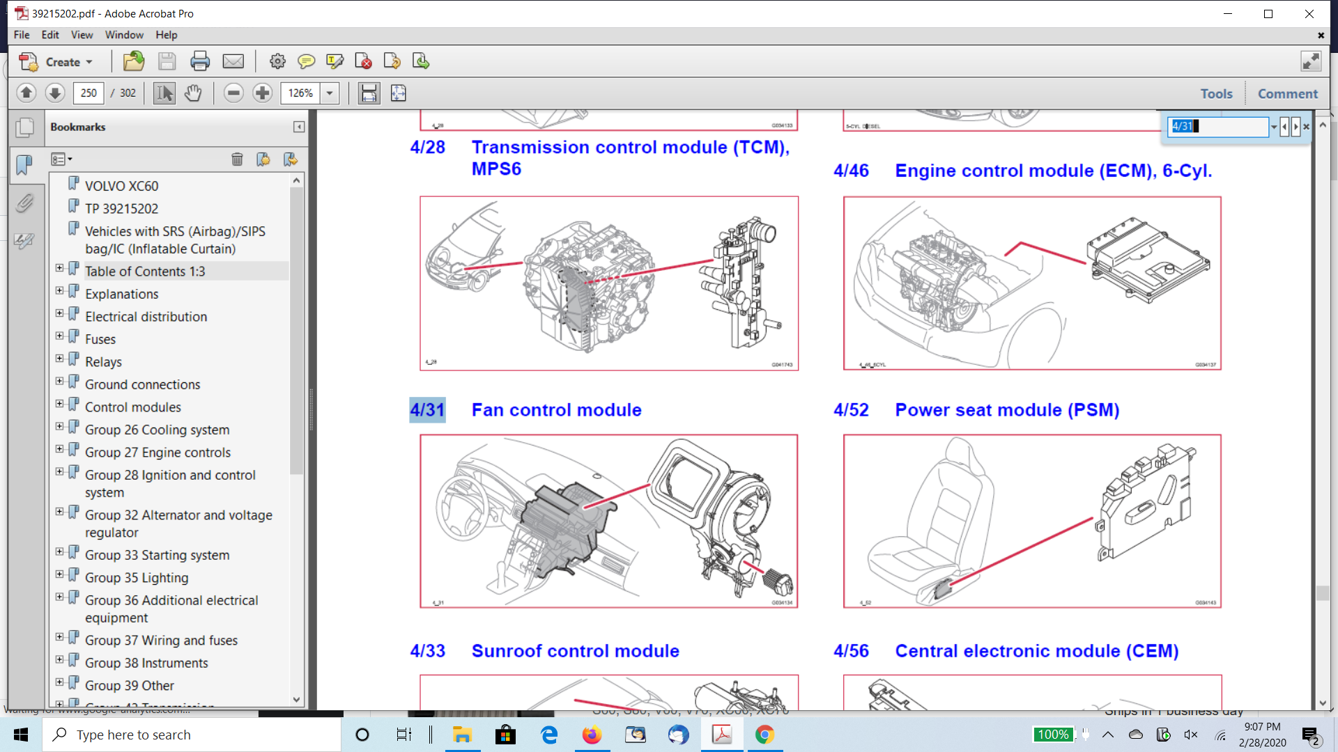

When I shut my car off the blower keeps running and kills my battery!! In my research I have found that it is most likely the blower resistor. now I can't figure out how to get to it!!! Can someone please help me???

Most likely attached and part of the blower motor. Search some YouTube videos.. looks like a fun task ;-)

Volvo HVAC B Motor Control Unit - Volvo part number 30767040 ~$150.00.
Behr Hella part number LR002685 ~$50.00.
