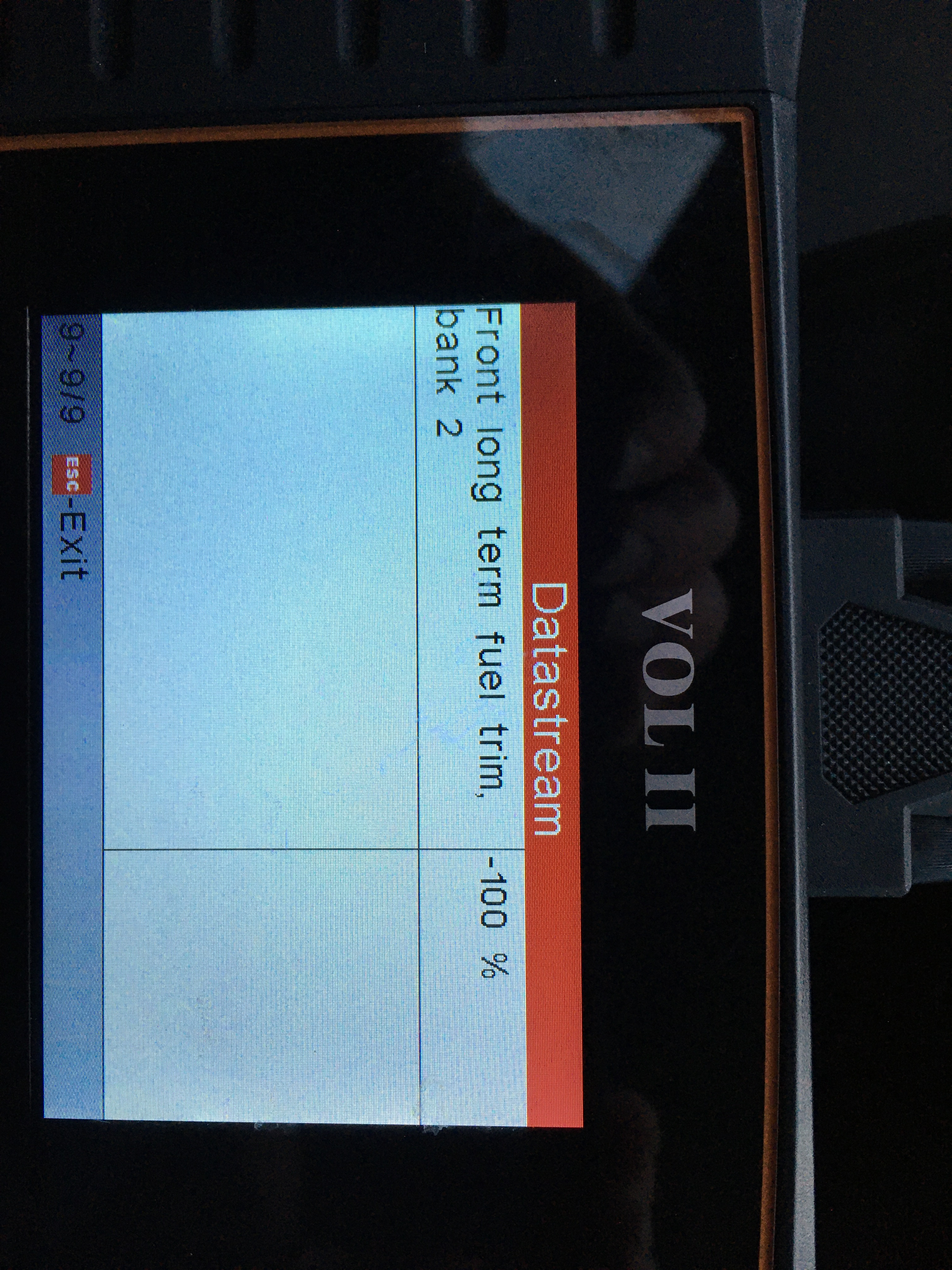

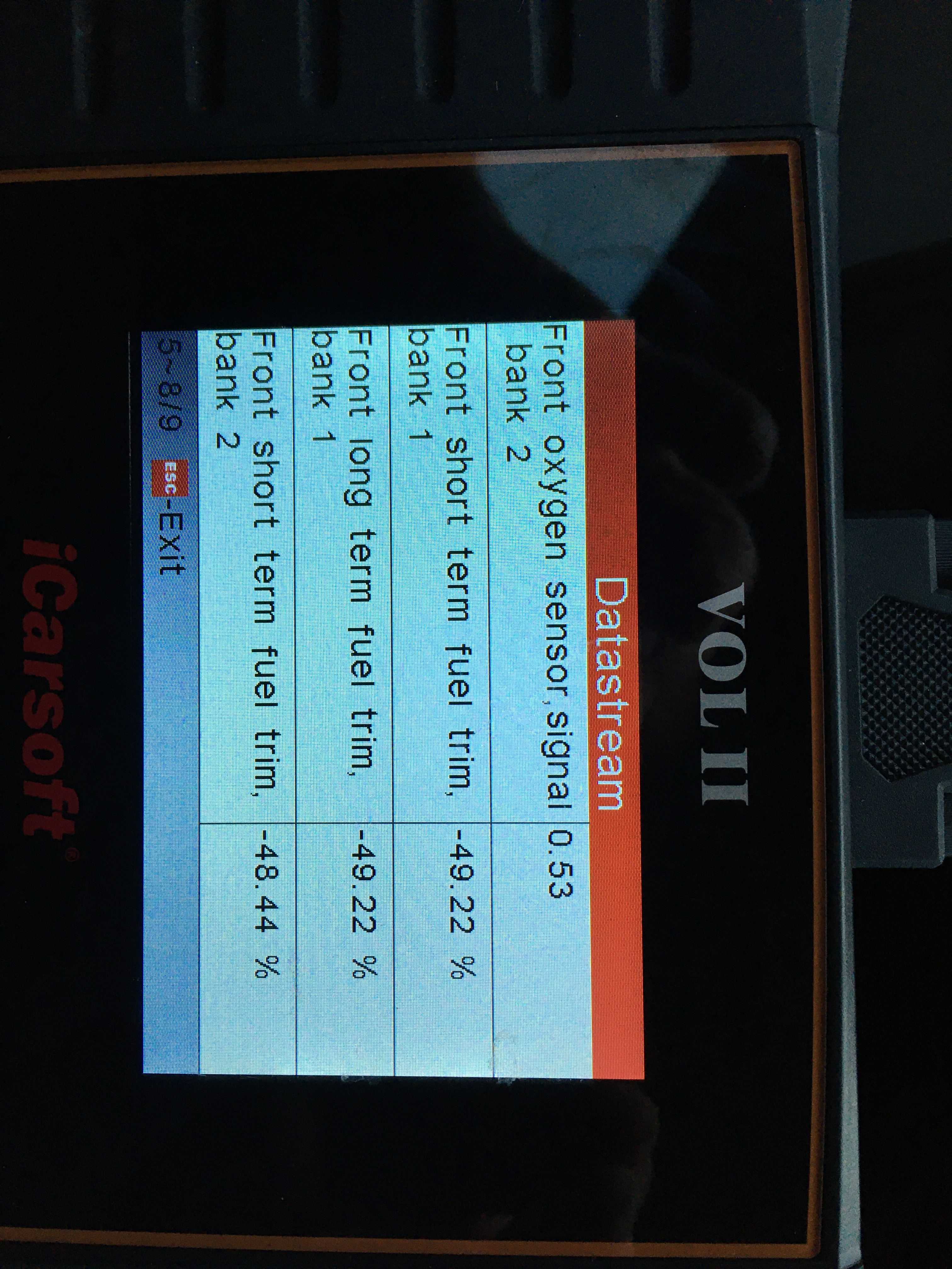

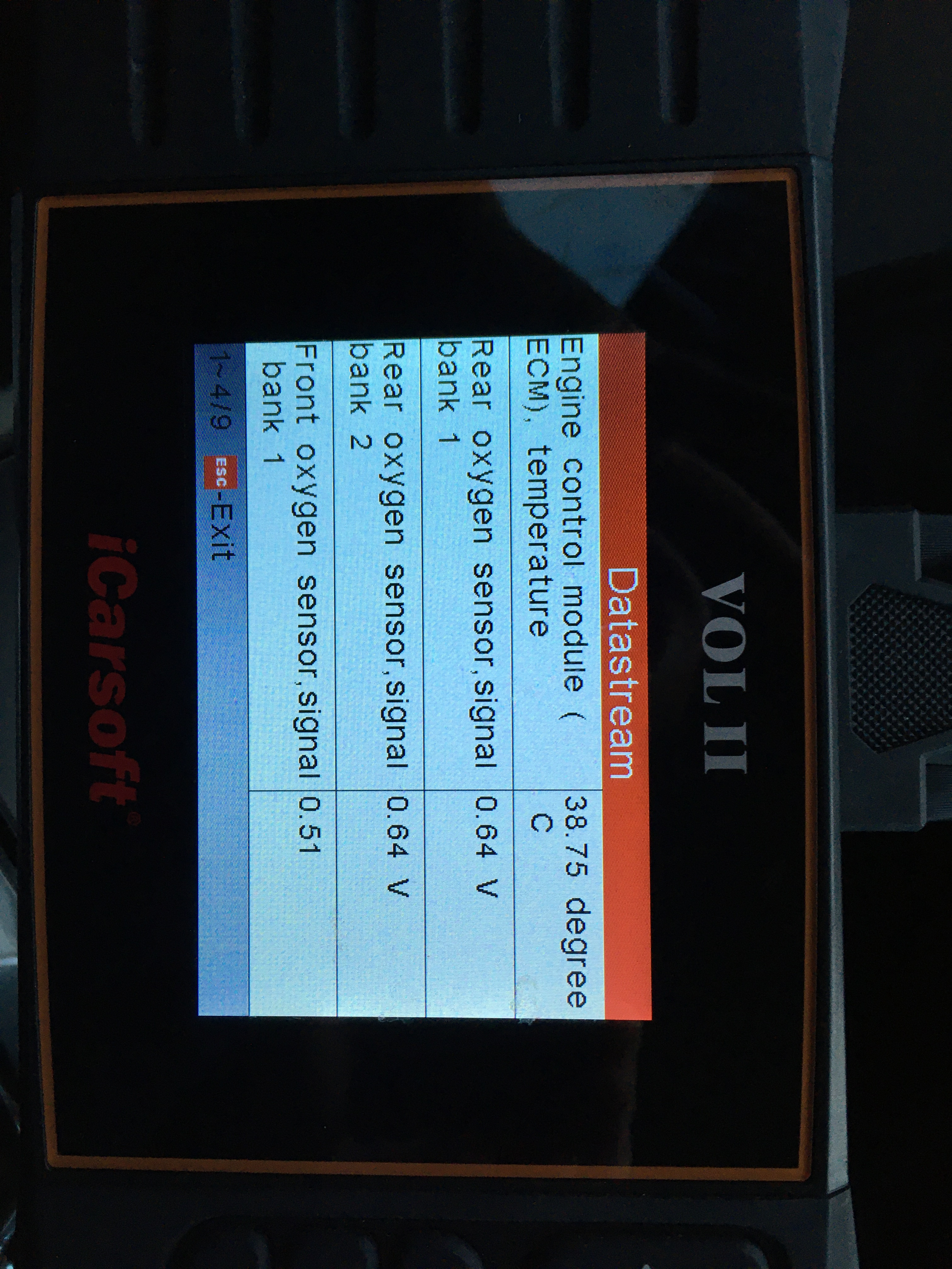

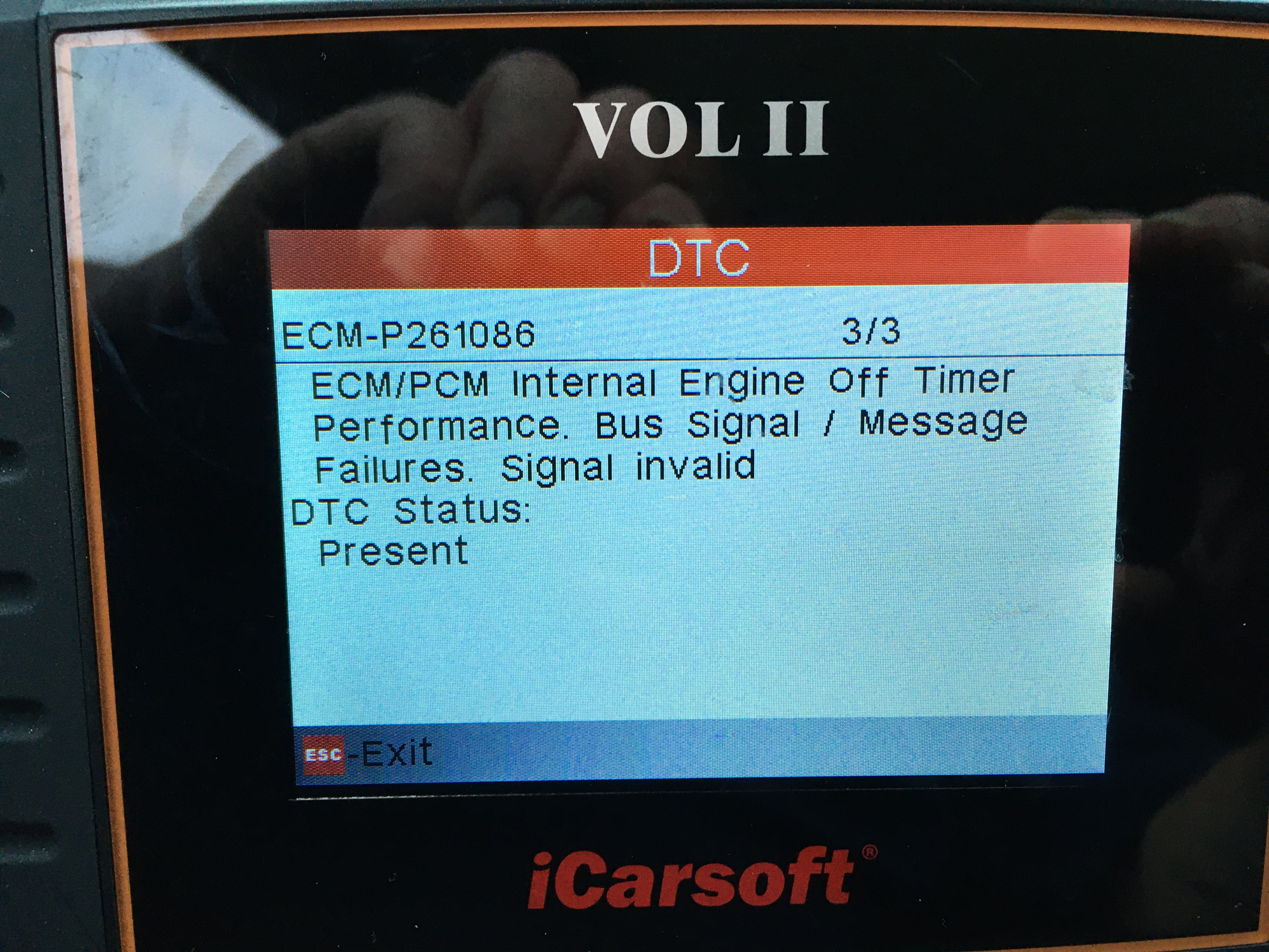

Update after learning how scan tool works
Sorry for the photo's the wrong way.
These readings were after a 15 minute run and the above codes where able to be cleared and did not return when rechecked.

ECM-P227200 O2 Sensor Signal Stuck Lean - Bank 2, Sensor 2. General Failure Information. No sub type information, B6324S5
Diagnostic trouble code (DTC) information
Condition
The engine control module (ECM) continuously detects the voltage of the rear lambda-sond (bank 2).
The engine's cylinders are counted starting with the cylinder farthest from the engine's flywheel.
If engine control module (ECM) detects that the voltage is not below or above a certain value, the engine control module (ECM) interprets this as a malfunction and generates diagnostic trouble code.
The diagnostic trouble code can be diagnosed after approx. 3-5 minutes with the engine running.
Substitute value
Rear heated oxygen sensor control is shut off.
Possible source
Fault symptoms
Warning lights and chimes/Malfunction Indicator Light ("Check engine" light) indication/no indication
ECM-P261086 ECM/PCM Internal Engine Off Timer Performance. Bus Signal / Message Failures. Signal invalid, B6324S5
