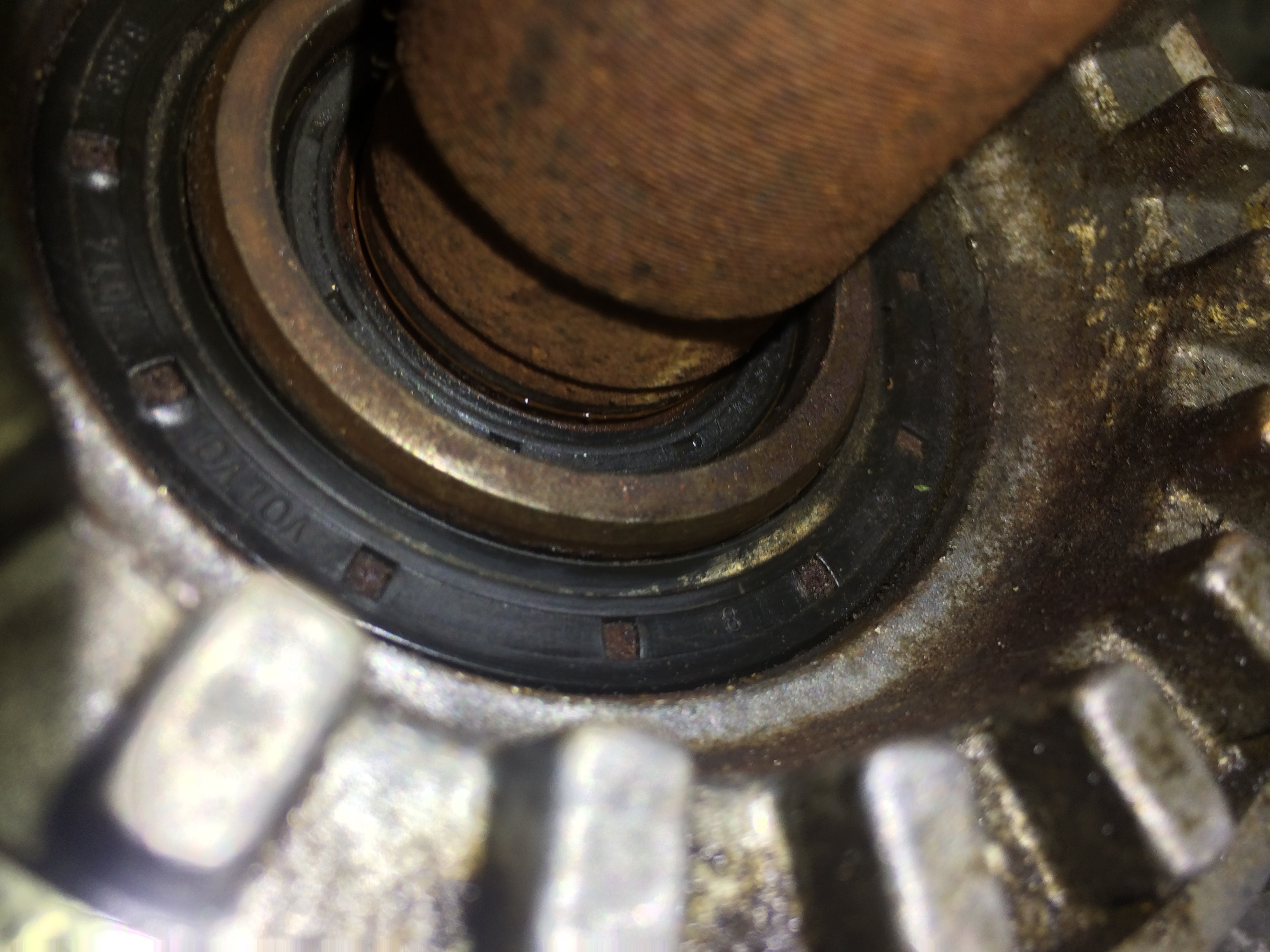

I have a 2006 XC70 and have been chasing a leak under my bevel gear for a while. I put dye in the transmission and used UV light to test for the leak. The fluid collecting in the belly pan seemed to glow yellow green under UV light so I thought it was tranny fluid. Then I discovered that regular bevel gear oil glows yellow green under UV light as well. I suspected bevel gear oil because it has a unique sharp odor if that makes sense.
After a thorough cleaning and checking after a short drive I've located the leak at the crown gear adjustor nut (the one with the knobby exterior teeth). The two seals, inner and outer appear quite dry! The left corner of the included picture represents the six o'clock position of the bevel gear and adjusting nut. It's cleaner than the rest of the area because it was previously wiped dry before test drive. But just below this area it was very wet with what I now know is bevel gear oil.
From diagrams it looks like there is an o-ring behind this huge nut. Is it as simple as taking this nut off and putting in a new o-ring. Or am I in for new inner, outer sealing rings as well.? I did find a link to changing this these parts but wanted an experienced opinion. Thanks!

I've cleaned this thing a number of times. The leak in my opinion is significant and doesn't appear to be coming from the angle gear seams but from between the pre-load adjuster nut and the angle gear housing. As my picture shows the outer seal looks quite dry but the side of the angle gear below was quite wet (no picture). I have 75-90 Mobil Syn in there right now. Is it possible for the adjuster nut o-ring to leak so badly without having a bad outer seal? My understanding of this anatomy is limited. BTW what is "NOT Barr."?

The tabs on that end cap/adjuster are fragile so no drift and hammer use here. There is a special tool disc with 1/2 square drive and a series of roll pins drive in that engage the tabs The leak in salt country can be due to corrosion which makes getting adjuster out and can cause the adjuster or AG case to have pitting that makes a new O ring not fix the leak. The adjuster is turned in until the free play is eliminated and then two notches more for bearing preload. All of this requires removal of the AG to assure cleanliness and access.
So there are two ways to go: 1. remove AG, pull adjuster out and reseal and hope no corrosion and it stops leaking. 2. blow out the full circle gap between adjuster and case, degrease it with a few brake cleaner spray and air blower treatments, use a small brass or stainless brush and clean the case-adj gap, then seal externally with grey high torque/extra hard RTV sealer. Effectively caulk it to seal it. Sounds low class/low tech but sometimes the dismantling proper repair carries risks that make that approach unwise when it is an oil leak. Oh, this external technique is sometimes used as THE method. Volvo 3.2/3.0T engines have a shaft end that sticks through the drive gear case for its cam and accessory drive system. That shaft is sealed from possible leakage but a thin steel disc that is slathered with RTV and pushed into the shaft end so that the RTV glues the disc to the shaft and the case metal that circles the shaft. Not the only place a manufacturer has used low tech/easy/low cost solution effectively.

Ok, great advice. I am not motivated to removed the AG! I had the axel out the other day and replaced the inner seal (cause I had one), it didn't solve leak. I do have that adjuster nut removal tool on order (33$) and was prepared to go that route. I think I'll double check AG fluid level and top it off for now. I'm in salt country, so maybe the RTV solution is where I'm at. Thanks for the practical alternative route!!

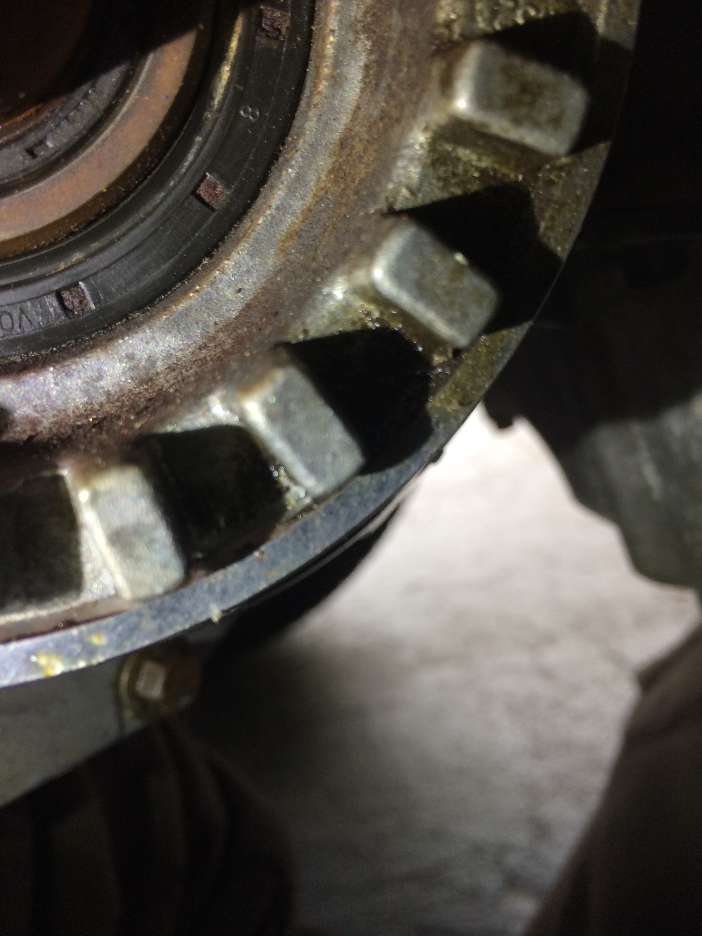

I once again crawled under the car and removed belly pan to look a Angle Gear. As expected it is wet with oil. Added a couple ounces of fluid to be safe til I decide whether to open up the adjuster nut and replace oring and outer seal. All original with 160k.
Included a picture showing small drips ( yellow drops at bottom left) from adjuster nut and Angle Gear housing seam. Seals were dry (just a little wetness from grease I used on the new inner seal the other day). Just a little drip but the whole bottom side was wet and fluid collecting in belly pan.
Does anyone have experience with the technique described in the link I posted in previous post. (hope its not frowned apon to link to another site!).

Your AG doesn't look terribly crusty so you might be safe from the corrosion and the scary stuff for the adjuster removal.
If you do the O ring for the adjuster then I would do the seals while the cap is out as in the car R&R of that seal is not nice as you likely already know. If you do remove adjuster bathe the gap between it and the case with wd-40 or similar to float all the crap out. The adjuster has a great tendency to bind up for debris in that area.
