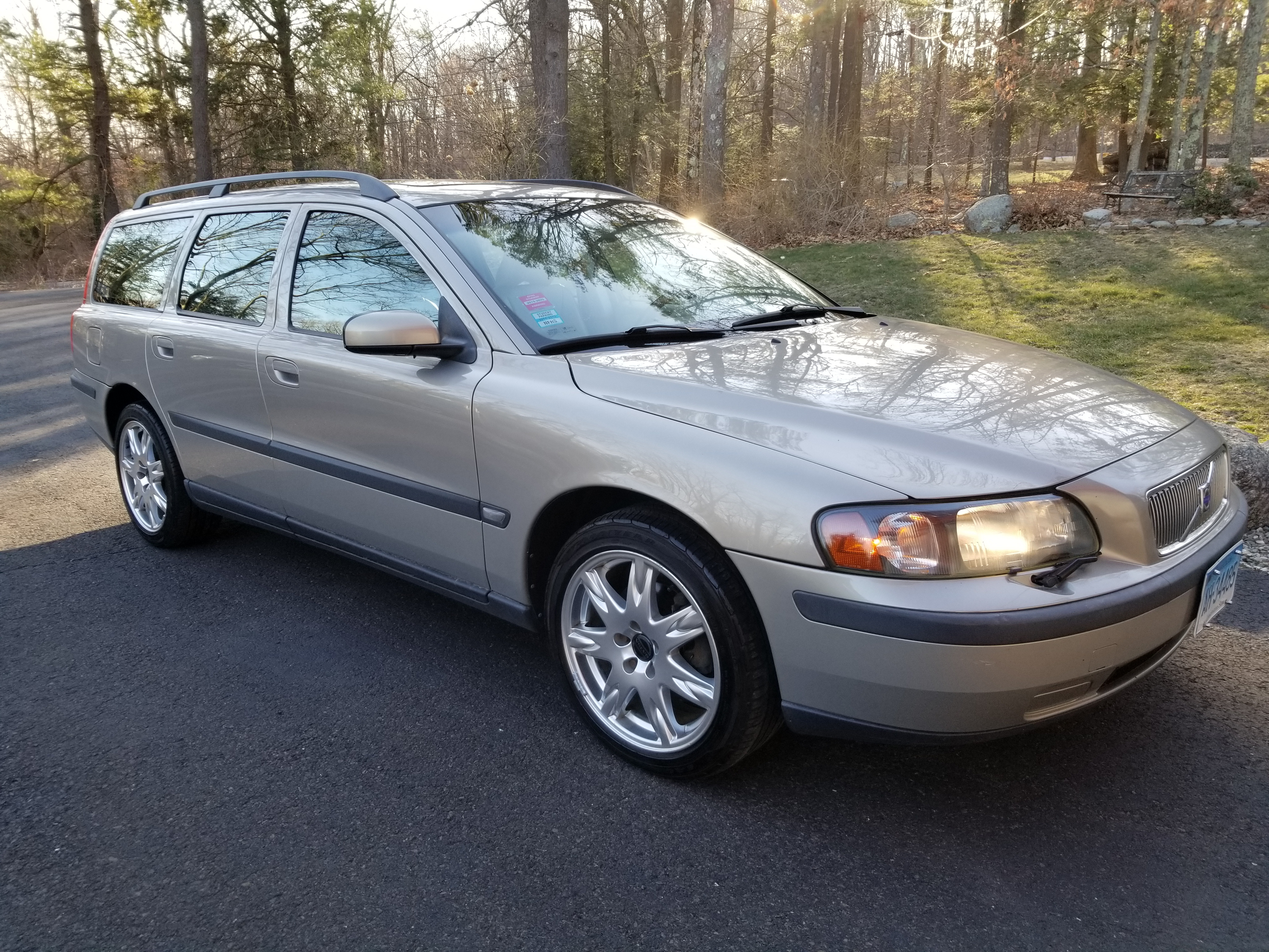

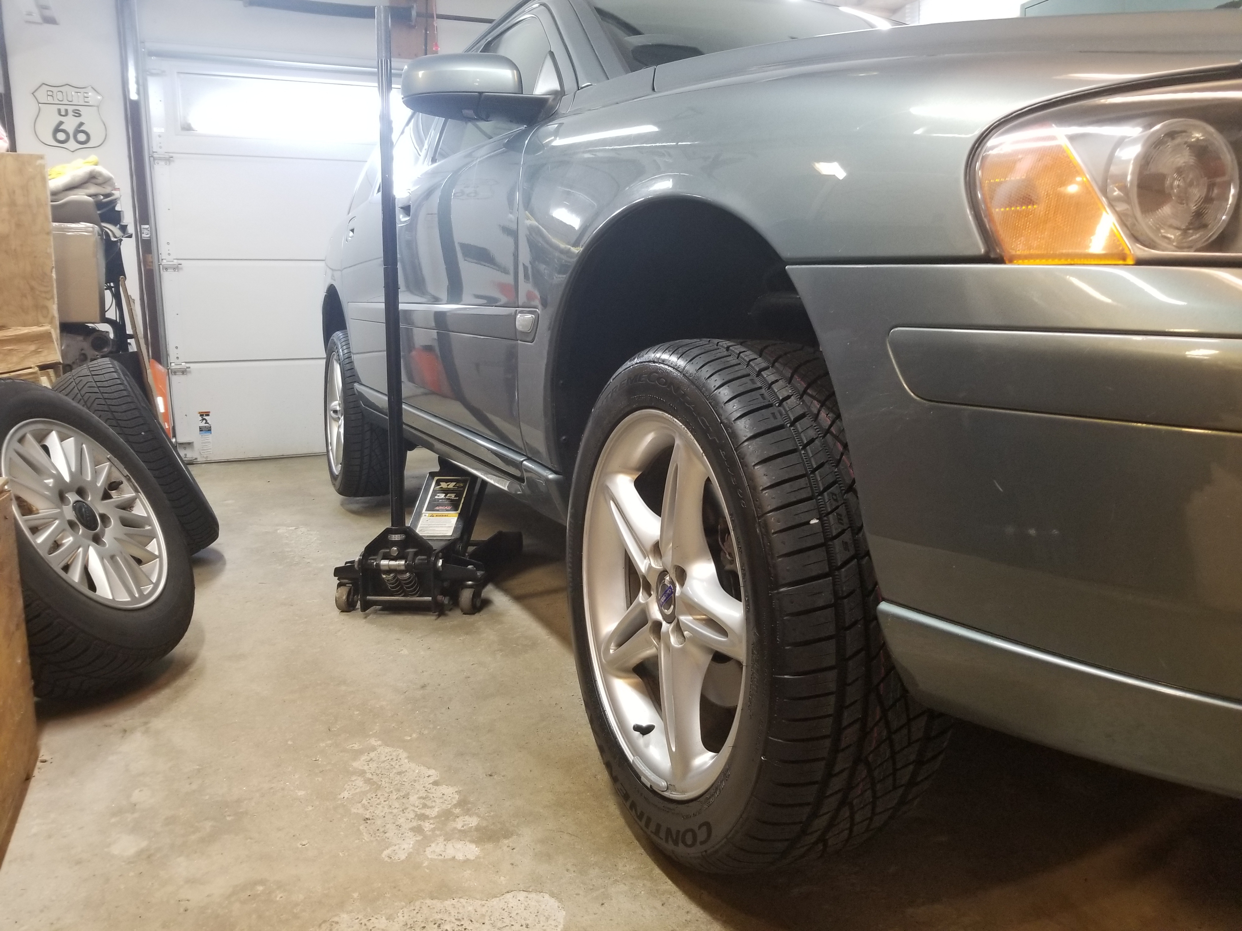

Mounted the summer tires for the 04' and 05'

850 LPT wrote: 22 Mar 2020, 15:19 Mounted the summer tires for the 04' and 05'
Boy the tan one is in good shape (I have the same thing, but slick top & auto AWD, and not as nice). Way to go! To you and your daughter. Is it T5? Nice job to both of you on keeping the Thor's away from curbs :) Mine have encountered many curbs.

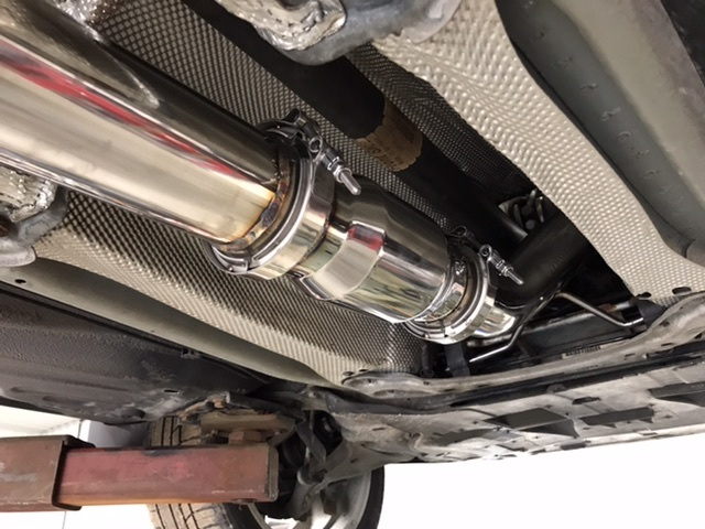

I did nothing Volvo task-related today, but did enjoy the new sounds reverberating from the tailpipe of our 284k XC70.
Catted this time
Catted this time

Oh I have been, for a while now. That’s not the first DP for me. Lovely music coming from behind & minimal drone with the resonator delete on the adapted/harvested part-out R-exhaust.

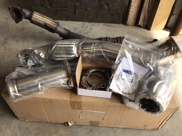

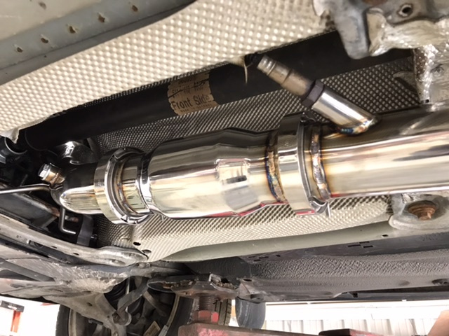

“Dan”, as our 4-year old calls it (04 V70AWD), got a present today. If anyone has questions about this DP, let me know.

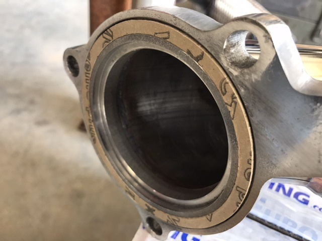

Of the different DP’s I’ve purchased & installed, this is by far thee nicest. I’m talking welds, material, gaskets, packing, versatility of a 3-piece DP, quick response time with EuroSport tuning staff/owners...I’m truly impressed. This absolutely blows the Snabb & RE-VOLVO catted or catless DP’s out of the water.
3 bungs (you’ll need a plug if you’re not running a wideband), perfect TIG welds, true (and beautiful) T304 SS pipe, v-bands, flanges, everything. This is a very inexpensive system & they ship it same day. Not waiting for the welder to jig & fabricate the system. I ordered this Tuesday, shipped same day from Ontario, delivered & installed it today (Friday). Ahh-mazing.

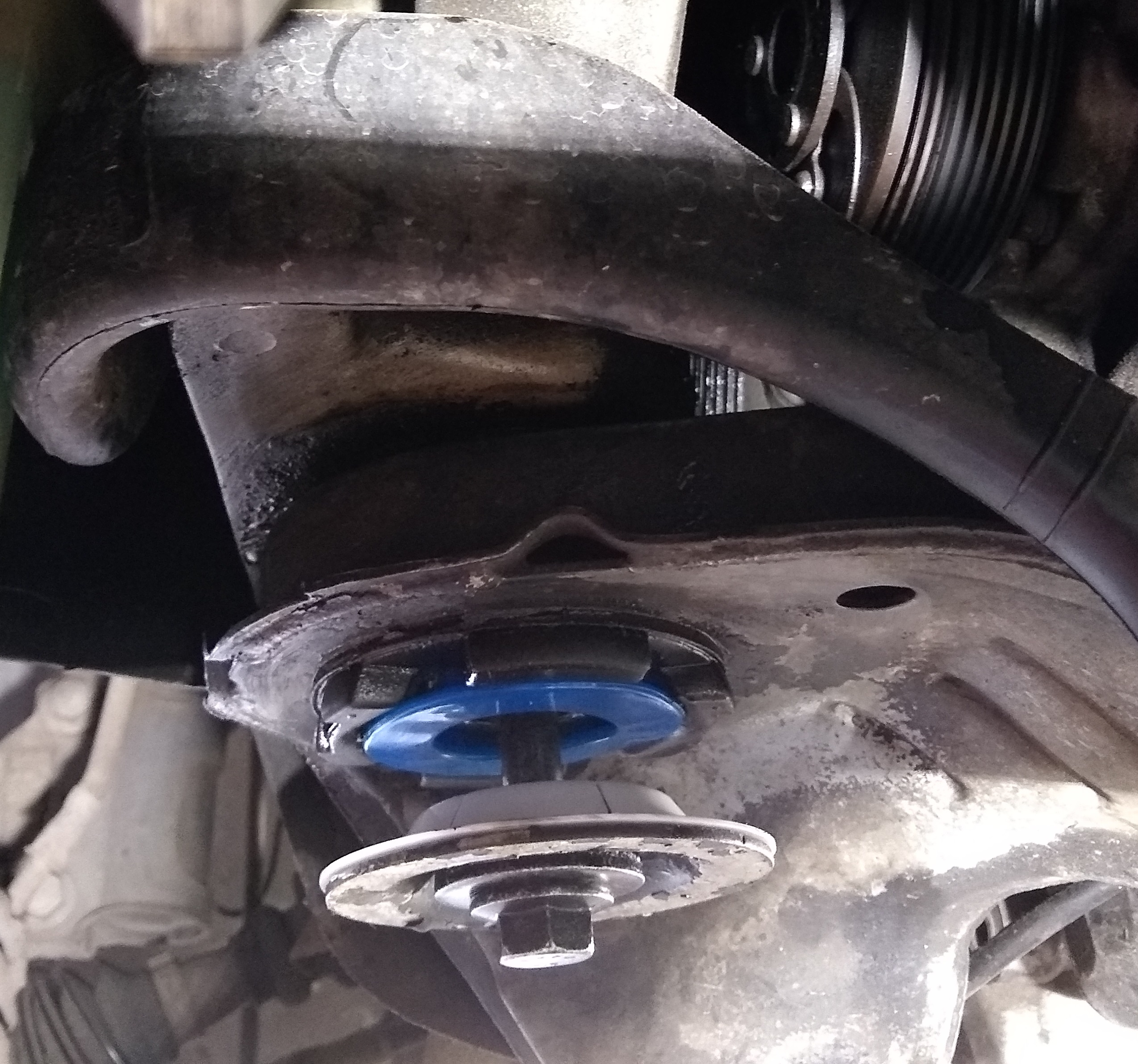

Installed these yesterday.
IPD Poly Front Subframe Bushing Insert Kit - 3507923
https://www.ipdusa.com/products/8969/12 ... 68-3507923
Genuine Volvo - Subframe Bushing Washer - P80 P2 S60 S80 V70 XC70 XC90 - 31329447
https://www.ipdusa.com/products/8859/12 ... o-31329447
MTC - Subframe Bushing Bolt - 985111
https://www.ipdusa.com/products/20815/2 ... 1453,P8283
MTC - Subframe O-Ring - 8638585 - Purchased MTC but Volvo's O-Ring link describes purpose of part
https://www.ipdusa.com/products/8283/11 ... 283,P20815

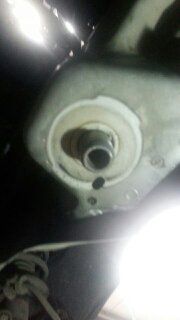

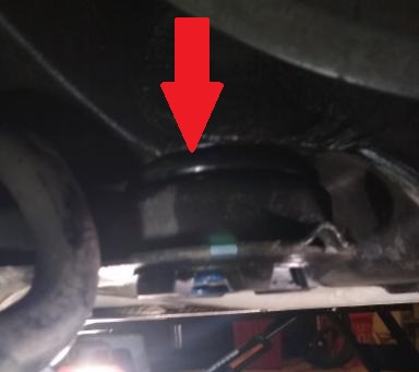

Was able to use the old bolts, metal washer / plate and the impact to drive the inserts in. The rear driver's side insert needed a socket extension with a jack underneath to more precisely push / squeeze it in. Probably a newer bushing. I also sprayed the subframe bushings generously with the AT-205 and it made the job harder as the rubber surfaces were rejuvenated.
If I had to do this over I would start by loosing all 4 bolts and do the insert on the driver's side rear bushing first. There is a guide pin (last photo borrowed from Swede Speed - Link Also) which the other 3 did not have. With the other 3 done first the subframe was tight and I could not flex it down enough for the O-Ring to go over the guide so had to loosen the rear passenger side again to allow the entire rear subframe to come down far enough with a large pry bar. Maybe this is why in IPD's video they show doing the driver's side first :?
