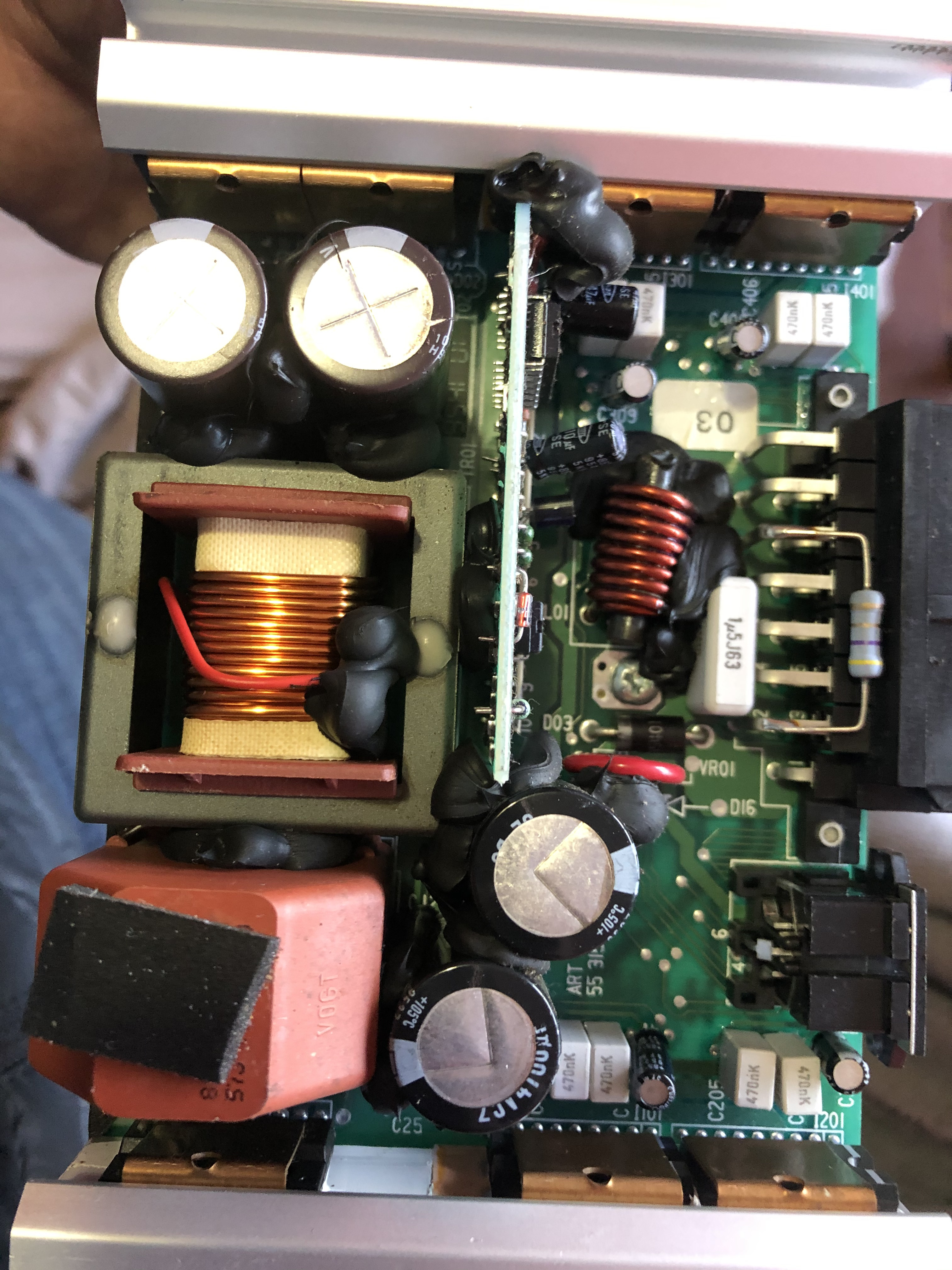

I've attached a picture of the circuit board for the amp but couldn't find anything obvious. Any ideas?

So it still comes back to the same 2 issues. 1) The amp is bad and has a failed component and an internal short, or 2) The extra load the amp pulls over the SC-901 (which as no internal amp so it pulls a low current) is causing a short to manifest somewhere else in the harness.
I have little to no knowledge on what to look for in the amp, so I return to my suggestion of seeing if you can find a more basic radio which has the built in amp and see if it fails again. I pick up basic versions of the radio at junkyards for about $15 CDN. I appreciate that in CA it may be difficult to get out these days to get one though. I know my brother lives in Santa Rosa, and the Pick n Pulls around there used to have several older Volvos in there as he pulls parts for his 97 850.

Given that this failure is semi-common, my guess (!) is the amp. But good suggestions from Neil to just to rule out the harness - test with another unit or just hook up a load to the amp power supply.
Someone was posting up to offer repair of the amps, I will see if I can find the post ... here it is viewtopic.php?f=6&t=91782. Maybe contact him and he can tell you where to look in the amp. Or send it to him.
