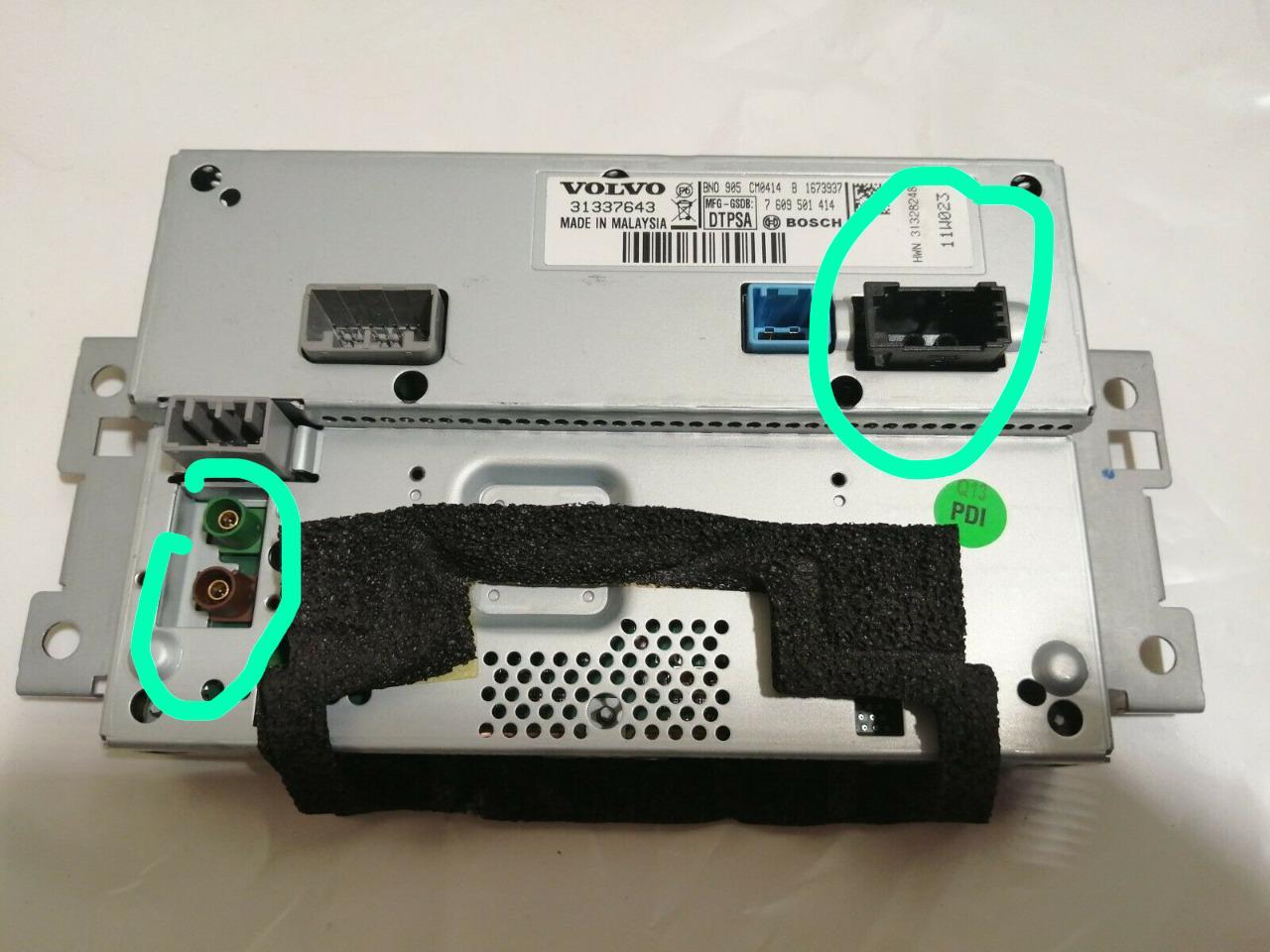

he mentioned it is these cables
Hi, so i have replaced the ICM display recently , and it worked for like 10 sec then it switches off, it happened quite a few times when i want to use the car.
The workshop i went to, that helped replaced mentioned , it is probably the cables cos they have tried to play around with the cables and it worked for a while. then they installed back, and again it worked for like 10 secs then it switches off.
My question is, is it really the cable?and if it is whats the name of the cable items?

Perhaps worth getting multiplier and see if there isn't a drop in voltage on the cable?
Maybe Theft protection for most needs taking off. Your screen looks completely different to what i got i only got two cables in vidoe (blue) and power.
The Theft protection works in the way that it shut down the unit after 30 second if the serial number does not match with the CEM but it should display in VIDA the error message.
For example in my case replacing the screen does not make any difference probably because it's just display for me.

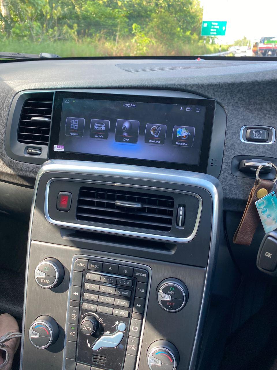

Update :
Since previously i have ICM problem so i bought a replacement ,a used unit, and screen only appeared for 10-15 secs and went blank and no audio as well. So i decided to replace it with an android player. However, it did the same thing, except the android screen works but there is no audio after 10 secs or less.
What could be the actual problem? were really scratching our heads
