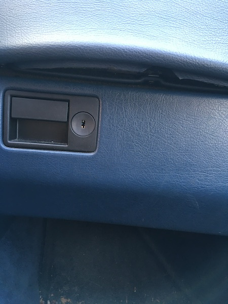

My dashboard peels off above the glovebox. Is it possible to find a tutorial on the site to repair it ?

Hi Manov, good to hear from you. Just to clarify, the part that you want to repair is just above the glove box. Is it part of the removable dash top or part of the lower section of dash? If it is the upper part near the airbag part, it may be easier to find a better one and replace it. That is not a huge job to do.
A picture would help if you can.

Here's the picture.
It doesn't seem to be a huge job to glu back, so if any idea ...

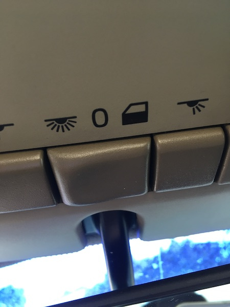

By the way another question : can someone tell me to what correspond the button on the "door" position ? My battery downloaded very quickly recently. Could the button on the "door" position may have been the source of the fact state ? Much Much Thanks

Door position means that the lights will stay on if one door/the hatch is open so it could discharge your battery.

Yes you're right. A little search in the car manual... Sorry for the stupid question... It also means that i have to check out connexions .

There is no cure for dashboard except to replace the whole upper section.
It removes easily and goes up in one piece.
The problem is that....even a replacement will in time become like the old one.
That's the problem with early covers (up to '96 for EU market cars)without passenger's airbag.

So, i need to find another one, from 96 with an airbag passenger , The car is dark blue, i would be please if i could find a beige interior full leather...

Passenger's side airbag will not be active since the car is not originally equipped with it.
You can remove it completely and install the dash without it.

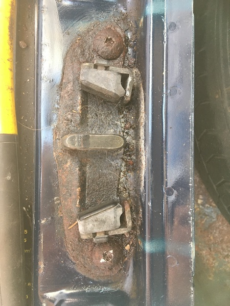

I have another question : how to solve this one ? Rust on bolts. Drill make a mark on the bolt head and try to unscrew ? I woulmdn"'t like to heat the bolts because the tank is near... Thanks.
