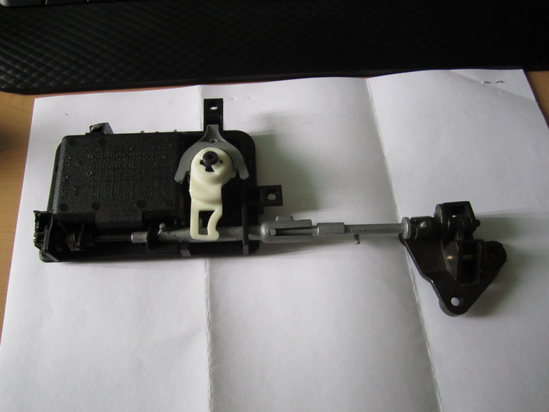

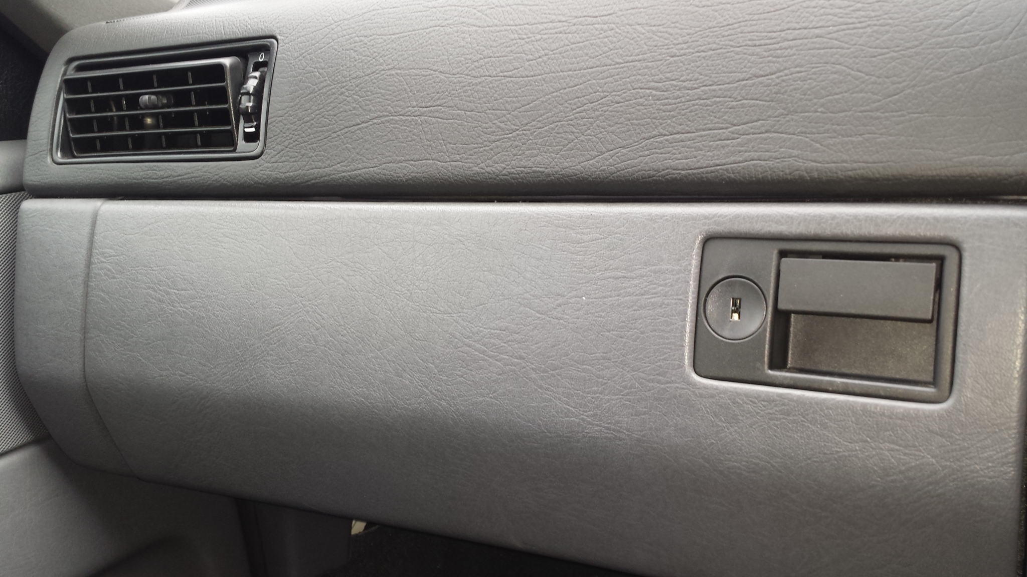

A long time ago I removed my damaged glove box, as I had damaged it when the lock broke and recently I purchase a replacement AND it came with these 2 parts (that I had too! from when I took mine apart).what are they?
If I can solve this, I can then add a pictorial of my modifications that now allows me to open the glove box even with it locked!
1995 850 Glove box parts

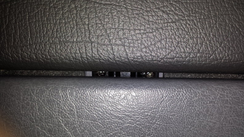

Hi Adrian,

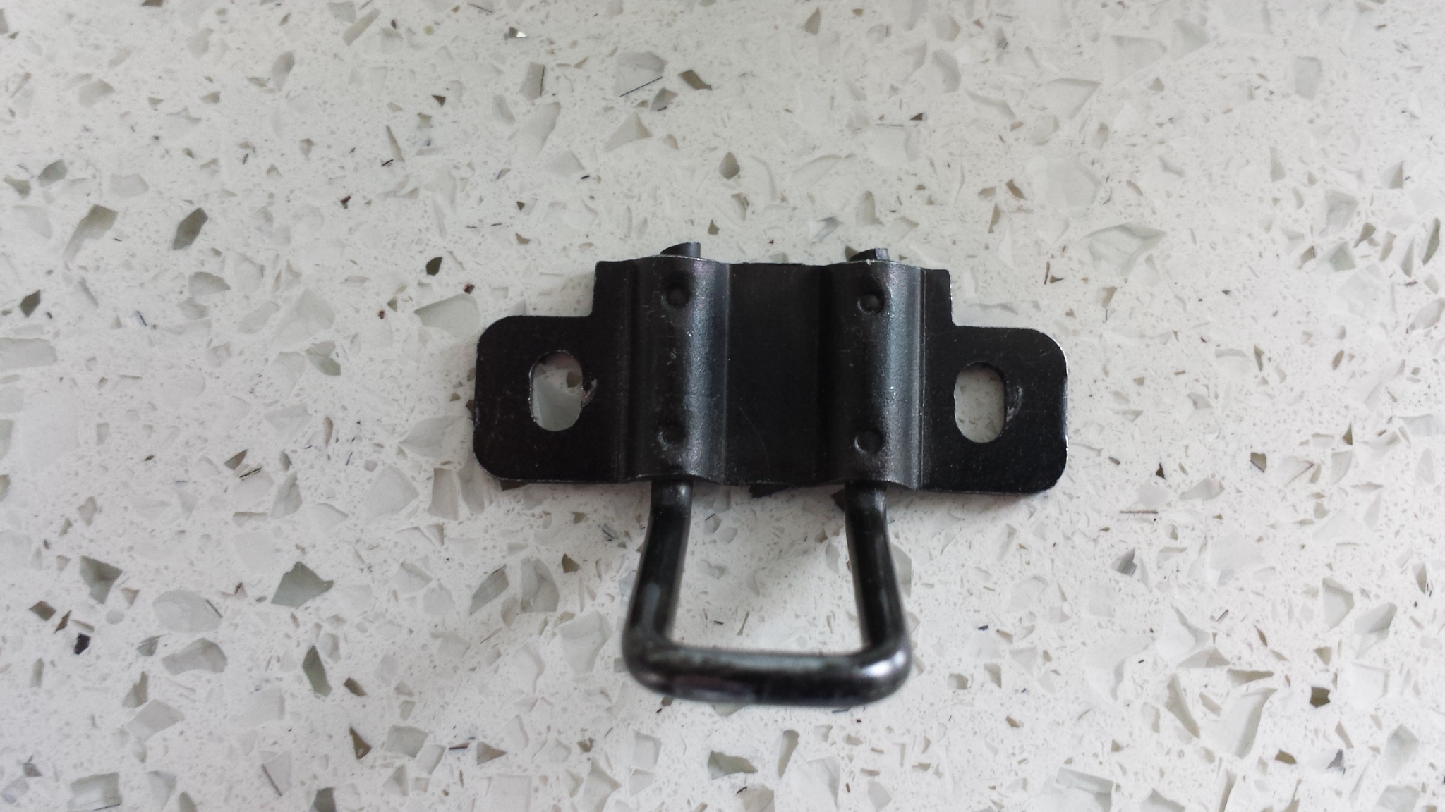

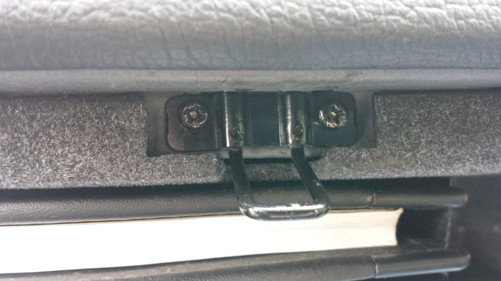

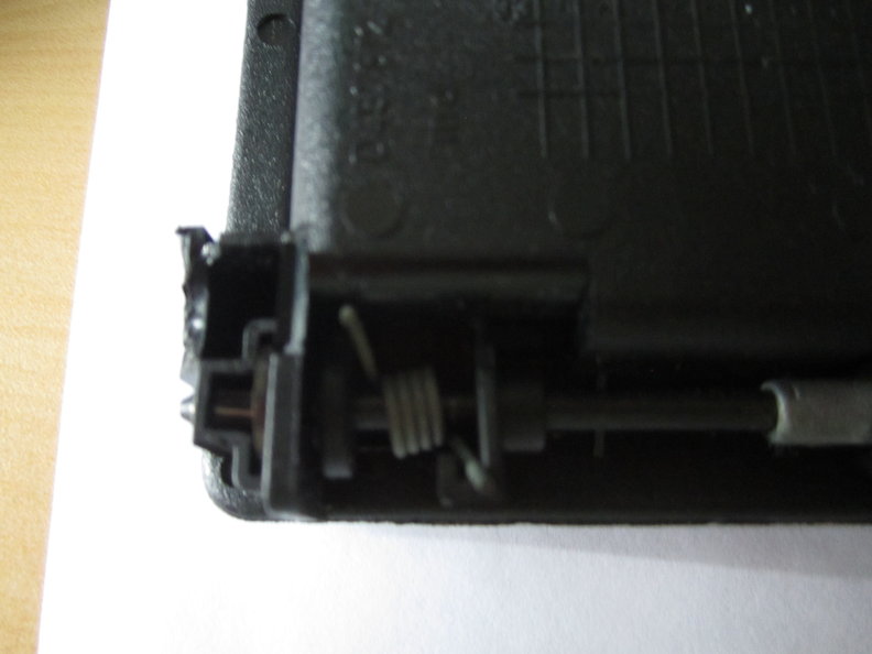

Unfortunately, I don't have an 850 to go and pull apart any more, but I did find a bunch of left over parts and have cobbled them together (as best as I can remember) and attached photos that hopefully answer your questions. It was a long time ago since I did this ( > 1 week with my memory!) so the layout should be close.
adrian1956
- Posts: 8
- Joined: 17 August 2009
- Year and Model: 850 1995
- Location: Coventry
Brilliant!! I now know where the pin fits..it is in the second picture, I just need to understand which way the sprig wraps around it...MANY thanks.

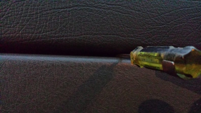

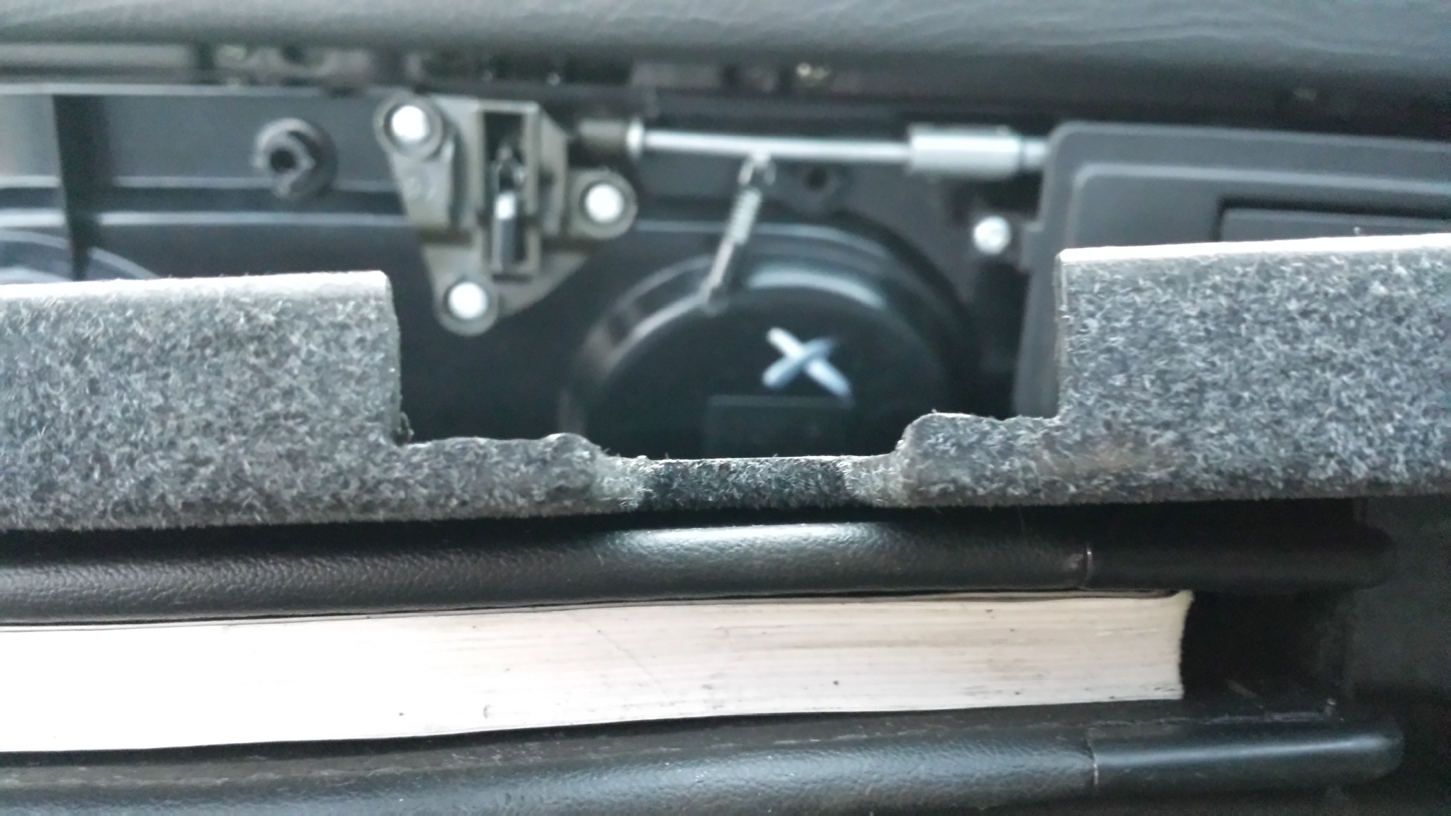

The ability to NOT to destroy the glove box lid IF the lock pin fails again (I have a VERY original VERY OE 850 that took me 8 months to find another glove box!) with a two minute mod that when it done it all 'LOOKS' as it should, but still allows you get the glove box open.
adrian1956
- Posts: 8

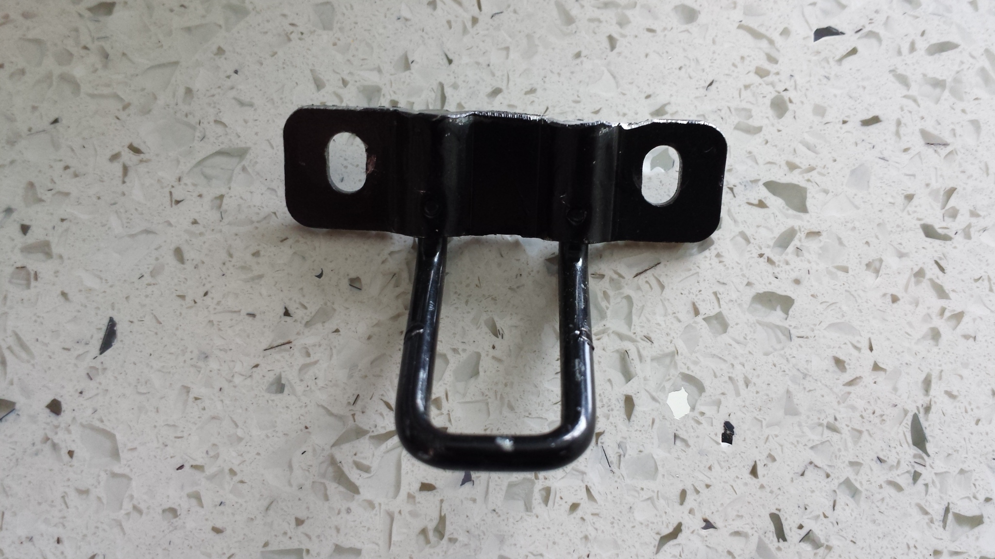

When I modified the hook to allow it to pass under the dash top, I welded the back of the hook, but that was a bit over the top.
