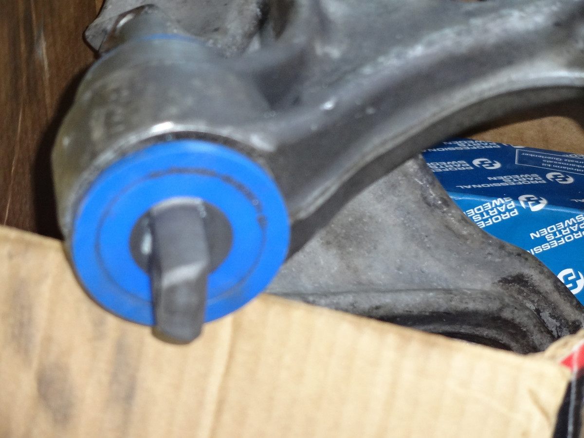

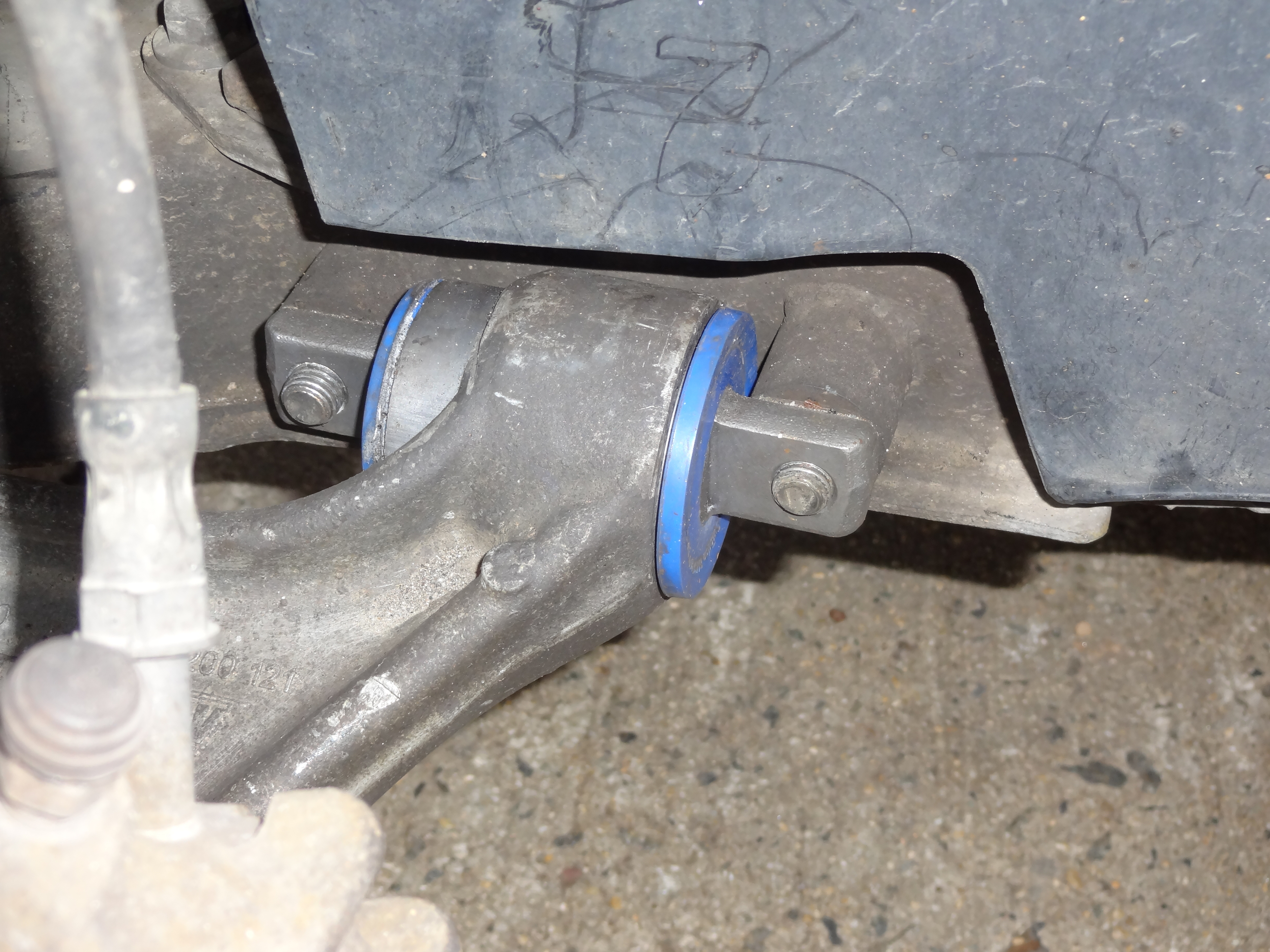

The poly bushings I had pressed into my control arms remains the BEST thing I ever did to a car.
Glad you shared!
How long in use?
No squeaks?
Which brand?
How about the LCA rear bushing?
I may be changing the bushings on the 03 S80 T6. Thanks.
