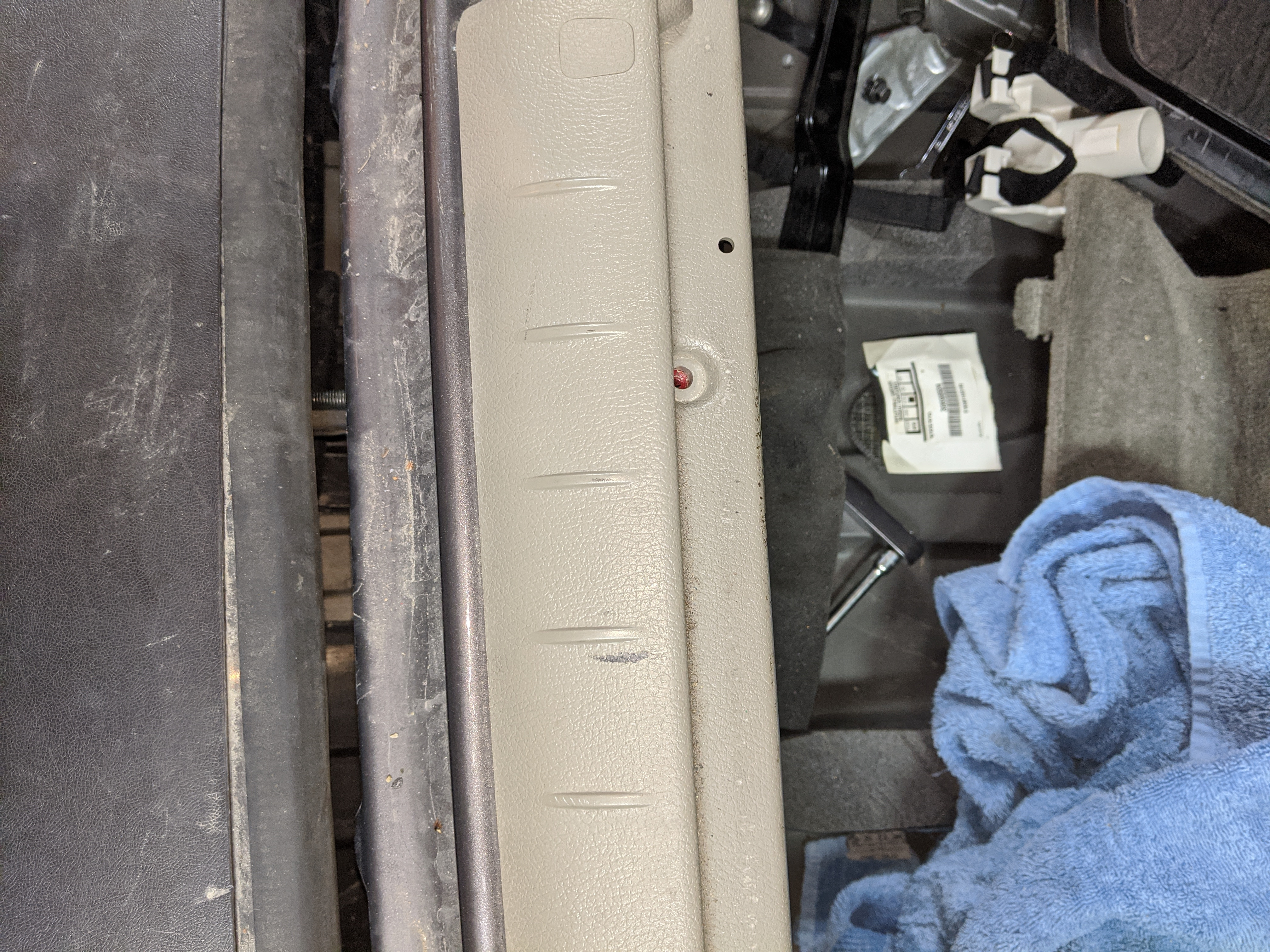

I've added pictures below if they help:
RH rear inner fender well where green box is
Green box in RH fender well.
Spare wheel well rear lip
LH bumper sensor wire into bumper
RH bumper sensor wire into bumper
Main sensor box in LH rear fender well
Help please!!!

For the connectors on the black box, they should be the kind where you can either push down with your fingernail/flat screwdriver on the yellow box. Or use a pick to lift up under the plastic tang in the red box. Then wiggle the connector out.
On the other side, can you get the (appears to be) 10mm bolt out to free the bracket?

Yes I have had that bolt out, but I still could not remove the RH end as there is a short (maybe 8-10") single black wire that runs out through the back panel into the bumper. Short of opening the box to see how it is held in there assuming the box can be opened) I can only think I may have to cut the wire and then maybe use a bullet connector for the future should it need to come out again. That is unless I am missing something?
