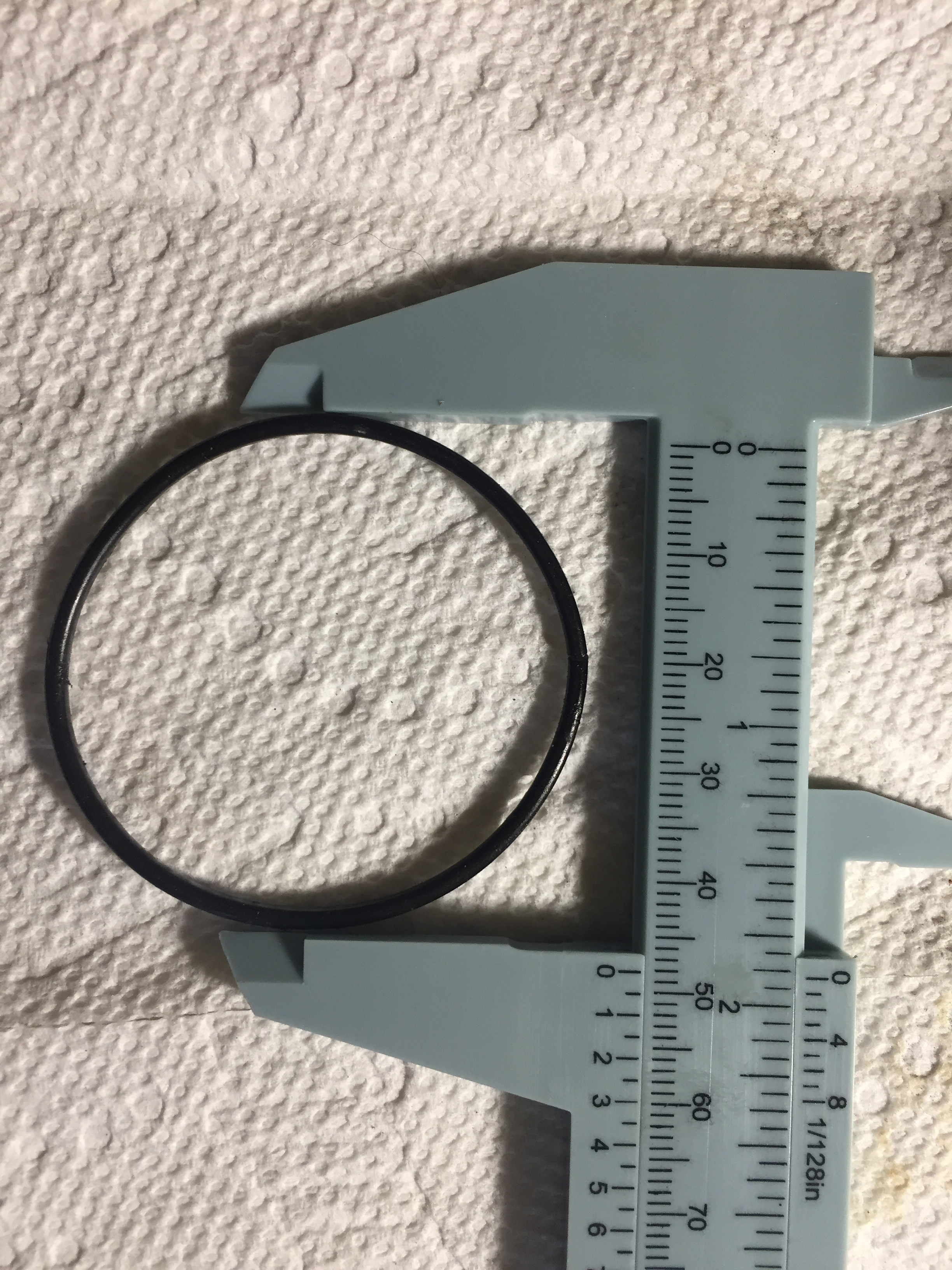

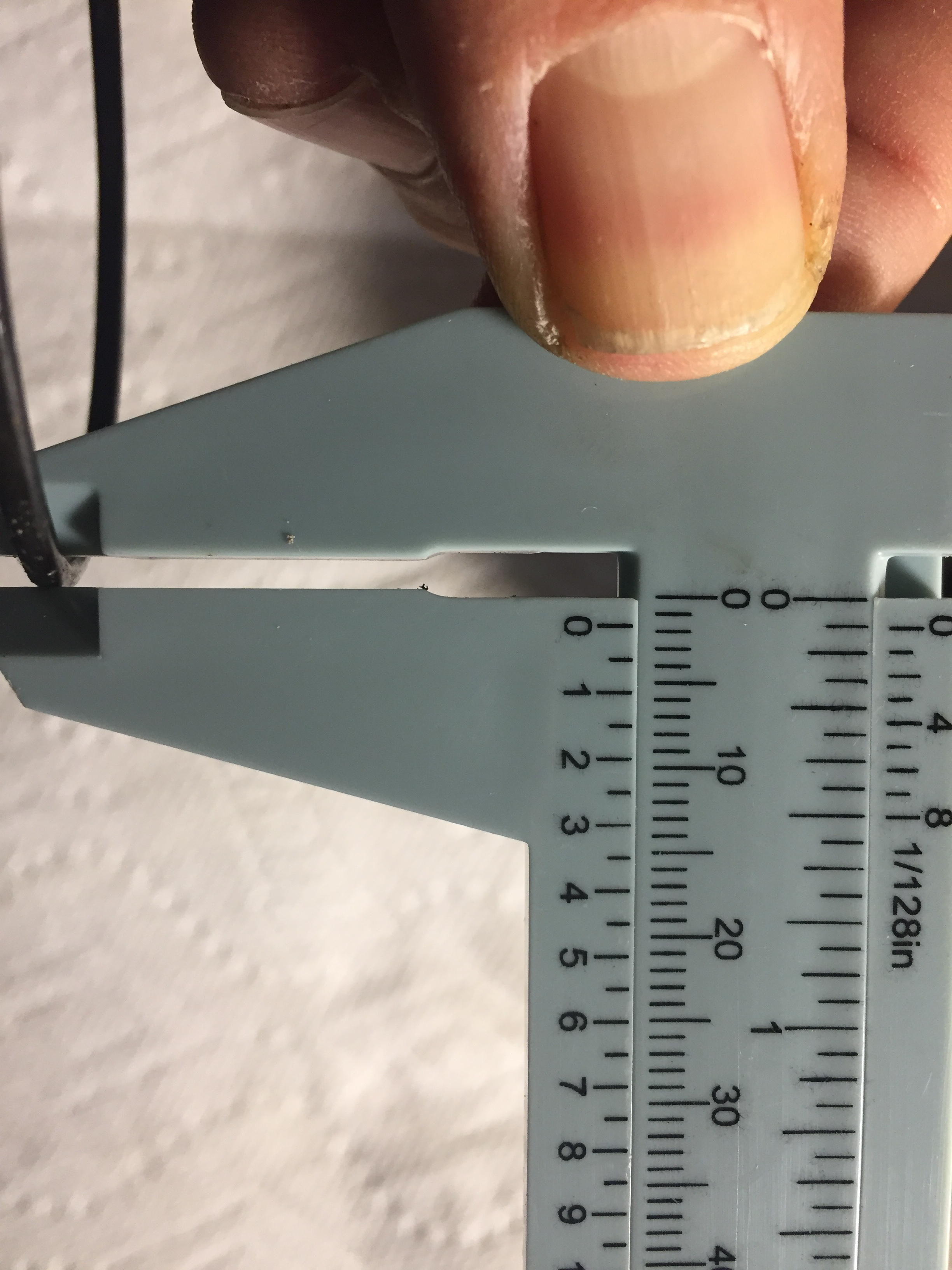

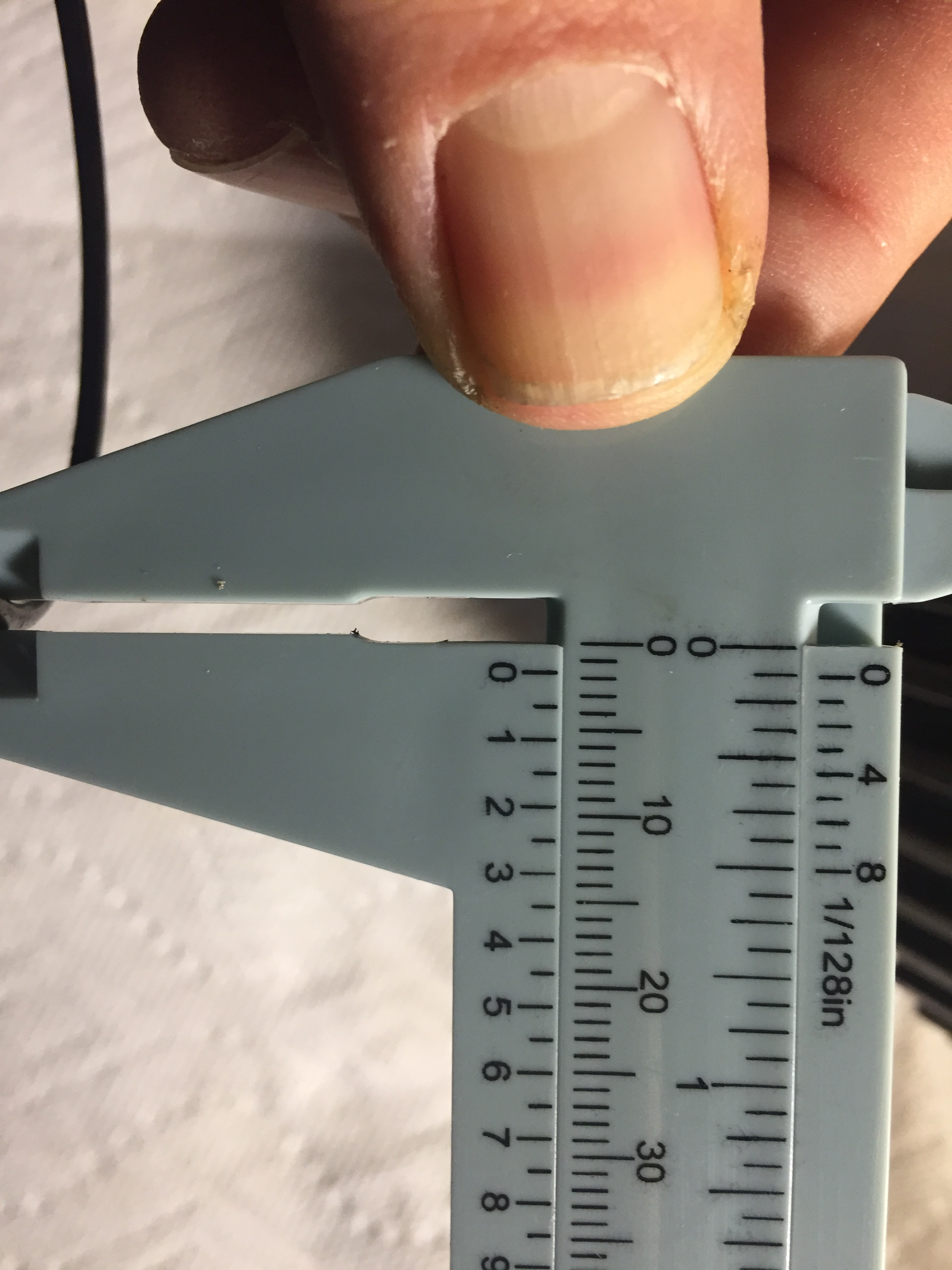

VVT inner bore (w/out o-ring) - 45.14mm
VVT inner bore o-ring channel - 1.65mm deep (I can measure width if anyone needs it)
New eBay o-ring CS (cross-sectional) width - 1.79-1.81mm
Old VVT w/old o-ring ID - 44.98-99
Cam end over which VVT/ oring goes 44.94mm
New VVT w/oring ID - 45.04mm - I believe the o-ring depresses a bit when opening the caliper, thus the disparity in mm between this & cam end measurement.
I took a measurement of the old VVT with the new o-ring but discarded it. On the old VVT w/new eBay o-ring I found the fit sloppy, ID/OD too small & CS width seems too small. I conversed quite a bit with the seller I purchased the o-rings from & they said the manufacturer must have sent out a batch of incorrect sizes. He apologized & then I was sent a refund from the manufacturer, not the seller. The seller I dealt with was very communicative, apologetic & quick to respond so I am not holding him accountable for the mistake. Also, I did speak with but have NOT ordered the o-rings from volvonest seller on eBay so can’t speak to their dimensions, fit, etc. The reason I included this in the thread is just to caution any DIY'ers about to throw on a set of new inner VVT o-rings. Test fit everything, use common sense, then proceed or halt.

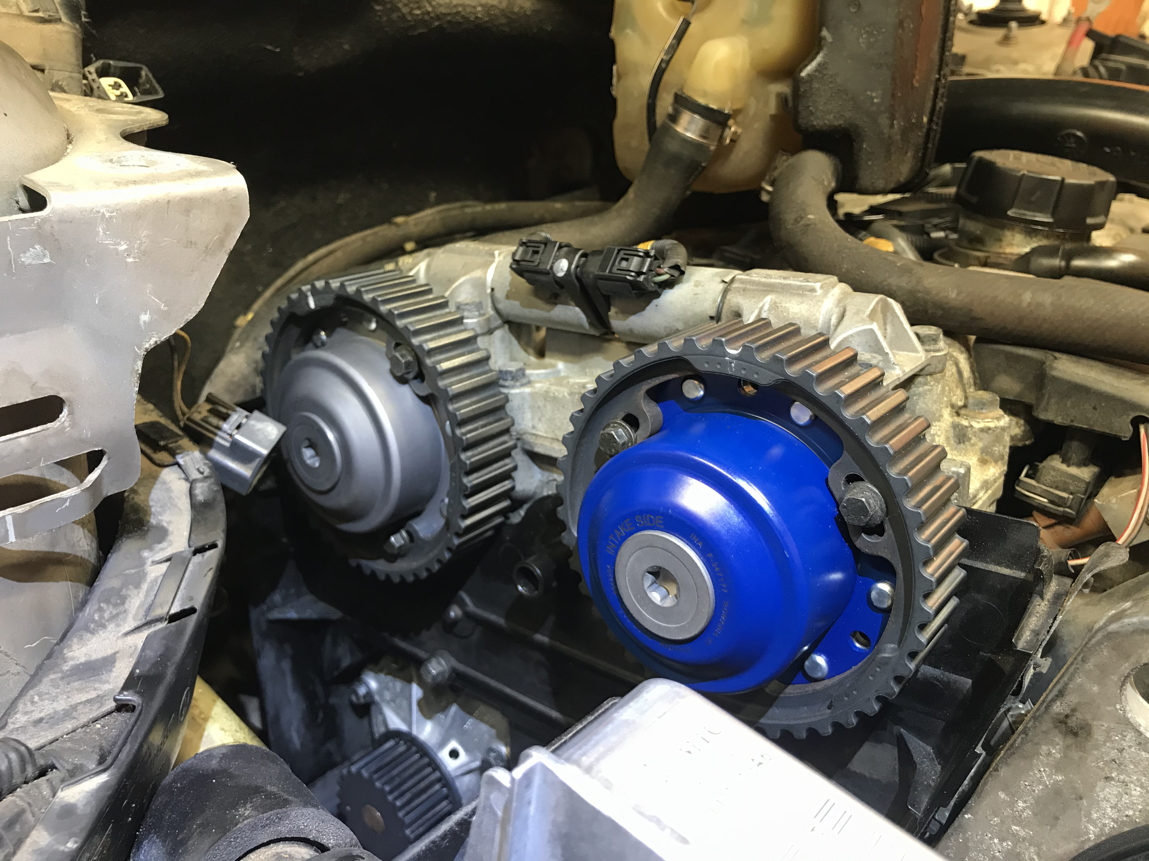

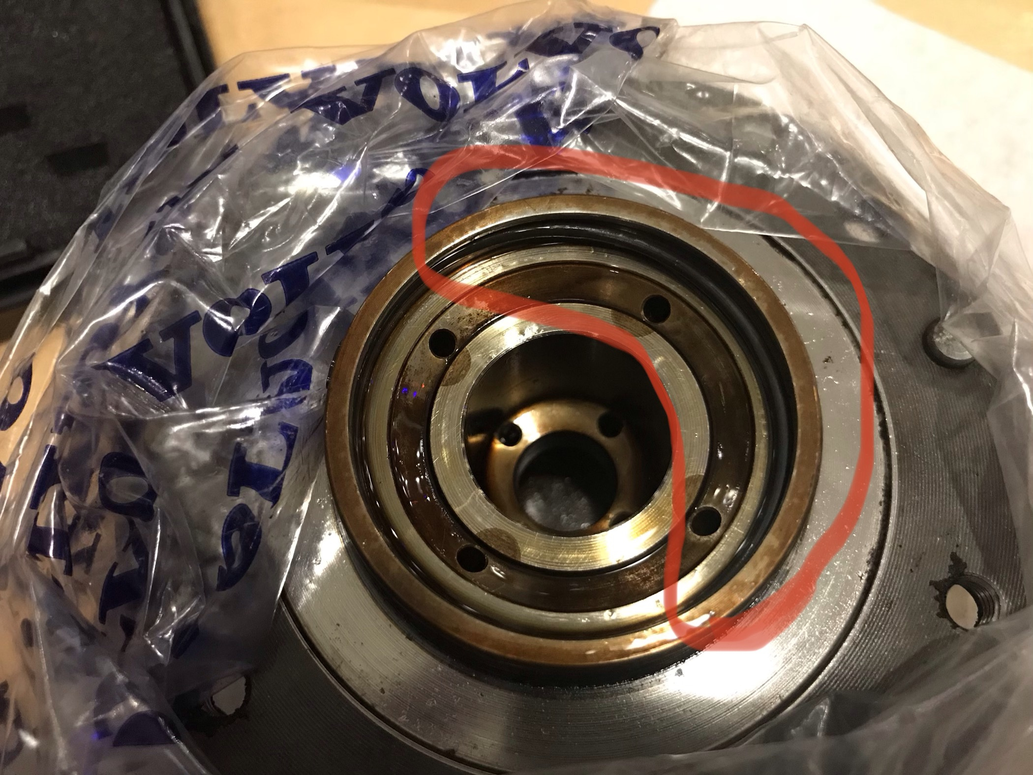

Both original VVT's were leaking from the inner O-ring & not leaking at the front cam seals like I had anticipated. It also appeared that the crank seal was leaking.
Cam seal findings:
Neither of the front cam seals showed any evidence of leaking. The only evidence of leaking could be traced back to the inner o-ring on both VVT hubs.

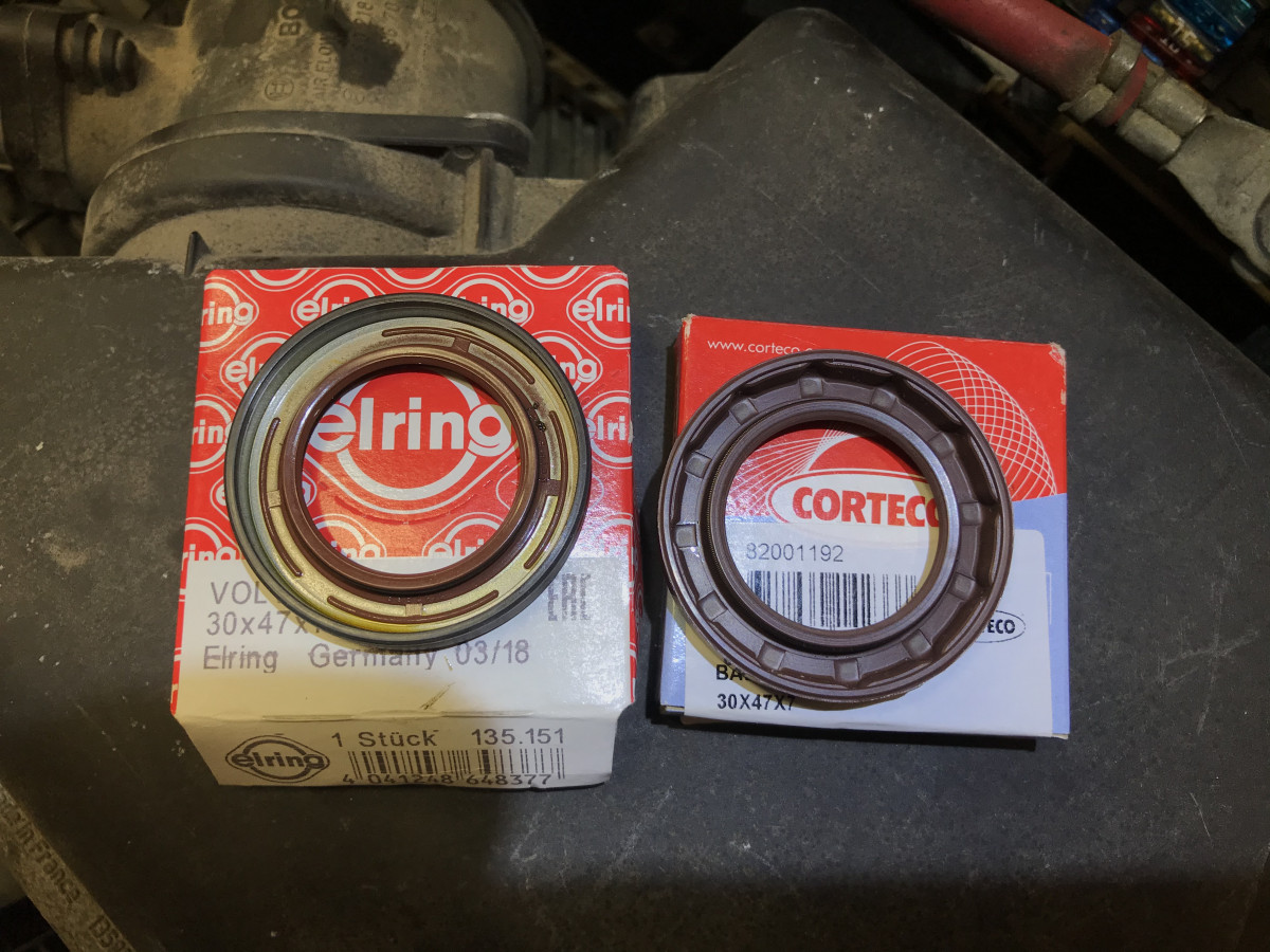

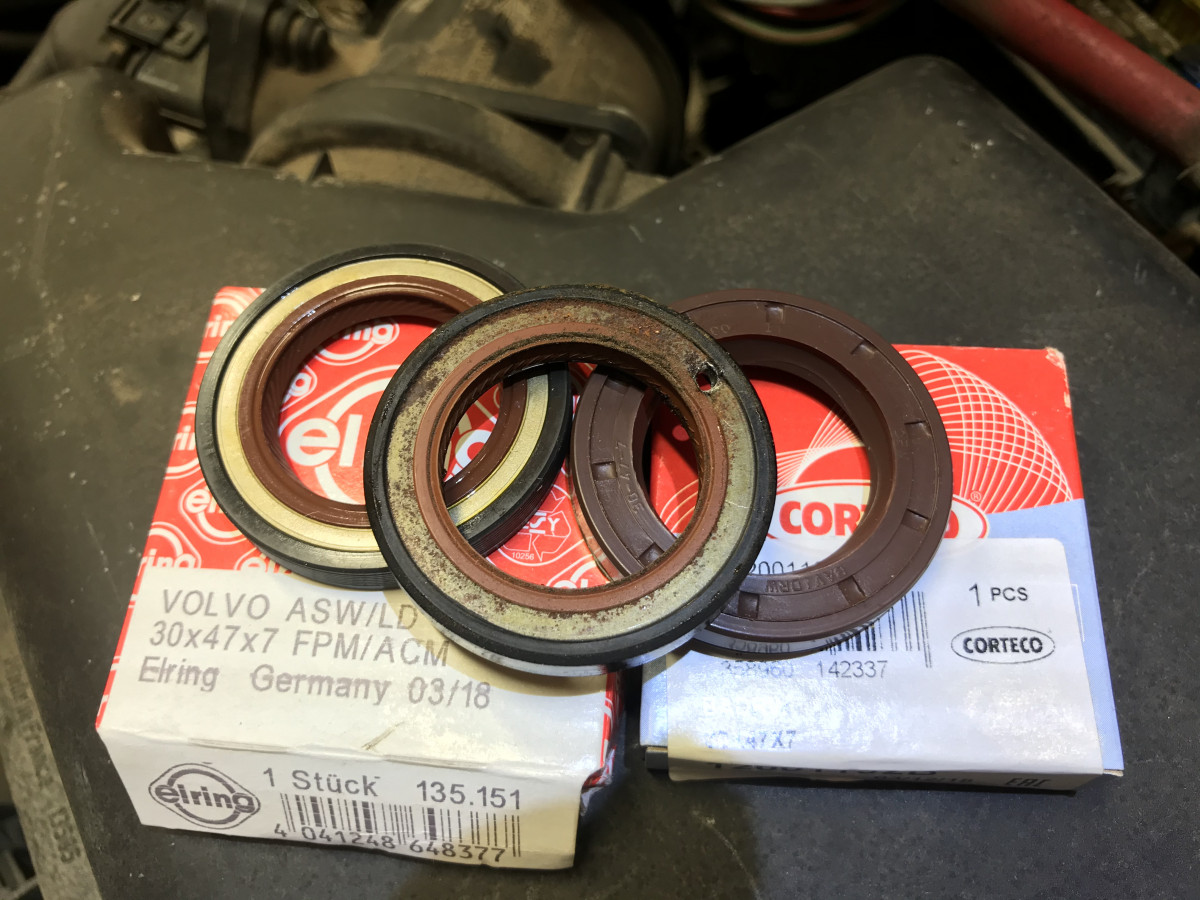

Only the exhaust rear cam seal had a very small leak. I replaced both. Elring on intake & Corteco on exhaust for “testing purposes”.

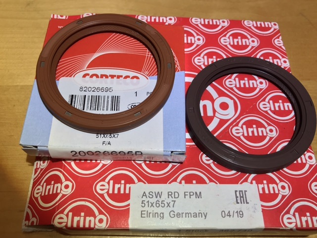

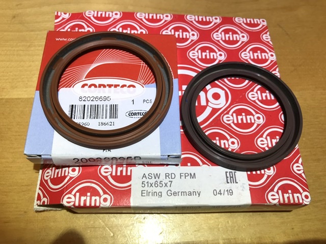

Corteco front cam seal
ID - 49.41mm - 49.31
OD - 65.33mm
Thickness - 7.00mm
Elring front cam seal
ID - 49.69mm - 49.57mm
OD - 65.14 - 65.34
Thickness - 7.05 - 7.12mm

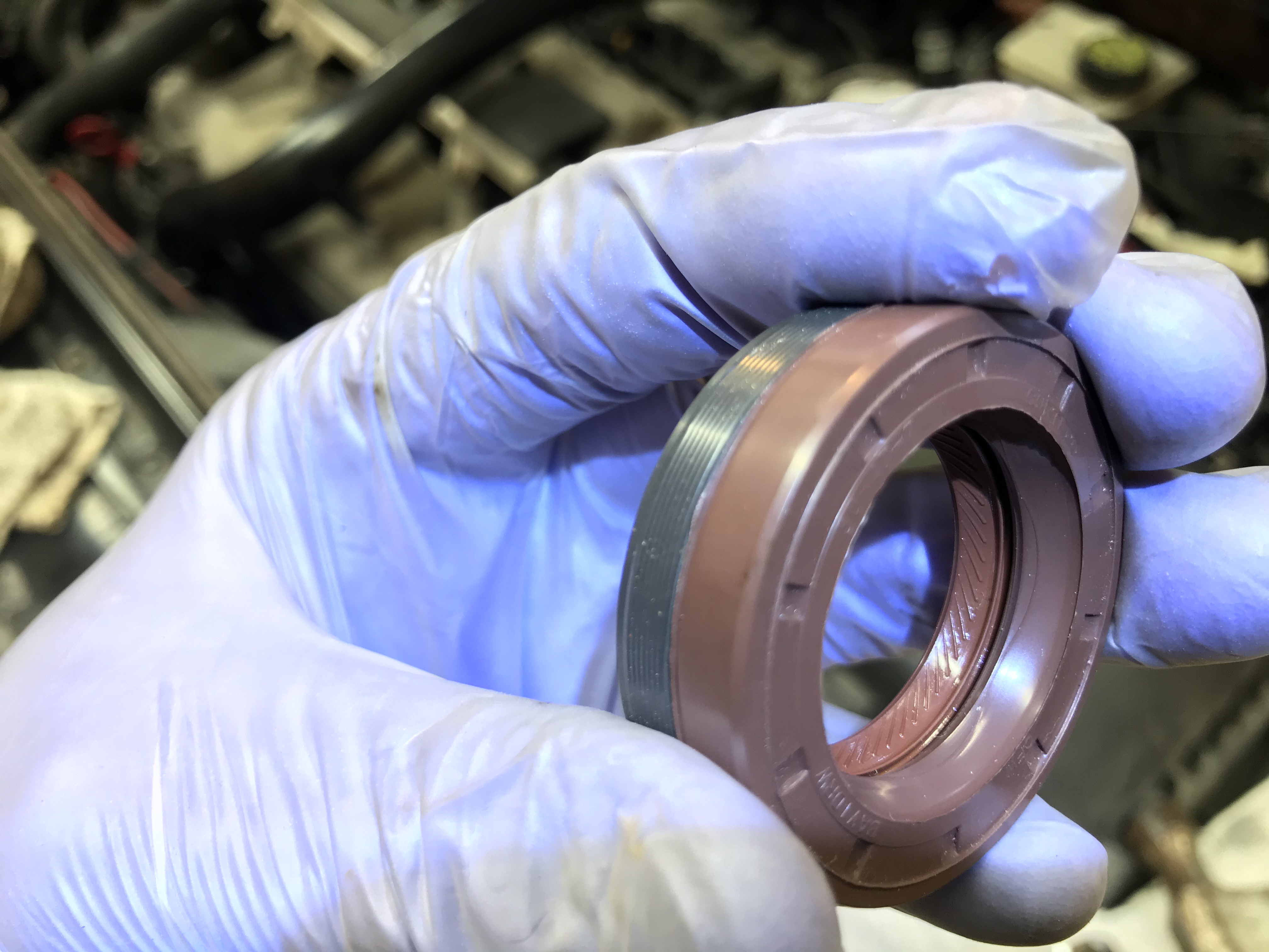

Corteco rear cam seal
ID - 28.95-29.00mm
OD - 47.18mm
Thickness - 7.01mm
Anatomy: smooth outer sealing surface, “wave” on ID. NOT the same as the seal that came out of head.

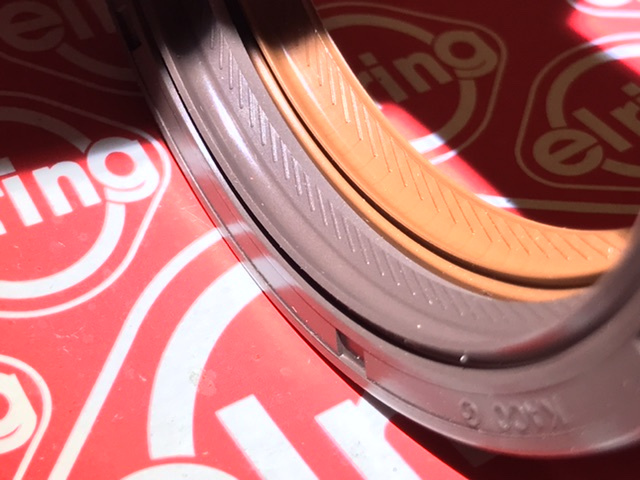

Elring rear cam seal
(^^^link wasn't working when I posted this)
ID - 28.67mm
OD - 47.27mm
Thickness - 6.84mm
Anatomy: First off, these are NOT as pictured on FCP's site. They are exactly as I have shown in pictures, which to me is just fine as it looks identical to what came out of the head. “Ribbed” outer sealing surface, angular ribs on the ID that direct oil back into the head. Elring seal is identical to seal that came out of head. I believe the cam seals were replaced once around 120k on this engine, so I do not know if they used Volvo or Elring seals at that time.
Based on the measurements, the overall design & construction, and the fact that identical seals were there previously, I would have to say that Elring seals are superior over Corteco on the rear of the cams. I’m sure both are fine though. I used one of each, to see which gives up an oil leak first. I ordered both Corteco & Elring seals for the front of the head also but ignorantly didn’t compare the two or take measurements so I will update this when I have specs for both (updated). The reason I neglected to compare the two for the front cam seals is everything I’ve read on the forums said, unanimously, to use Corteco as the Elring seals have been shown to run small or leak early etc, something along those lines.

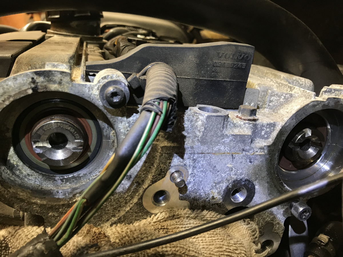

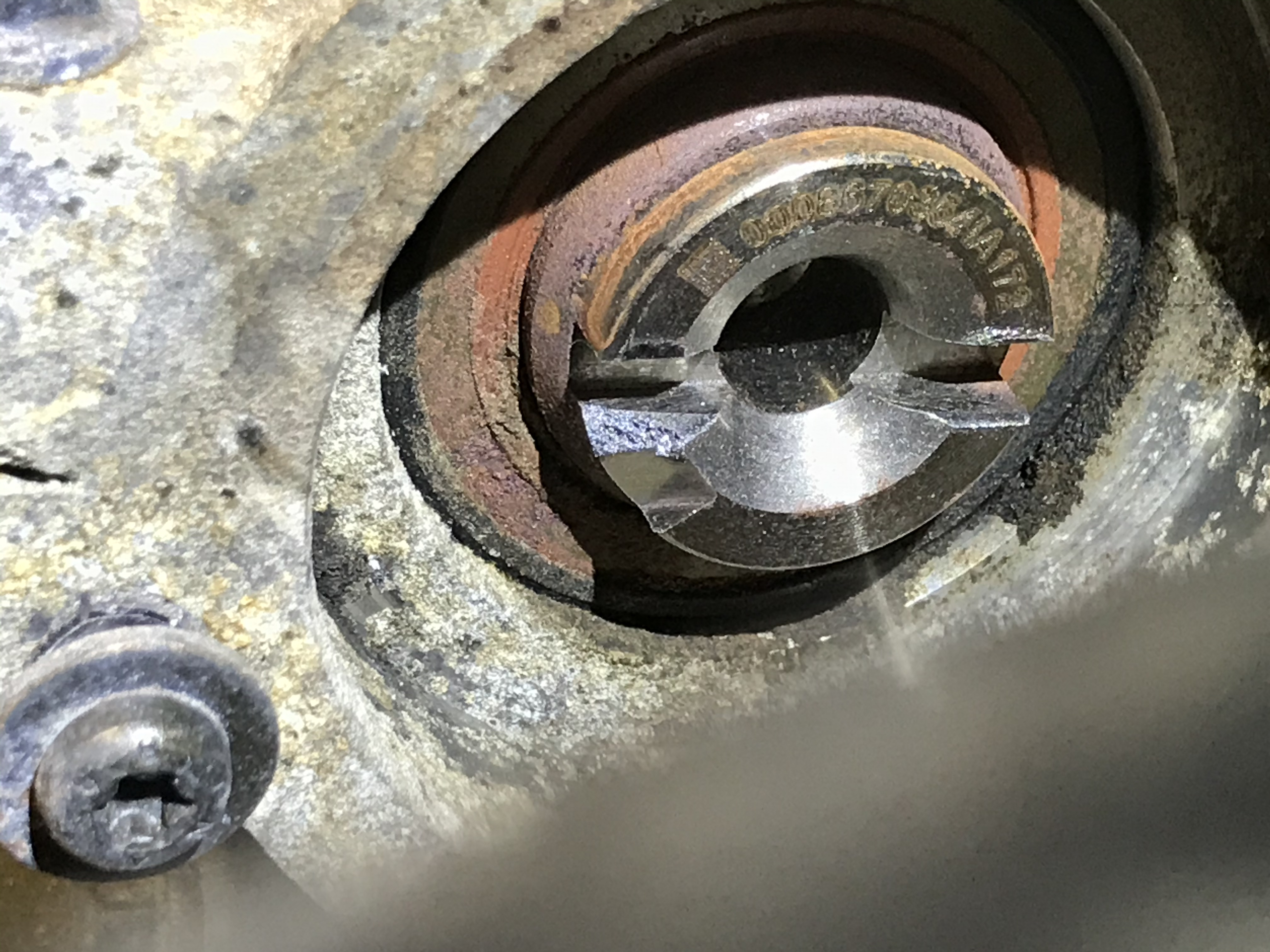

Take care with your rear cam ends where the cam locking tool goes. Measure the nubs that go into the cam slots & profile them down if necessary. My intake cam cracked simply with having the cam locking tool installed. Also noteworthy - both cam slots were left bruised from the cam locking tool.
Overall I was actually impressed with how relatively easy the entire task of replacing VVT hubs, cam/crank seals etc was. It’s really no different than retiming one of these if your timing is off, or even just doing a timing belt et.al. It’s far more daunting to just continue reading and re-reading about people’s horror stories & all the confusing steps Volvo has. Getting over the cost of the hubs was the hardest thing for me. The labor was enjoyable, but time consuming.

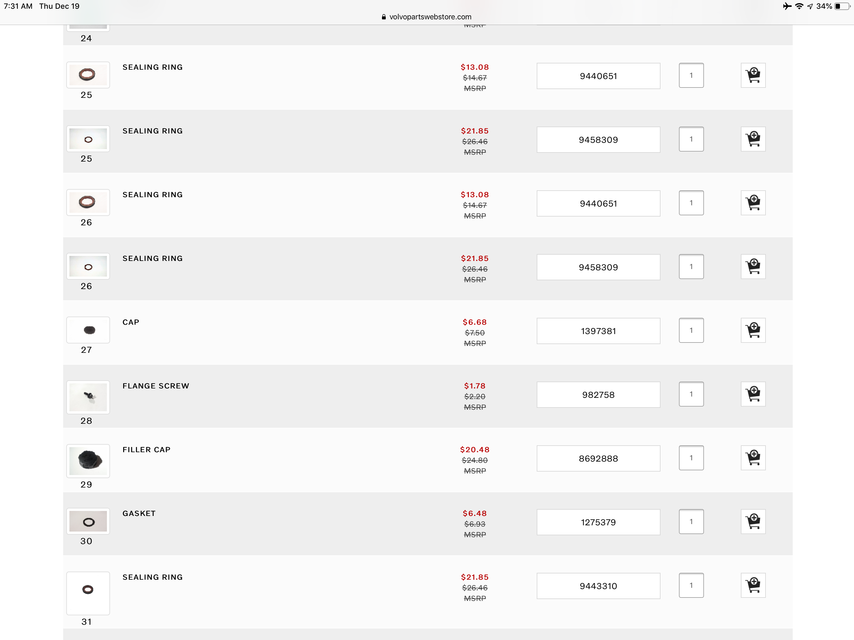

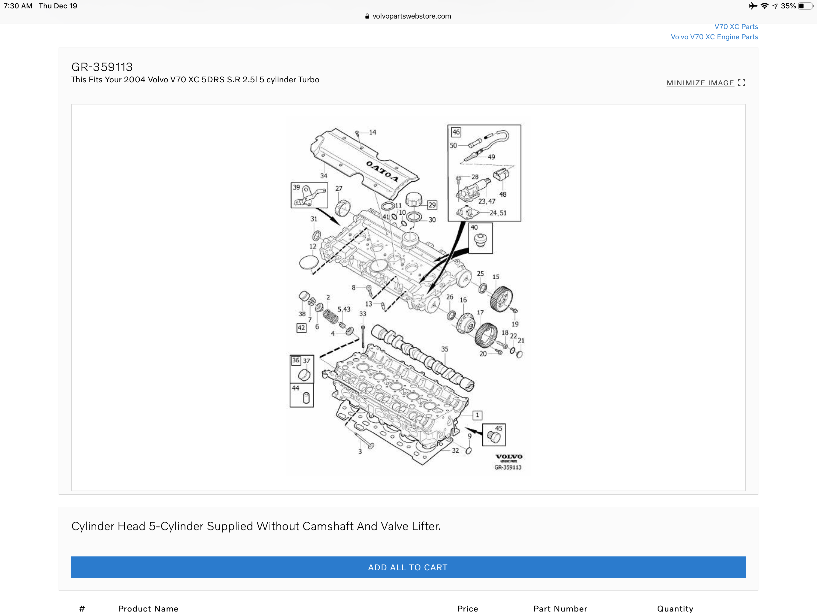

Hmmm. Volvo by store not showing the intake rear cam seal?
Also, is there a part number for the VVT hub oring or is that not available separately?

I actually never even considered using Volvo branded parts as they are typically manufactured by subs & are extravagantly more expensive. Both rear cam seals are the same. Part # 9443310 I believe.
No, there is no part number for the inner o-ring, not from the many hours I've spent searching. The only part number I found is for the entire VVT hub which contains the new o-ring. These are the same you will find on eBay. I have another message in to the seller I purchased from. Hopefully he will provide me the size as requested for the second time. I also asked that he ship me the correctly sized 0-rings once he gets them in from the manufacturer.
