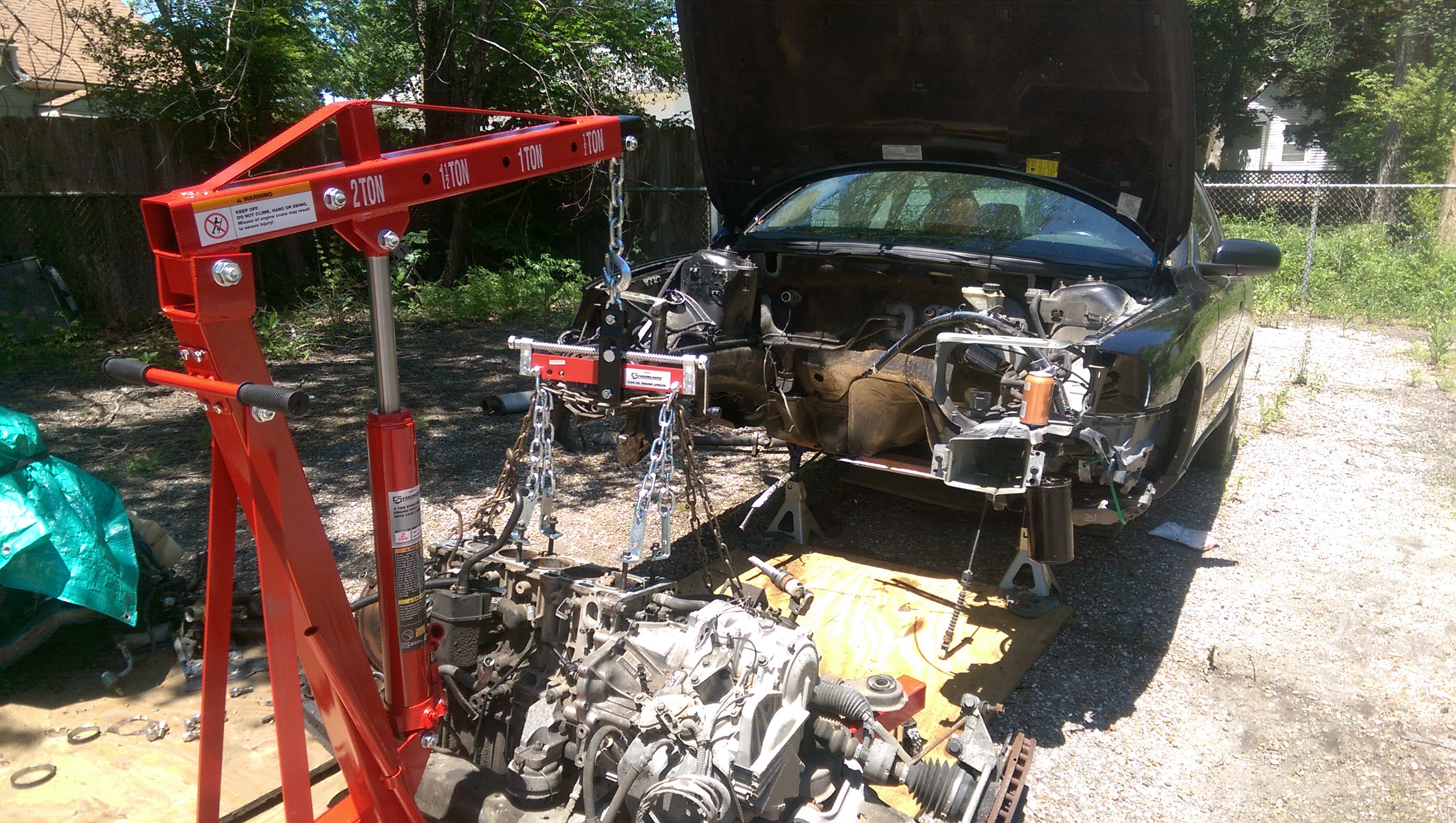

bronco wrote: 07 Jun 2020, 14:58 We want to support the engine and trans from above at about the height it normally sits and lower mainly the drivers side of the subframe ?
My jack stands obviously can't stay where they are or I won't be able to undo the subframe.
As for VIDA down load and install: Go here and read pages at least pages 1, 6 & 16.
Sound like you're a good candidate for my method. If you take the headlights, grille, heat exchanges and the front bumper (Metal bumper not just the bumper cover). The front will be wide open then you can drop engine, transmission and subframe with a Cherry picker or gentry about 4 inches, then pull the whole nine yards all straight forward to get it all out. You will also be able to see and most of the wiring from the front. Don't forget the wiring to the rack and pinion.
Pulled the whole nine yards out of this S60R with the Cherry picker.
Did the same on two XC90 using the same basic method.
In the case of the S60R. I dropped it all down onto the legs of the Cherry picker then use the Cherry Picker as a dolly. On the XC90s I was using wheeled gentry. Rolled it all out and loaded it onto a four wheel cart.
To get it off the Cherry Picker you place three Jack stands between the legs. Lower assembly onto jack stands. Pull Cherry picker out from under.
