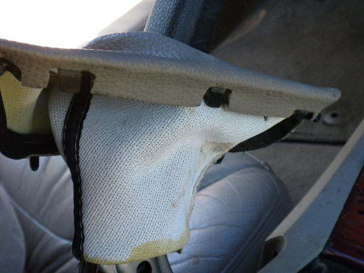

The boot comes out if the hard plastic and reveals the adjusters there.

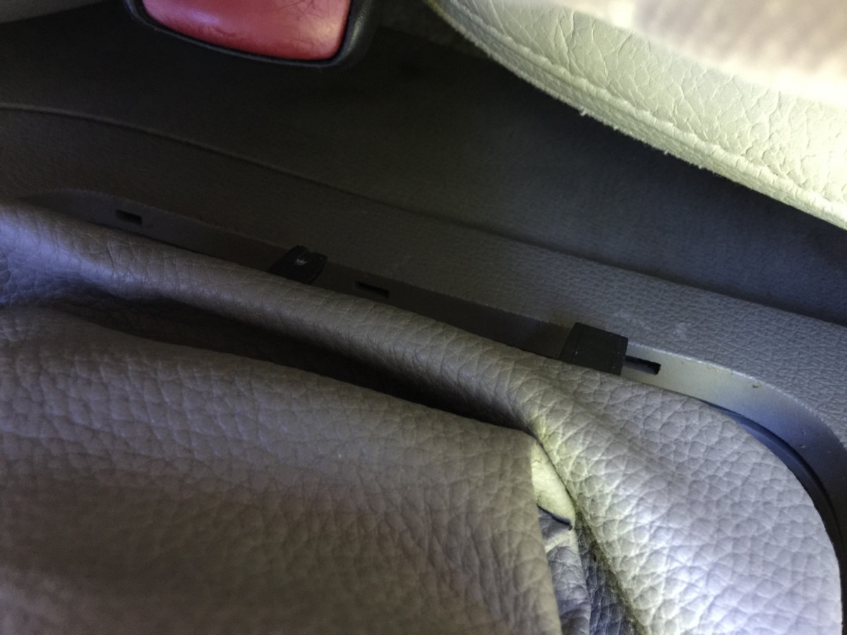

Just lift it up gently. I has several small pins at the bottom which easily break, so when placing it back keep a close eye at the bottom while pushing it down, so all pins engage properly - not a big deal if 1-2 break but still

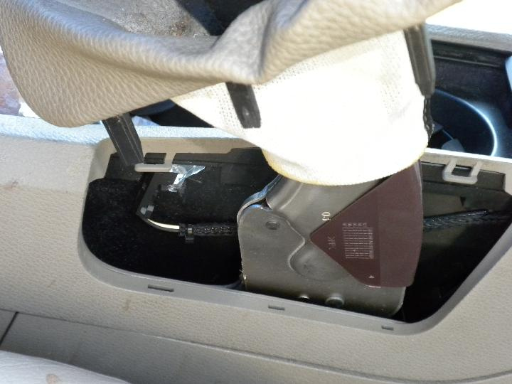

Tut lifts straight up with finger pressure. Plastic fingers go into slots

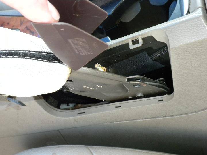

After that, lift the brown plastic cover to see the screw

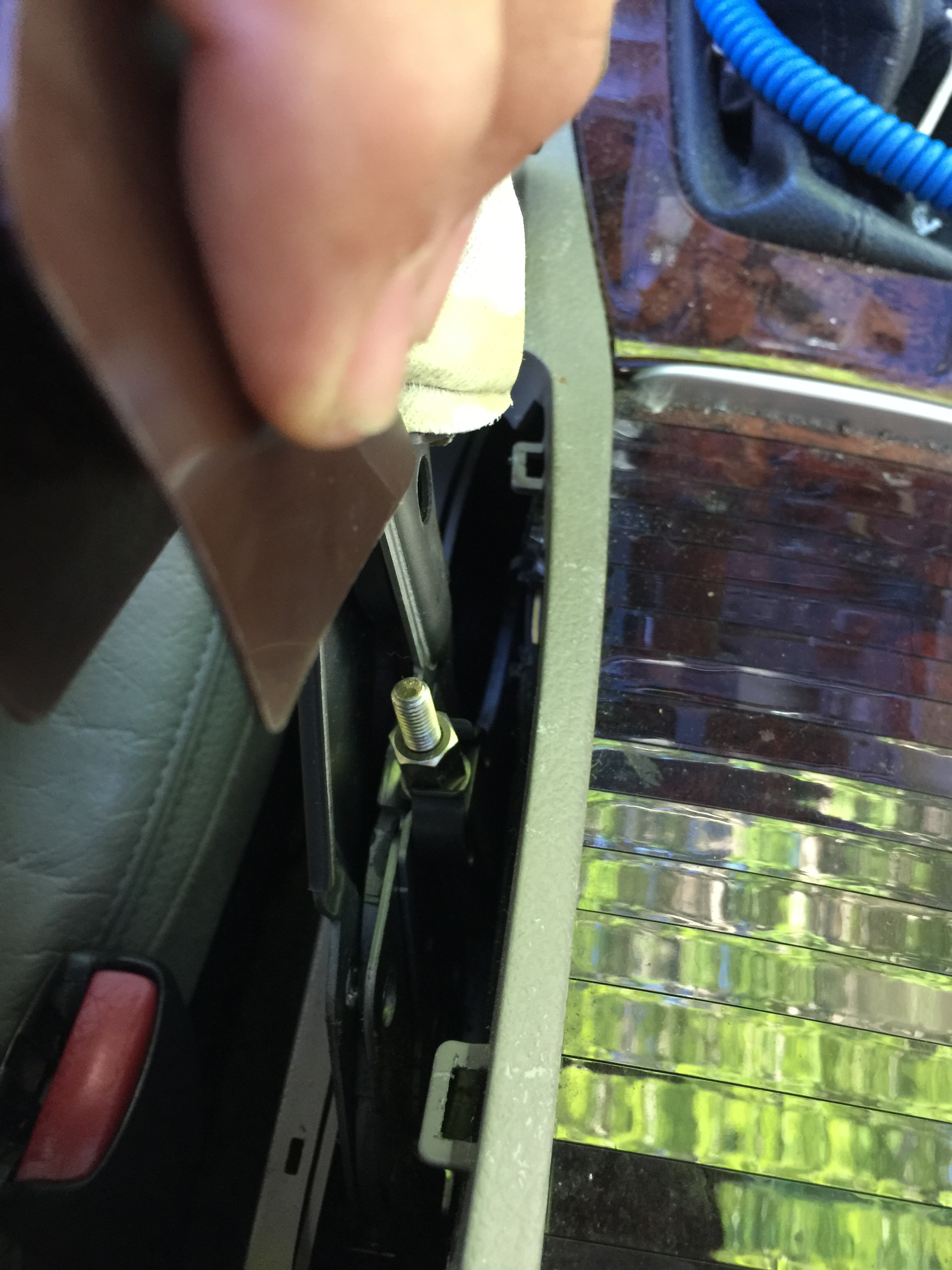

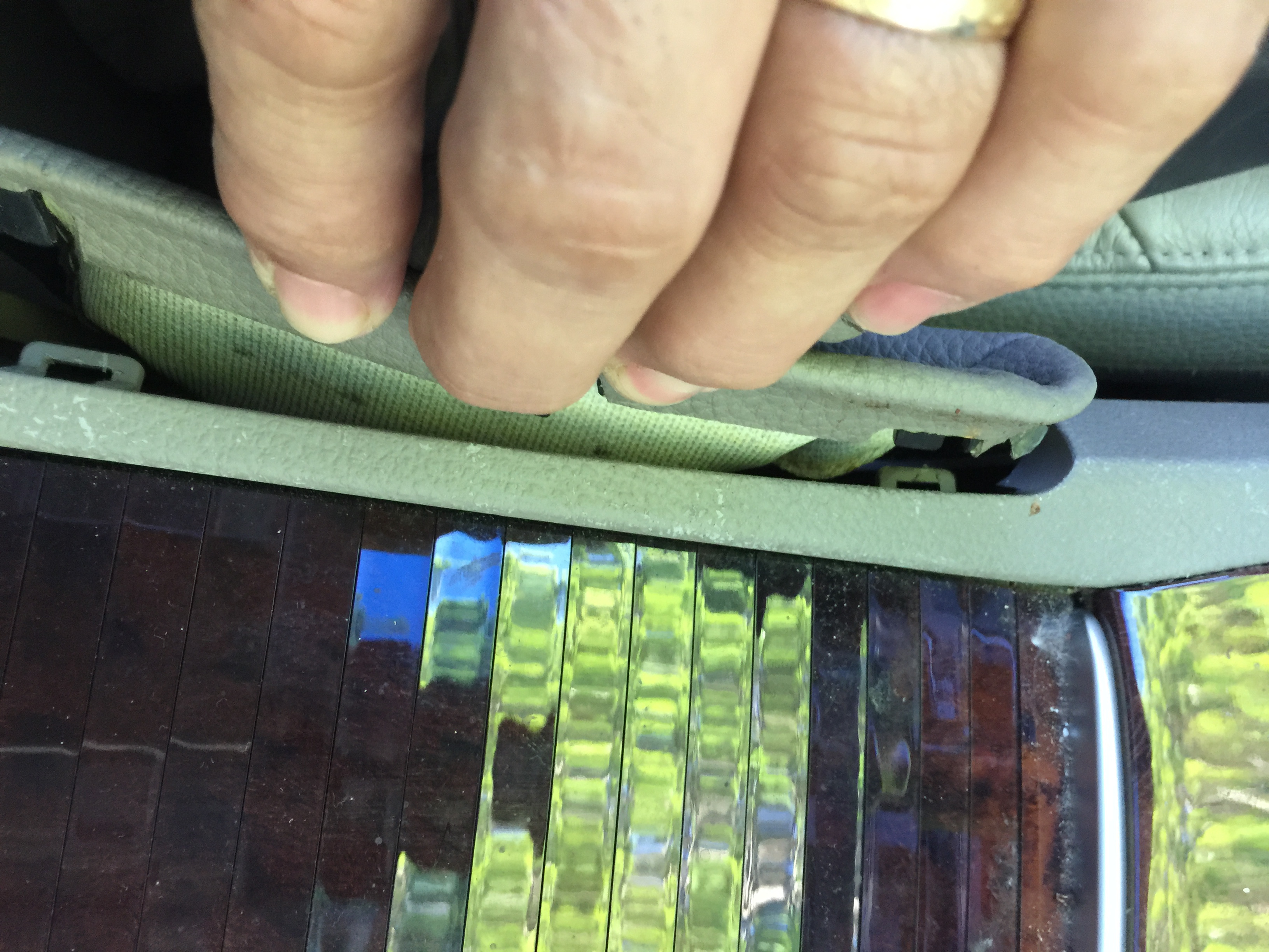

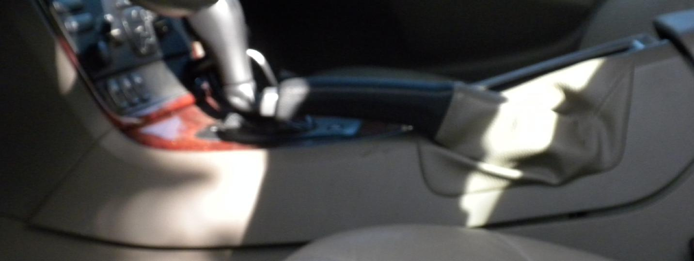

I am astonished at how easy it was once I knew where the boot separates. Never would have guessed. I just pulled up on the perimeter of the leather boot at each of the five slot locations.
Here are some additional pictures I took - same setup as abscate's.
View from left:
View from right:
Stealthy adjuster hiding under plastic cover that flips up:
