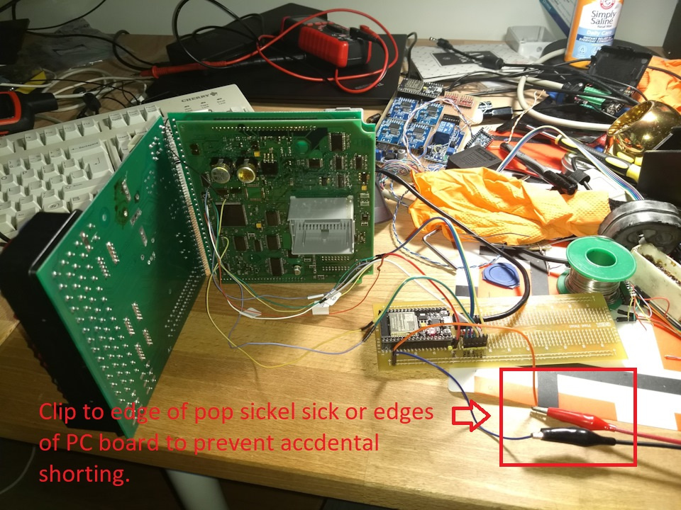

vtl wrote: 24 Jun 2020, 21:27 As I said before, you can't do the first line without knowing PIN up front. At least, as per Renesas.
You need to hard wire the programmer to the PC board. Read this. Your not after a chip pin. You are after a board pin or software key.
Note the third line in the comment section of the programmer software.

In the video they read unsecured/unlocked flash. To read the locked flash you need to know ID.
That programmer costs arm and a leg. My setup is $0 investment (everything was taken from parts bin) :)
