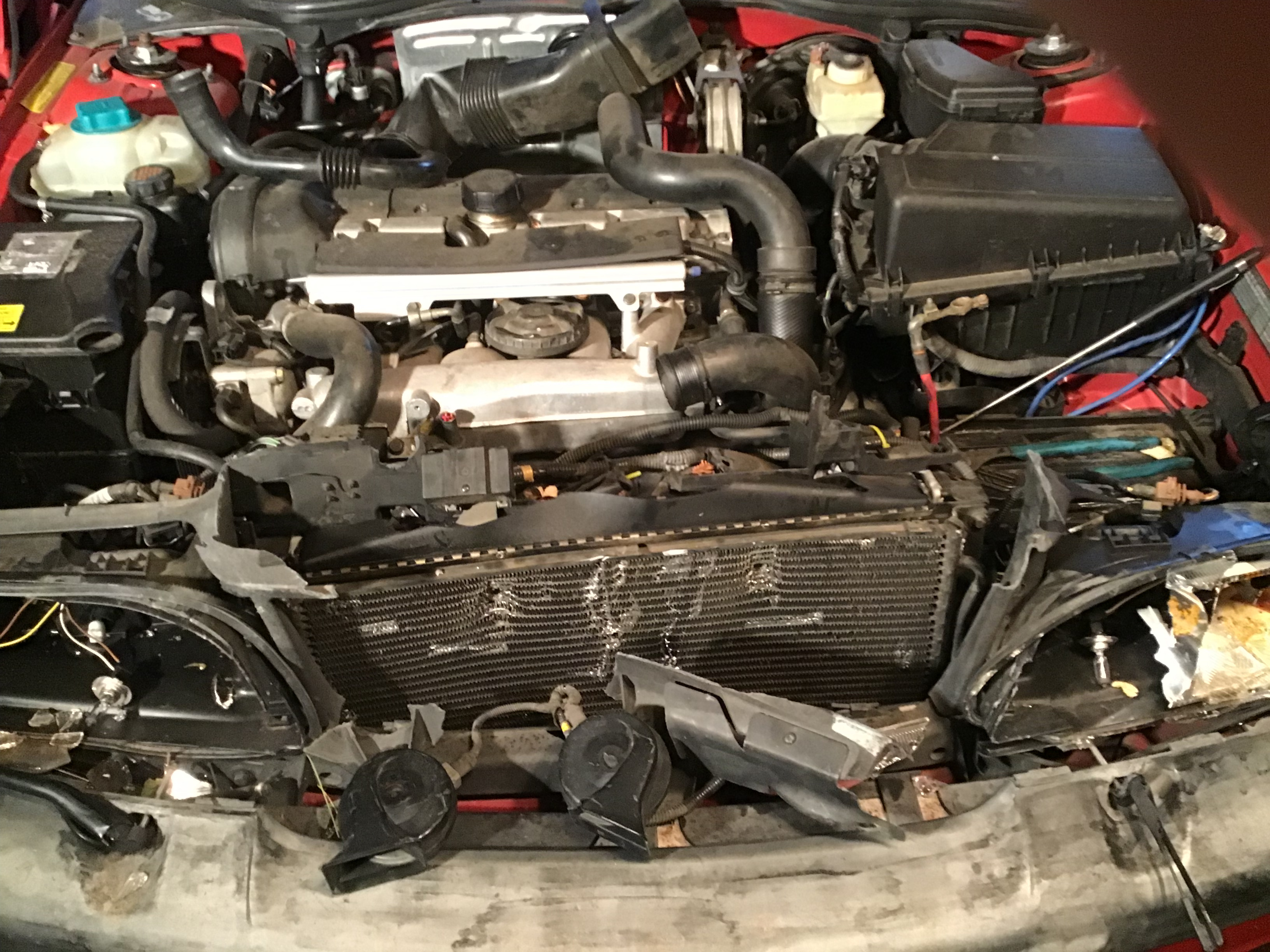

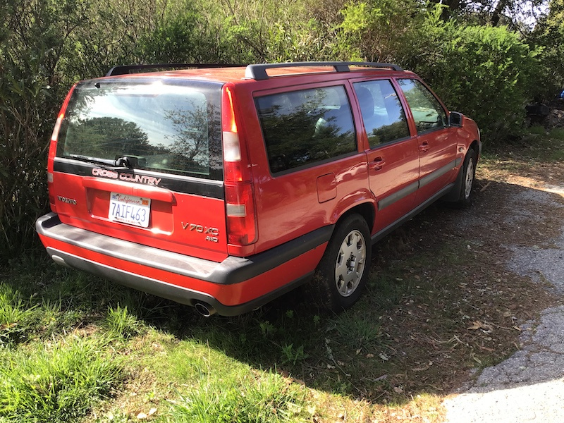

I rear ended a vehicle with a bumper higher than my 2000 V70 XC bumper so it was not affected. That caved in front buckling the hood, pushing back the intercooler , radiator and AC condenser, crunching both headlights and turn signals, dog earing both from fender tips and obliterating the radiator support.
Looks to me if I find a parts car that someone decides is not repairable I'll have everything I need to resurrect this sweet Signal Rod (that is what Volvo names that deep red color) wagon.
I put lots of energy into finding installing a used engine, it runs great, it had 70,000 miles only at the time. So I guess I must need another project plus I need an automatic trans car for the day in the future I need a total left knee replacement, will not be able to drive manual trans car for a while.
The posts you two put up are like manna from God.
As seasoned Volvo guys do you have comments about this aside from "find a good psychiatrist".
Will any 98, 99 or 2000 S70 with Vin56 engine have the needed hood, intercooler, A/c condenser , headlights and turn signals and radiator support, ie same parts as this V70 Vin 56??
I've got a new radiator already, some good paint PPG deltron , hood hinges are fine. Engine still rotates free and easy.
The engine did not take a direct hit. It rotates freely but only clicks does not turn over by the starter.
Thanks for your great work

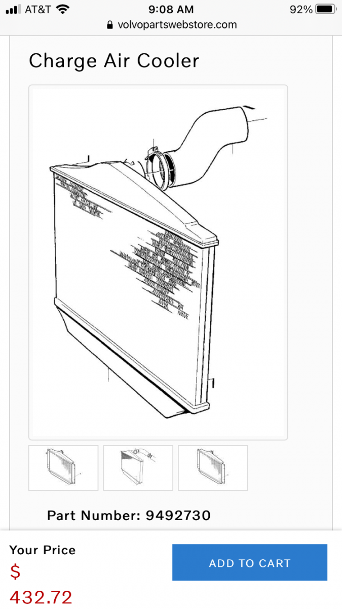

9492730 Intercooler is the only one I am unsure if. All other parts are the same.
FCP fitment chart is good, Volvo parts web store is definitive
If the intercooler works in both XC70 and T5 the LPT and HPT intercooler a are the same, sure looks that way here.
https://www.volvopartswebstore.com/prod ... 92730.html
