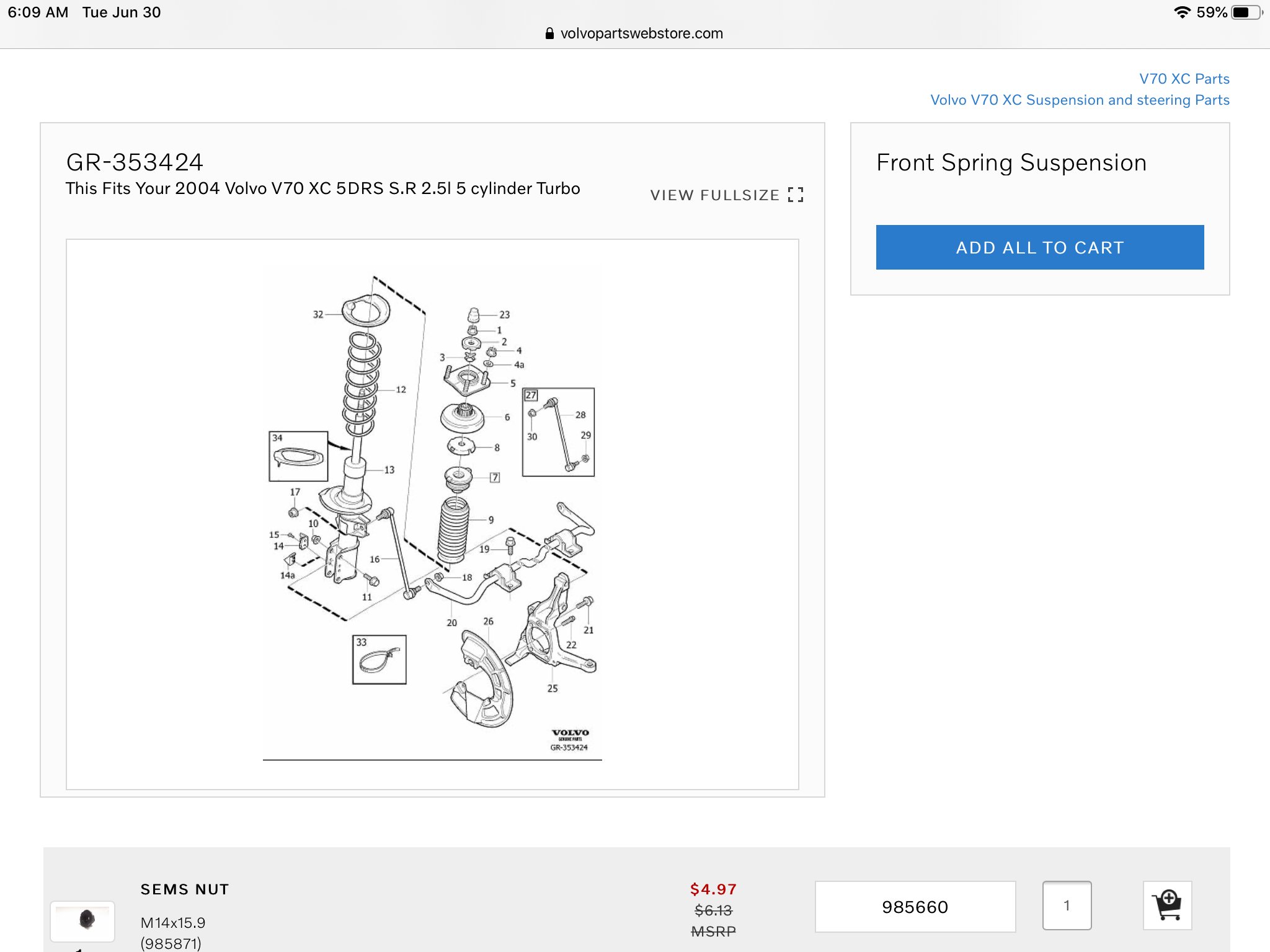

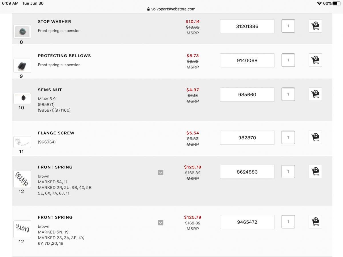

I completed the job this weekend. I snapped one of the lower strut bolts, and realized that in the instructions you SHOULD use new bolts anyways. So if you're in Canada and, like me, there's no Volvo dealership for 300km: call up your local Carquest with P/N Y2001849336MTC for a $6 replacement bolt.

Thanks for the part number reference asan alternative to the Volvo part numbersbr0dy519 wrote: ↑29 Jun 2020, 06:41 I completed the job this weekend. I snapped one of the lower strut bolts, and realized that in the instructions you SHOULD use new bolts anyways. So if you're in Canada and, like me, there's no Volvo dealership for 300km: call up your local Carquest with P/N Y2001849336MTC for a $6 replacement bolt.
